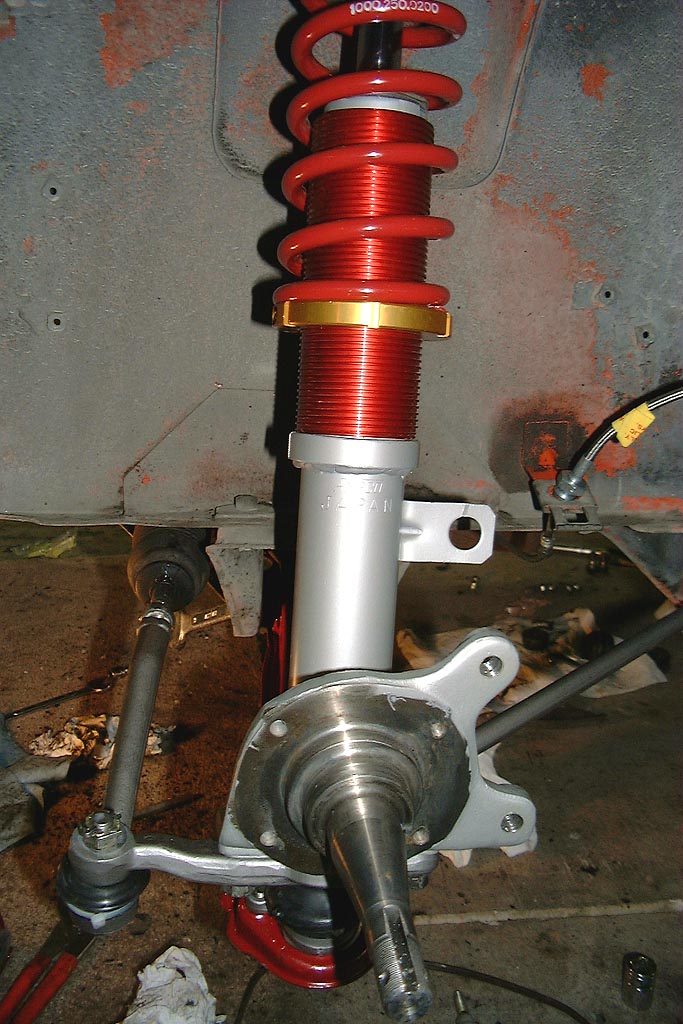

In each GC tube you should've gotten a little rubber ring. That ring goes around the strut housing, and the sleeve goes over it. This creates a tight seal preventing the sleeve from rotating. Otherwise it just sits right on top of the perch, supported by the weight of the car. Here's my setup for reference
I didn't get a rubber ring with my kit. I got the metal perch that needs to be welded to the strut housing(4), the threaded sleeves with adj. nuts, springs, and aluminum top pieces. I think I'll call GC again and ask them if I'm missing pieces. :idea: Thanks for the help. That picture helps alot!
