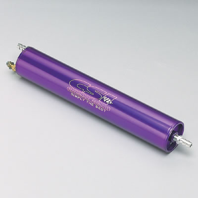

Tim, I've been putting off getting an overflow bottle for a while now... I know I want to put one on there. I'm running the ZX radiator so it has the little outlet of the filler neck for it. But I get the idea that a regular overflow bottle is not what you're talking about? How do you set up a recirculating catch tank?
You just need to find a catch tank that has the outlet from the radiator neck to go to the bottom of the catch tank....that way when the car is hot and it spews out some coolant, it will go into the tank, then it can suck water back instead of air. I am using this one on my V8 Z:

Yeah I remember seeing that thing in your engine bay, actually thought it was for fuel. Okay, so one of the ports on that thing connect to the small port on the side of the filler neck, where do the other two connect to?
