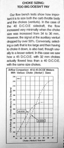

Based on the chart below, it seems 32, 34 or 36 would have a small influence on air flow (so performance). It's good to believe it still makes a difference to move from 34 to 36.
