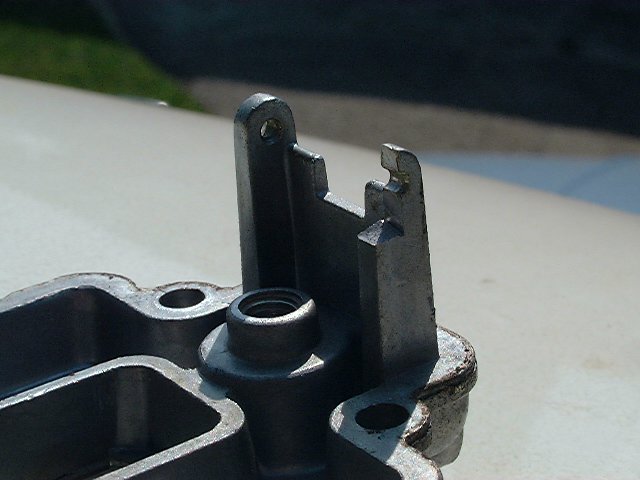

Aside from having a MAJOR problem with my Float pivot pin arm breaking off, today was a step in the right direction.  When I initially starting rebuilding my carbs, one of the float pivot pin support arms broke off.  I was naive to think JB weld could fix it, but after taking the cover off this afternoon to install "0" pump jet exhaust/spill valves, I saw that the JB weld was peeling off and was ready to fail any day.  It now looks like this (not my pic but you get the idea):
That was a major downer, especially since I just made all the jetting changes I wanted to try.  Here's what I changed today in bold:

I quietly cried to myself about the float pivot arm for a while, went back down to the garage and said F**K it and took her out anyways (minus 1 full pivot arm).

Steve, you can buy a replacement top from piercemanifolds, but its for either a 151 or 152 with platstic floats.  Part number 31734.198, $98.00.  Interesting enough Pierce lists the same carb top part number for both the 40 151 and the 45 152...I would call pierce to just to verify what you are getting before you were to order.  I cant recall if you ever listed your 40 DCOE model. I have a 40 dcoe 2, so I'm looking for anything that originally used brass floats. Most tops should be interchangeable, but it would be great if I could find a used 40 dcoe 2 for cheap so everything could match.
I actually "fixed" the issue today by using a nail instead of the pivot pin. I cut and filed a nail down to replace the pivot pin, and made it like an interference fit that went into the remaining good float arm pin hole. The other end where the split arm broke off is where the nail head is. It's actually a very tight clearance between where the stock pivot pin sits within the carb body, so if my "new" pin were to move the nail head would help limit movement by pressing itself against the carb body.  The float rotates smoothly along the pin/nail and feels secure so I'm happy for now.  Took her out for a long spirited drive and everything felt normal.   I need to run to the hardware store to pick up a brass nail and redo it though.  Just used a regular nail for my very professional R/D.   The pivot pin doesn't see any real load (just vibration), so I'm hoping it will be ok while I continue to hunt for a top.

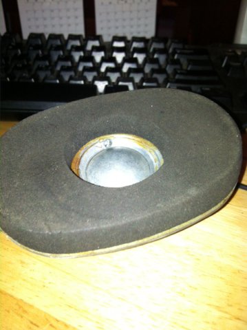

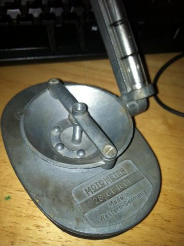

Btw, how the hell do I use this?
Am I suppose to open up the diaphragm to allow more air through?
Obviously, if I place it over the air horn the motor dies...The only air traveling through
is from the tiny hole.
Thanks

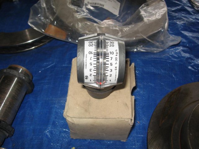

Steve, buy a real flowmeter, the Unisyn is junk (as you can see). I gave my last one away. Get an STE SK syncrometer and it will make your life a lot easier.

So its been about of week of tearing up the roads out here, and decided to go through everything just to make sure everything looked ok. Turns out, Im having some weird sync issues with the SK snail gauge. Carbs 1-4 is right at 5 on the gauge. Cylinders 5 and 6 are at 10. What would cause it to be a 10 on the snail gauge? I dont think a vacuum leak because that would make the reading less rather than more. ?
Anyone have some ideas on what I should check? Yes the bleed screws are turned all the way in.

They move all the time.
Reset linkage to even all out. This is a very regular check and adjustment.
It is imperative that the throttle pedal meet a firm STEEL stop in the floor before the linkage maxes out under the hood.
Also that big spring could be bending stuff.
