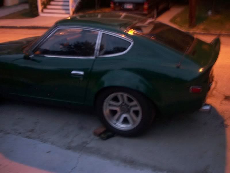

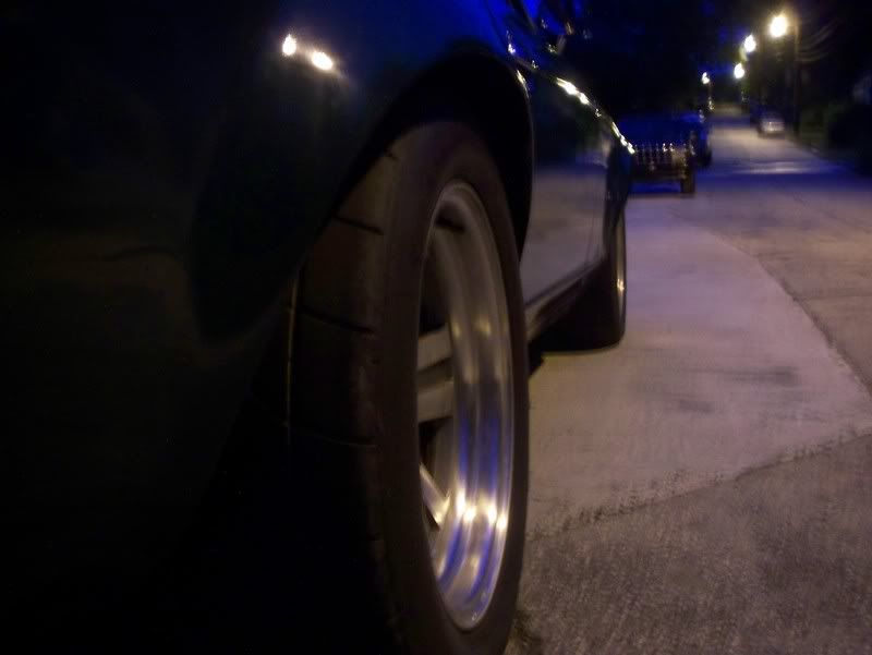

OvErMiNd Posted June 24, 2007 Share Posted June 24, 2007 I have conquest/starion wheels on my Z, but I bought it that way. The front hubs are supposed to be from the conquest and the rear from a 300zx. I currently have crystalized brake pads up front and the conquest pads I've bought do NOT work. idk what to do!!!! = / But anyway, they looks good I think. I have fiberglass flares on my z, but they're just for looks. The stock fenders were not cut to fit them on. I'm running 245 nitto extreme drags on the back too. Quote Link to comment Share on other sites More sharing options...

OvErMiNd Posted June 26, 2007 Share Posted June 26, 2007 o offset. I thought they were 7'' front and 8'' in the back. I can find out for sure today when I see my Z. Quote Link to comment Share on other sites More sharing options...
