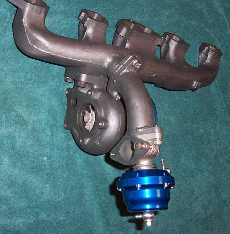

Guest De Schmaydee Posted September 25, 2004 Share Posted September 25, 2004 dunno, i did mine like this.... .......s Quote Link to comment Share on other sites More sharing options...
auxilary Posted September 25, 2004 Author Share Posted September 25, 2004 yeah, but my turbo is on the OTHER side of hte motor and not enough clearance Quote Link to comment Share on other sites More sharing options...

auxilary Posted September 26, 2004 Author Share Posted September 26, 2004 Ideally, this is what I'd want to do. However, I have 1/8th of the clearance he has That is the best design for an external wastegate that I've seen. Straight off the turbo, angle of the wastegate runner is direct flow of exhaust gas. He'll never have boost creep problems as well as surges. Quote Link to comment Share on other sites More sharing options...
