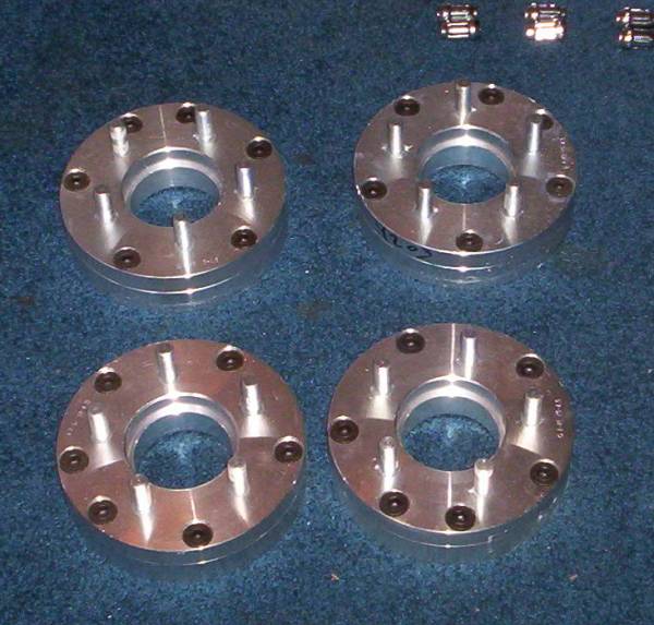

BleachZee Posted July 8, 2006 Author Share Posted July 8, 2006 My paint is long gone. The passenger fender and door were repainted by a body shop 2 months after I got the whole car painted at Macco. All the Macco paint has since faded and the two panels are still shiny. I'll be doing bodywork and paint soon on the whole car. I don't have pictures of the adaptors apart. You take these apart and bolt the back half to the four lugs on the car. Then the outter section has 6 allen head bolts to hold it together and the 5 lugs come out of the outter half. The one thing they didnt' tell me is that your 5 lugs in the adaptor will not be 12x1.25 like your factory lugs are. They sent me those generic locking lug nuts and I can't use my good set that I had on before... Quote Link to comment Share on other sites More sharing options...
Cody 82 ZXT Posted July 8, 2006 Share Posted July 8, 2006 Thanks for the picture. I understand about Maaco paint. My Z right now has red that looks about like your purple. Seems like you get about 2 years of good shinny paint then it starts to fade. Quote Link to comment Share on other sites More sharing options...
