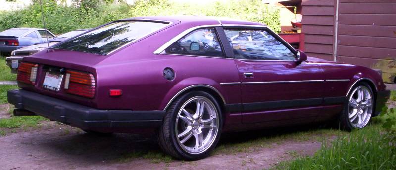

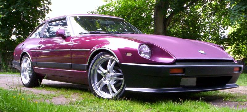

Ok, so later on I changed my mind again and just went with 4 > 5 lug adaptors. They work great so far and I have my 5-lug 18" wheels I wanted. I sold the 16x9 / 16x10 racing wheels.
45mm adaptor thickness
wheels are 18x8 +38
tires are 225/40/18
every now and then one of the front tires rubs just a little while turning hard; usually moving slow in a parking lot and hitting a speed bump. The rear has lots of room inside and out. The car is lowered 1.5" front and 1" rear with ST springs.
