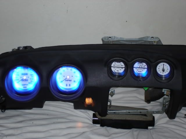

AK-Z Posted November 18, 2005 Share Posted November 18, 2005 beatcha to it. I kinda hard wired them in. Quote Link to comment Share on other sites More sharing options...

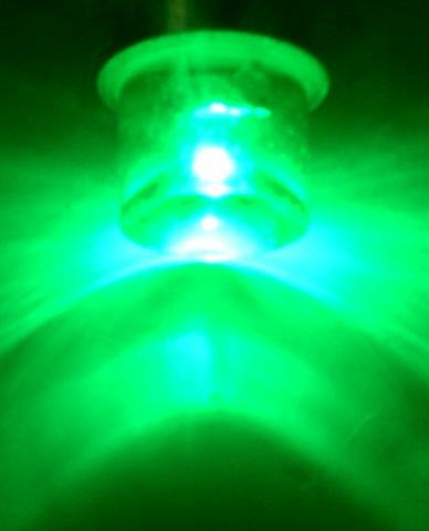

Metallicar Posted December 5, 2005 Share Posted December 5, 2005 I finally had a chance to install the new Led bulbs. I am disappointed. Maybe my own fault, climbing a learning curve. First, I installed a led Festoon bulb for the dome light. The bulb I ordered is 1 -3/8†long and has four (4) leds in it. The light certainly was white. Because the leds are small, inside the festoon, once inside the dome lamp lens, the light was diminished to just a single spot on the lens. Perhaps I should have considered trying to install one of the 1- ¼†9 led units @ $8.99. I then installed new green led bulbs in the three small gauges. First I merely remove the old bulbs and installed the new ones. Yes, because I was hoping for a stock look, I choose green bulbs. The gauges certainly looked green! A nice green, but very dim. The bulbs, I used here are the BA9s Inverted Lens. I then removed the gauges, disassembled each one, and removed the green lamp diffuser in each gauge and reinstalled. Of course, in my haste as I pried the little green things out of each gauge, I broke off the little buttons located on the wings that retain the lens, making re-installment nearly impossible. Once the bulbs are installed without the green filters, they did brighten up to be about equal in light emission as the yet untouched speedo and tach lamps, just greener. One highlight, the ashtray light now has a White BA9 Focused Lens. The blue diffuser creates a very nice glow. Since I stopped smoking weed, the lid stays closed, now that I keep loose change in there. It seems pointless for me to insert a picture of this, now. Once I find the right bulb selection, I will. Maybe I should try one of the 4 led cluster 1895 BA9 bulbs, which are focused or maybe a frosted BA9. Perhaps after I overspend my budget on these relatively pricey led lamps, I will be back to cheap colored bulbs. Quote Link to comment Share on other sites More sharing options...

Metallicar Posted December 5, 2005 Share Posted December 5, 2005 In my dome lamp assembly, the light diffuser/switch pops out of the roof trim. The trim cavity has no reflective element at all. Perhaps I should try applying some foil tape in there..... On second thought, the wire terminals are naked and perhaps too close for comfort. I could inadvertently short something out. But this is just a thought. I will investigate this tomorrow. Of course the wimpy bulb I bought with 4 leds instead of the nine leds is a waste. I need to edjumacate myself before I order more of these bulbs. I really would like to see some light like AK-Z has! As I said earlier, I am trying to keep a stock look, so I am keeping the black gauge faces. I would love to see green lighting. If I took a picture of my dash in the daytime, you would never see any lighting, unlike AK-Z's picture. I just got home from work, it is now dark here at about 5:00pm. My gauge lights hurt my eyes they are so dull, could be tears though, damn lights, why do they suck so much? Quote Link to comment Share on other sites More sharing options...

Metallicar Posted December 6, 2005 Share Posted December 6, 2005 I am not giving up, yet. I am going to try these, Instead of these, Perhaps the multi led buld will scatter enough light to do the trick. The multi led bulb is $6.99 vs. the inverted $2.99. Though I am thinking of just adding additional bulbs to each gauge. Adding addtional holes in each gauge should not be too bad of a job. I would splice in addtional bulb socket/ pigtails at one point in the stock wire harness. Maybe use bullet connectors and connect them with bullet multiplier connector so I don't actually pierce the factory wiring. Since the led lights are smaller and cooler in temp, it may work just as well. Quote Link to comment Share on other sites More sharing options...

v8260 Posted March 8, 2006 Share Posted March 8, 2006 http://i4.photobucket.com/albums/y112/ak-z/DSC01426.jpg[/img']beatcha to it. I kinda hard wired them in. did u convert to led to get them like that or did u just change the bulbs? Quote Link to comment Share on other sites More sharing options...
AK-Z Posted March 8, 2006 Share Posted March 8, 2006 I hard wired them "into the gauges" in combinations of series and parallel circuits. For the speedo and tach I used 6 LEDs and on the other 3 I used 4. They are so bright people can see them driving behind me. I am currently making another set of different style, I'm not going to discribe anything yet, its going to be a surprise. Quote Link to comment Share on other sites More sharing options...
