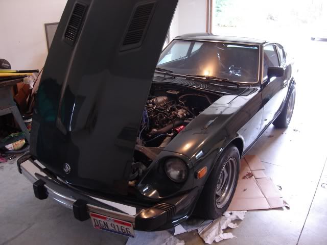

It's taken the better part of a year, but my ’77 280z turbo on the N/A project is finally at a stopping point.
Before I get into the details of the project, I have to thank the guys who helped me on it. One of my best friends and Hybridz's own TheSkrich was right there on the opposite side of the engine bay throughout this project, doing everything from wiring to breaking loose the infinite supply of rusted bolts, to providing the entertainment. Also, my dad was a big help, especially when those rusted bolts didn't come out so great and we needed precise drilling and tapping done. My parts supplier, Frankie from Z Performance Racing, provided hours of free phone support which helped immensely as he's done several similar setups. Thanks for everything guys!
I also have to give some background for why I did this project this way and why it took so long. First, I'm a poor college student living 2 hrs away from my tools, garage, etc., so I really have to make the most of what little time and money I can devote to the car. Secondly, my N/A motor runs great and only has 43,000 on it. Finally, the junkyards here in Ohio are few and far between and have almost no old Z's. This makes it basically impossible for me to find a good turbo motor, and even if I did, I would have to hang it from a tree limb to put it in the car because I don't have an engine hoist.

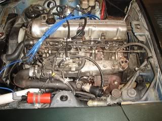

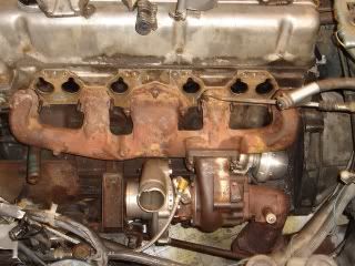

Exhaust: Garrett T3/T4 .63/.50 Turbo with stage 1 trimmed turbine wheel and water cooled bearings; Modified 280ZXT manifold; external wastegate with 1" stainless pipe going straight to the atmosphere; 2.5" straight-through exhaust piping with a performance glass pack inline with a Magnaflow muffler; '83 zxt downpipe
Intake: K&N universal 3"x10.5" filter; turbo afm with n/a guts; '83 zxt j-pipe; N47 manifold with egr and pcv recirc. removed; Eclipse BOV; pvc and household plumbing coupler intake at the moment; I have a huge aluminum bar and plate IC to be installed professionally, and when it goes in, real intake piping will go in with it.
Fuel Delivery: Walbro high pressure pump; BEGI FMU; under-hood fuel pressure gauge; all new soft fuel lines; '83 zxt injectors
Ignition: MSD Blaster 3 coil; NGK wires; stock dizzy, still using vacuum advance, but with a check valve installed so that it doesn't see boost.
Engine Management: I plan on catching a lot of crap for not using Megasquirt, but from everything I've read it's a project in itself and I don't have time for it. I run the stock '77 ecu with the tps unplugged so that its only input is from the afm. Under boost, fuel is added by the fmu. Simple but effective.

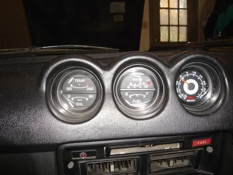

Boost Gauge: I realize this isn't really a category, but I have to show off the custom work I did here. I got a cheap eBay boost gauge and adapted its guts into my clock housing. After a couple hours of work and a little glass cutting this is what I came up with. Since it’s in the clock housing it fits perfectly in the dash and lights up using the stock green backlighting.
You're probably wondering how the car drives. I only got to drive it for a few short minutes before heading back to college last weekend, but the car felt awesome at 5 psi (I have an mbc to install and plan on running 10 psi after tuning with wideband). It also sounds excellent. Under normal conditions it's deathly quiet, which is how I like it, but under boost when the wastegate’s own exhaust is opened, it takes on a louder, deeper sound which complements the car's acceleration under boost nicely.
At 5 psi it doesn't need much over the stock 30psi. Its around 40-45, which is probably a little high, but I want to keep things safe until I can borrow a wideband and see where I'm at as fas as air/fuel ratios. As i mentioned above, I'm not running any stock pumps. I removed the stock pump and replaced it with the a Walbro 255 lph high pressure pump which can support over 100 psi. You can actually see it in the picture below my fuel system description. It's the silver canister wrapped in black foam on the wall of the engine bay. I didn't trust the stock pump for high pressures at all, and I saw that a lot of people on this site run the same Walbro pump and it works well for them.
As far as ignition timing retard, the timing is not very precisely controlled, but basically I have the timing set for it to run well under n/a manifold pressures, and some of that timing gets taken out when the car hits boost and closes off the check valve in the vacuum signal line to the dizzy.
