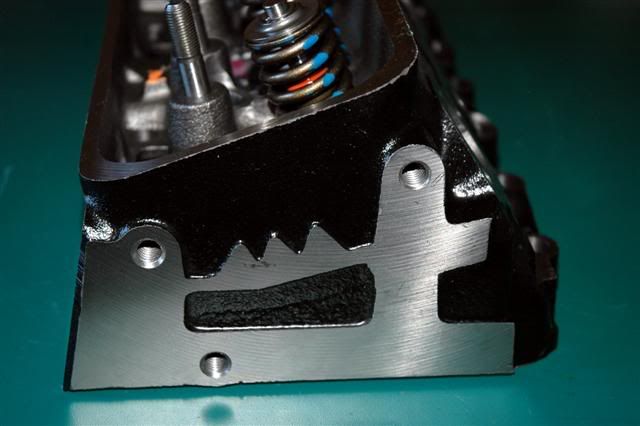

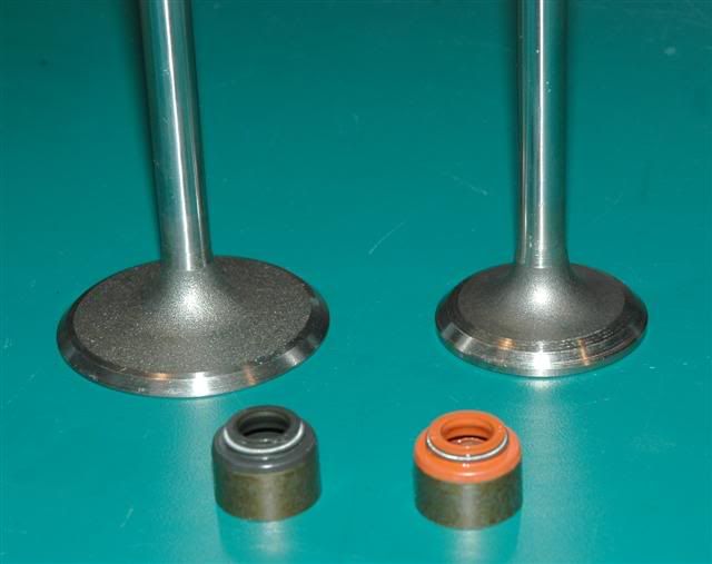

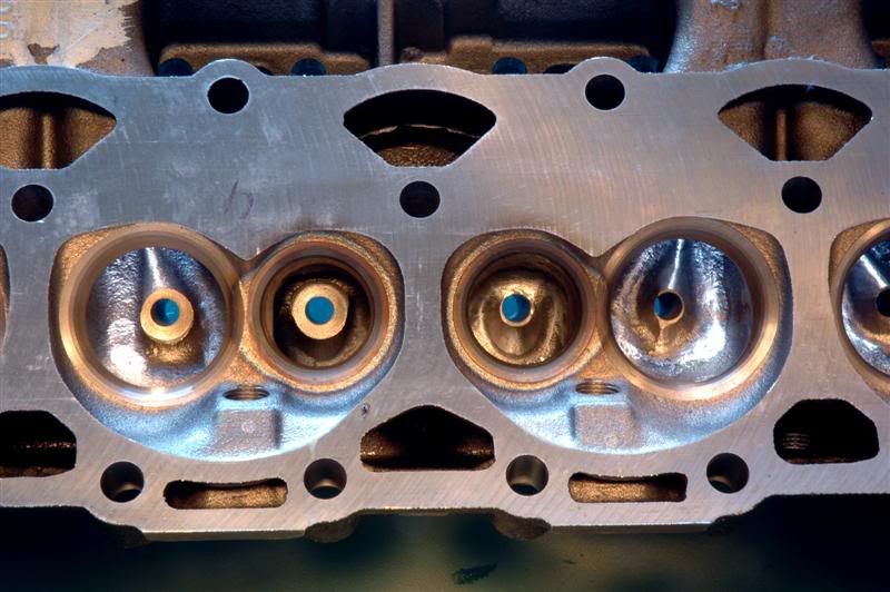

Administrators BRAAP Posted December 10, 2005 Administrators Share Posted December 10, 2005 Bang for the buck the Vortec CAN’T be beat!!! Port shape and size is excellent as cast to support in excess of a realistic 350-375 HP especially with the raised port floor and generous short side radius on the Intake. The chambers are, well, a work of art with the spark bolts closer to the center of the chamber, than any other SBC head I have seen. Below, this is the casting identification on the end of the Vortec heads. I just took these pics yesterday. I bought these for my father as he plans to use them on a very mild 383. He wanted me to massage them so I just performed a mild clean up in the bowls only. The chamber on the left is untouched as cast, the chamber on the right has the mild massaging done, below… Below, note that GM is shipping the new Vortec heads with high quality Viton Stem seals and also putting a 30 degree back cut on both the intake and exhaust valves. I perform a 30 degree back on the valves of EVERY cylinder head I do. GM saved me that step this time around FWIW, I also weighed the Vortec heads as a pair, fully assembled, without rockers, 90.4 lbs for the pair. I also weighed my Trick Flow Signature heads fully assembled without rockers, 58.6 lbs for the pair. Quote Link to comment Share on other sites More sharing options...
