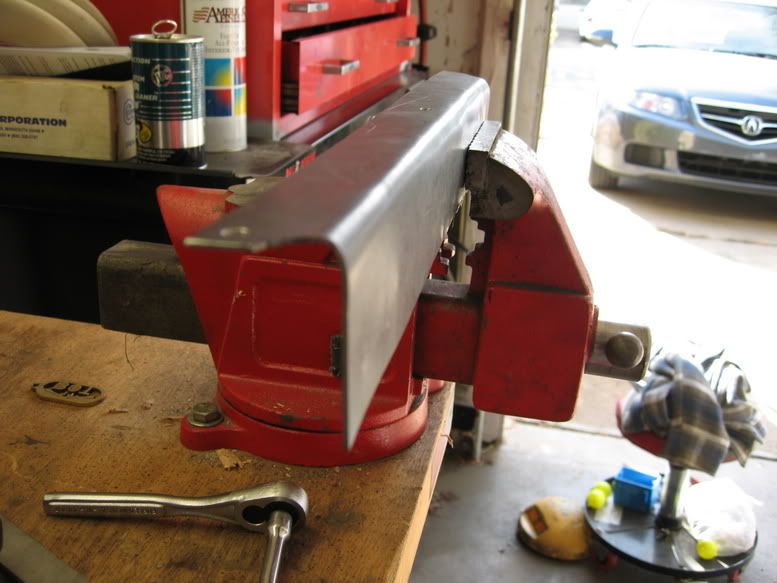

BillZ260 Posted December 31, 2005 Share Posted December 31, 2005 I built a heat shield for the passenger front brake line yesterday out of .035 steel, I'll post a pic soon with the header installed, they arn't too good. I used the mounting clamps for the original fuel lines to bolt to. There is about 1/8 to 1/4 of and inch clearance between the down tubes in the center and the sheild and about the same between the shield and the brake line. I plan on painting with high temp paint and possibly wrapping the headers with heat tape. As you can tell I really don't want to bother to move this line, thoughts??? Anyone know when brake fluid boils? I'M WORKING ON MY CAR AND IT FEELS GREAT Quote Link to comment Share on other sites More sharing options...

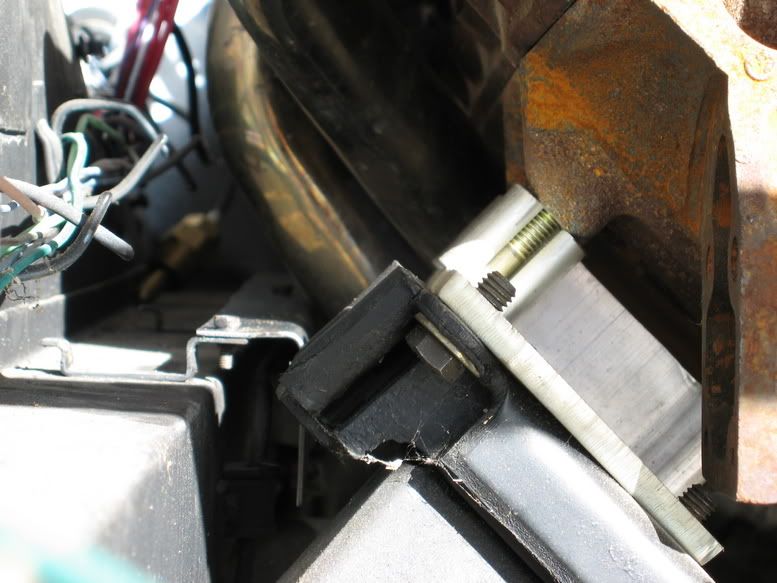

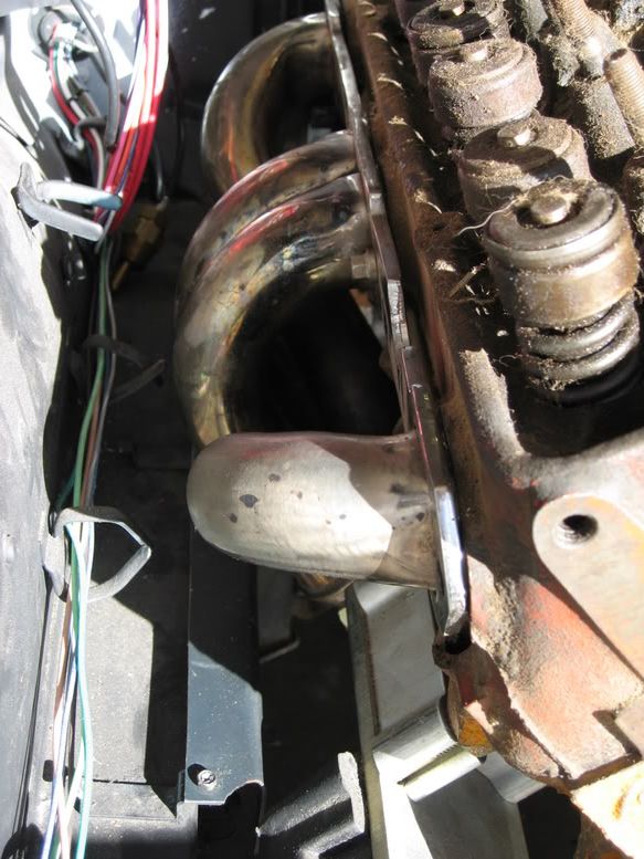

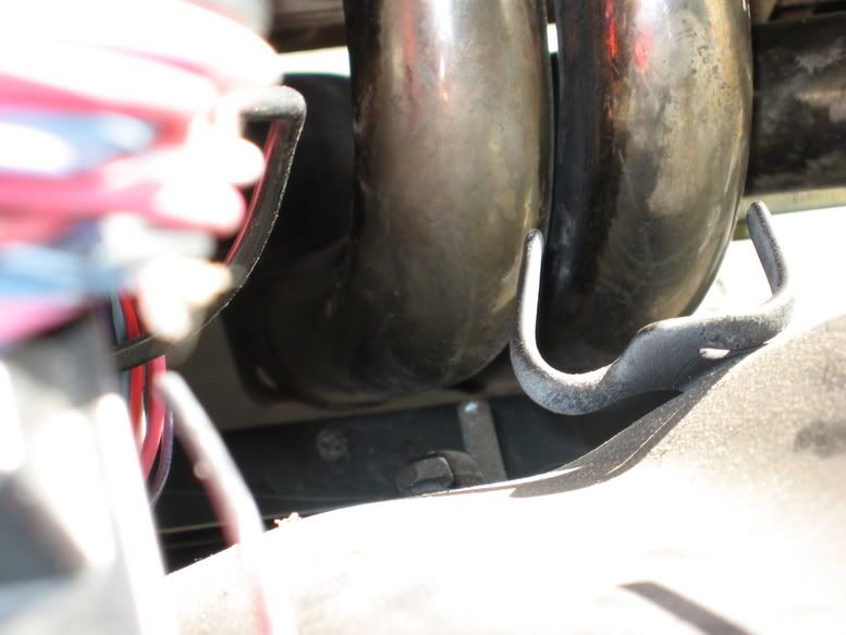

BillZ260 Posted December 31, 2005 Author Share Posted December 31, 2005 Just finished on the bench... Installed Front View, you can see the air between the shield and the brake line... Installed Top View-see how it's bolted to the existing brackets... Here you can sort of see the clearance between the shield and the header, I think it's a large enough pc of metal to dissipate most of that heat, or so I hope!!! Quote Link to comment Share on other sites More sharing options...

pallnet Posted January 3, 2006 Share Posted January 3, 2006 3 Comments. 1) Shield looks good 2) I would add heat sleeve on the lines as added protection in that area 3) Thats some nasty *** crud you have in the head of that engine.... Quote Link to comment Share on other sites More sharing options...
