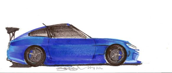

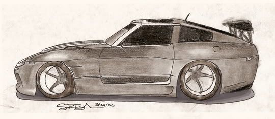

Drftn280zxt Posted April 1, 2006 Share Posted April 1, 2006 Well just what the title said. The first isn't all that new, I just never did scan it into my computer till now. The other I did just yesterday. Dimensions are little off, the back end is too short and the front end is way too short, but you get the general design idea. The dimensions of this one are money (for the most part). This is another one of my signature manual photochops. The wheels are messed up (again). I swear wheels with angled spokes like VOLK TE-37's are a pain in the a## to draw. The rear flare I kinda messed up on as it should blend a little nicer into the door. Whats your take on 'em? Quote Link to comment Share on other sites More sharing options...

PapaCreech Posted April 3, 2006 Share Posted April 3, 2006 That 2nd one i really like reminds me of a bastard thre way child between my 92TT 87na 78L6 i like it if ya get any more drawings especially of the rear that follow that Train of thought as far as from a rear angle, a 45 and a fron tlooking to rear 45 angle Hehehe if you follow that drawing out more post em i really liek the way that looks and im at a stage of bodywork that those might be doable Quote Link to comment Share on other sites More sharing options...

phantaz Posted April 6, 2006 Share Posted April 6, 2006 i like the fact the gas cap is on the drivers side.... =) great drawings as usual Quote Link to comment Share on other sites More sharing options...
Drftn280zxt Posted April 7, 2006 Author Share Posted April 7, 2006 that was a bleed through mistake. The picture I modified is on the other side of the paper (printed) I accidentaly drew in the gas cap with out realizing the car would flip sides on the other side...OOPS I knew someone would eventually catch that mistake. Quote Link to comment Share on other sites More sharing options...
Gollum Posted April 11, 2006 Share Posted April 11, 2006 The more I think about a widebody the more I'm worried about this one thing... The corner window comes up at a certain angle and the rear window is square. I'm worred that you'd end up with this nice curvy quarter panel and a boxy upper half that you couldn't change unless you put in midified pillars, windows, and roof. Do you know what I mean? I think the roof lines need to tie in with the widebody and I don't know how well it will work. I'd imagine either you'd have to keep working on the widebody till the lines matched or get the widebody to the look you want and then midify the roof to match. Quote Link to comment Share on other sites More sharing options...
Drftn280zxt Posted April 13, 2006 Author Share Posted April 13, 2006 what's the corner window? The lines of the body would be perfectly intact it just that they will extrude out further towards you. Here is the funny thing a 4" widening in the rear really doesn't look all that much wider when you walk out to the car envision it, it is very subtle widening. The rear quarters have a "shoulder", that would not change. Then there is that "crease" that run the whole length of car. From the bottom of the "shoulder" to that "crease" is where the extrusion would take place. Make sense? Same lines just extruded out further from the body. Quote Link to comment Share on other sites More sharing options...

veritech-z Posted April 14, 2006 Share Posted April 14, 2006 i think the zx needs a little something to give it some character. i like the rear flares, but i would steer clear of the fast and furious non-functional air scoops most body kits incorporate into the rear of the rocker panels which i see hints of in that pencil sketch, especially since the front part of the side skirt looks like it is wider than the stock fender, but would have to angle back in to make that scoop work the way you have it drawn. it looks awkward to my eye, but if you have to have a little vent there, i would rather see it behind the rear wheel to vent out some of the air that gets trapped there. are you planning to shave the door handles, or are you going to try and space them out to where they would have to be in order for you to extend your fender into the door like you have it? Quote Link to comment Share on other sites More sharing options...
Drftn280zxt Posted April 15, 2006 Author Share Posted April 15, 2006 but i would steer clear of the fast and furious non-functional air scoops most body kits incorporate into the rear of the rocker panels With the wheels being as wide as they would be, and the brakes being "tucked" in so far. It seems to me a vent would be kinda necessary to allow proper cooling. You are correct about how the vent would have to angle in. Of course it would angle is A LOT to allow as much air in to cool the rear brakes. the front part of the side skirt looks like it is wider than the stock fender Do you mean wider than the widened front fender? The sideskirts would be wider than the STOCK fender, but they would FLUSH with the wide fender. if you have to have a little vent there, i would rather see it behind the rear wheel to vent out some of the air that gets trapped there Hmm, I never thought about that. You bring forth a good point. If I did have the vent to allow cool air in to cool the brakes, I would need a way to let that air out. This is an interesting conundrum, WHY? Because I don't want any hole/vents in the rear quarter panels. Hmm are you planning to shave the door handles, or are you going to try and space them out to where they would have to be in order for you to extend your fender into the door like you have it? Going to try to space them out to match the new widened portion of the door. Far easier said than done I'm sure Quote Link to comment Share on other sites More sharing options...
veritech-z Posted April 15, 2006 Share Posted April 15, 2006 yeah, what i meant by that was wider than the stock fender, but in order to get that duct to work, it would have to tuck back in, or the duct would have to stick out even more than the new wider side skirt in order to get any air in there. both of which seem like they would be visually awkward (of course that is just my opinion though), although having it tuck back in would be the less awkward solution. with those wheels you are using (is there a real wheel you have picked out like that by the way? they are pretty cool) i would expect you'd have plenty of brake cooling, but if no, you could always source your brake cooling ducts from the air passing under the car(there should be some space near the drive shaft in the center), and have the air directed from inside the wheel well. unless you route the air beyond just opening a duct, it's only going to hit the tire anyway, and not be directed towards the brake rotor, doing what i imagine would be more aerodynamic harm than brake-cooling good? Quote Link to comment Share on other sites More sharing options...
