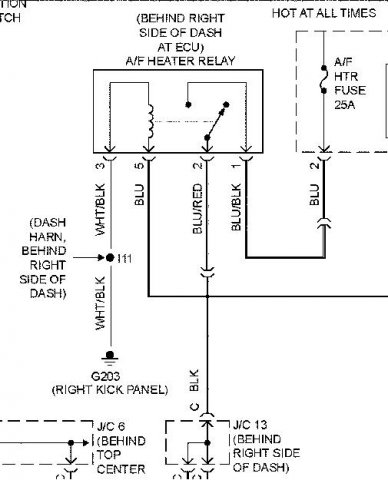

Okimoto Posted May 10, 2006 Share Posted May 10, 2006 check this relay, maybe it's stuck in the on position. Maybe you can set it on some kind of timer to go off after 9 minutes of driving? Quote Link to comment Share on other sites More sharing options...

Pop N Wood Posted May 11, 2006 Author Share Posted May 11, 2006 Okimoto said: check this relay, maybe it's stuck in the on position. Maybe you can set it on some kind of timer to go off after 9 minutes of driving? Man, I owe you big. My POS Chilton manual didn't show an A/F relay or fuse. The manual made it look like the thing was powered directly off the ECU. Thought maybe your diagram was for a different car. But I poked around anyway and found the blown 25 amp fuse. $2.82 for 5 fuses and the light is out. Let's see if this holds up. Sure beats $500+ Thanks. After what I went through last year I overlooked the obvious. BTW, those heaters draw some amps. The Chilton manual listed the resistance as 1.2 ohm at 68° and 3.4 ohms at 1472°. Thats 10 amps-120 watts per heater. Those suckers get hot! Quote Link to comment Share on other sites More sharing options...
