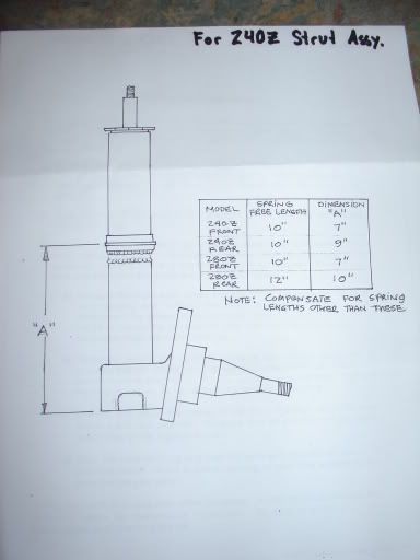

Cyind Posted July 5, 2006 Share Posted July 5, 2006 Thanks Pusher... Jon, The MSA fix was to send me instructions with hand writing in big black letters "For 240 Strut Assy." on both sheets... And my order shows a 1976 280Z on it. When I first got them I saw the 4" sleeves and never tried to fit them. This has been my third call to them and they think I should spend more money and find 240 housings to fix their mistake! This was on a 2700 dollar order at that. I'm tired of dealing with them and I ask Ross C for the right parts this time. Quote Link to comment Share on other sites More sharing options...
