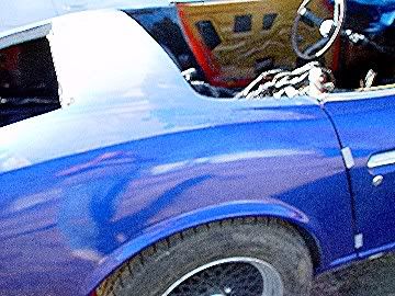

PnyPwr Posted July 5, 2006 Author Share Posted July 5, 2006 motor and trans are already in - they fit beautifully.... Made real engine stands off the frame rail(instead of the crossmember). The crank pulley is directly above the rack and pinion. Being the Lincioln motor, mine has the TB located at the back of the intake (can we say low profile?) I am using an AODE right now but have in the wings a 3650Tremec (out of a late Mach1), it might be too fun with the auto to mess with fabing up a clutch pedal.... this weeks project is running the COMPLETE Lincoln wiring harness and adapting it to run the Datsun lights etc. all Ford switches and electrics mean easy servicability with availiable parts pretty much anywhere in the country! Quote Link to comment Share on other sites More sharing options...

wheelman Posted July 5, 2006 Share Posted July 5, 2006 PnyPwr, Please post some pictures of the engine in the bay and the motor mounts. This swap has been discussed a few times on this site and the general concensus has been that the motor is to wide to fit so we are all very curious to see it. What did you do for the transmission crossmember? Are you running exhaust manifolds or headers and are they installed yet? How did they clear the steering shaft? Did you brace the frame rails? If not you should to prevent them from twisting due to the torque of the motor. Wheelman Quote Link to comment Share on other sites More sharing options...
PnyPwr Posted July 5, 2006 Author Share Posted July 5, 2006 ill try and get it back up on the rack this weekend for under carriage shots the motormount stands are hand made and the motor is solid mounted. the trans crossmember will be bolted through the frame connectors so it too is custom. I bought this car with the top removed and much of the frame work already started - I will be adding the roll bar back to the car soon to help tie it all together. I got 2 truckloads of parts along with it to get it back together. the motor is tight but not horrible - I am using log style manifolds for ease and my guess is the car will be quite deadly at 300 HP and 2000lbs. I have a 750 HP turbo mustang to get my straight line kicks, this thing needs to handle the twisties! Quote Link to comment Share on other sites More sharing options...

wheelman Posted July 5, 2006 Share Posted July 5, 2006 Damn, I'd hate to see what you think is horrible. That's the tightest engine bay I've ever seen. You must have to get at the exhaust manifolds, plugs, etc... from the bottom. Looks like you have hood clearnance problems also, yes, no?? Have you been able to weigh it yet to determine the weight distribution? 2000lbs would be very cool, especially with 300 hp. Wheelman Quote Link to comment Share on other sites More sharing options...

PnyPwr Posted July 5, 2006 Author Share Posted July 5, 2006 the cage plans tie the main hoop to rocker bars that run the length of the car and tie into the front frame. also will tie in the trans tunnel(also a structural member). the strut towers are already reinforced front and rear. the weakest point on the car right now is the rockers/door openings plugs come out the top of the heads (4 valve heads) and the exhaust is easy to get to from the bottom. Quote Link to comment Share on other sites More sharing options...
LMoore56 Posted July 5, 2006 Share Posted July 5, 2006 Looks good and the way I thought it would. Just enough room to slide your hand down the side between the towers. The SOHC has a little more room. I've got a 01 Police engine and tranny that I have been debating on installing into one of my two 77 280Z's. Quote Link to comment Share on other sites More sharing options...

PnyPwr Posted July 6, 2006 Author Share Posted July 6, 2006 plan on hood clearance issues - that is the only reason I stayed with the Lincoln intake on the 4V motor I should be able to get the stock hood closed. worst case itll be spaced up an inch at the rear and that will help cooling immensely. I want to have the hood closed all the way though. the only issue right now is the inlet tube everything else is all the way under! I may shoot the ,mass air and tube straight over by the pass firewall and out into the dirty air behind the front tire. I want it to run out in front of the radiator if possible though. brave? nah just hard headed! Quote Link to comment Share on other sites More sharing options...
