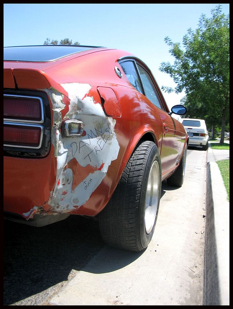

mk2mike Posted August 14, 2006 Share Posted August 14, 2006 Soo guys i screwed up pretty badly, but now looking to repair... how bad do you think it is? can i just pull the dent and bondo? yeah alot of bondo but i dont care at all... just want it better then this... i realllly dont want to cut another quarter out Quote Link to comment Share on other sites More sharing options...
mark Posted August 14, 2006 Share Posted August 14, 2006 Nothing structural there. Pull it out and mud it. Make sure your filler hose is OK as well as the vent hoses for the tank. Quote Link to comment Share on other sites More sharing options...
mk2mike Posted August 14, 2006 Author Share Posted August 14, 2006 yeah the hose is okay and the fuel door is fine too... but what about the side markers? what do you think about those just shave em or what? Quote Link to comment Share on other sites More sharing options...
Kennysgreen280zt Posted August 15, 2006 Share Posted August 15, 2006 Looks like there was a half way repair done there before. Pull it and see how it comes out. If its ok, great, if not youve still got to cut the panel up anyways. Quote Link to comment Share on other sites More sharing options...
slownrusty Posted August 15, 2006 Share Posted August 15, 2006 Wow hard hit, I saw the tree you hit over on zcar.com.... I would not even pull it...I would be taking my Sawzall to the scrap-yard...nothing like doing it properly and then maybe finishing it with a thin lick of Bondo. Yasin Quote Link to comment Share on other sites More sharing options...
Twoeightnine Posted August 15, 2006 Share Posted August 15, 2006 Yep. Cut a donor section. Match it to your rig. Weld it. Putty and paint. Hell paint the whole car! Quote Link to comment Share on other sites More sharing options...

78zlt1 Posted August 15, 2006 Share Posted August 15, 2006 I would replace it with a donor section. Quote Link to comment Share on other sites More sharing options...

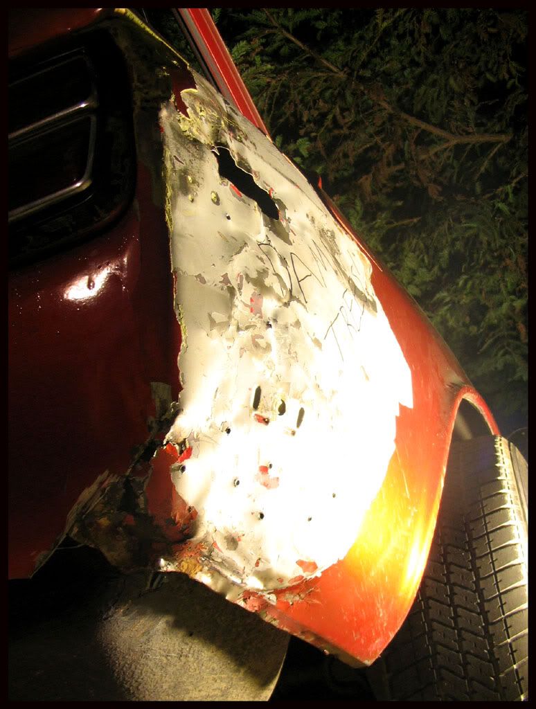

mk2mike Posted August 16, 2006 Author Share Posted August 16, 2006 it's coming along nicely just time to get the bondo work done Quote Link to comment Share on other sites More sharing options...
Twoeightnine Posted August 16, 2006 Share Posted August 16, 2006 God bless Bondo. Quote Link to comment Share on other sites More sharing options...
78zlt1 Posted August 16, 2006 Share Posted August 16, 2006 hey thats not bad , get a hammer and dolly and smooth it out more, weld the holes up, hit it with 80 for bite and skim it with a good fiber body filler Quote Link to comment Share on other sites More sharing options...
J__ Posted August 23, 2006 Share Posted August 23, 2006 it would be way faster and easier to cut in a new quarter than pull, and bondo.... Quote Link to comment Share on other sites More sharing options...

Twoeightnine Posted August 24, 2006 Share Posted August 24, 2006 it would be way faster and easier to cut in a new quarter than pull, and bondo.... Geez...why do that when we can just toss some goo on it. Quote Link to comment Share on other sites More sharing options...
EZ-E Posted August 24, 2006 Share Posted August 24, 2006 I would have to agree with the rest, that still needs a lot of work, you could very easily cut out a good donor section of what you need and weld and paint much easier. Thats just to much work to do with that piece when you really dont have to be doing it. Quote Link to comment Share on other sites More sharing options...
Twoeightnine Posted August 24, 2006 Share Posted August 24, 2006 I would have to agree with the rest' date=' that still needs a lot of work, you could very easily cut out a good donor section of what you need and weld and paint much easier. Thats just to much work to do with that piece when you really dont have to be doing it.[/quote'] The subtle point that I have been trying to sell is, and it may sound corny, but any thing worth doing is worth doing right. Also guess what? All that gooping is going to require a butt load of sanding,sweating and bitching. And unless you are a skilled "sculptor" it will wind up looking like poop. Bondo is meant to be used sparingly. Like over the seam left behind when one "replaces" ones quarter section. The Z needs to be beloved. They dont make em anymore Gents! Quote Link to comment Share on other sites More sharing options...
