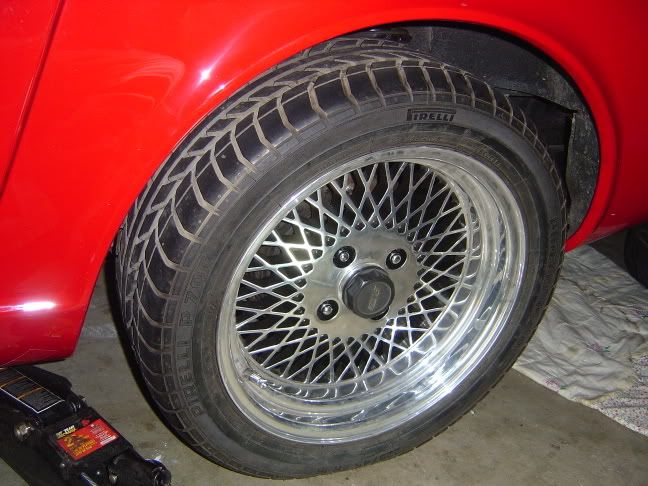

ULISES Posted August 30, 2006 Share Posted August 30, 2006 Hi, I have been searching online for a Drag Radial that fits a 16 X 7 Wheel and have no luck, Do any of you guys know if they make one? I was looking for a 235 but I dont think they make one, They do have the 245 but I dont know if I would be safe running it on a 7'' wheel. The center of the wheel has been pushed in like an inch so this makes it worst ( they are now negative offset).If I was able to run the 245 I dont know if itll clear the fender. The wheels are not mine, A friend is selling them and I really like them.Any input will be apriciated, Thanks! Quote Link to comment Share on other sites More sharing options...

Scottie-GNZ Posted August 31, 2006 Share Posted August 31, 2006 You are pretty much limited the Nitto 555R 245/50-16. There is a rule of thumb that says the wheel width should not be less than 70% of the tire's section width. That means the absolute minimum wheel width would have to be 6.75" making your 7" wheel just barely above the minimum. I use the same tires as my rear street tires and have them mounted on Z32 NA 7.5" wheels and do not even worry about them. So, if that is the wheel you are stuck with then be aware that you might have premature wear in the center of the tire if this is a daily driver. If these are track only with occassional street then I say use them as that is better than even a 295 street tire. 17" drag radials? Been there, done that and a waste of money IMO. Quote Link to comment Share on other sites More sharing options...

ULISES Posted September 1, 2006 Author Share Posted September 1, 2006 I know they have drag radials for a 16'' from 245 and up sizes, The problem is that the wheel has been modified from the center section so I dont think it will clear the fenders.I will use some 15 x 8 wheels when going to the track, I just wanted this to be my provisional street wheels. I'm just going to pass on this deal. Quote Link to comment Share on other sites More sharing options...
LS1 240Z Posted September 1, 2006 Share Posted September 1, 2006 depends on how bad you want the wheels and how good of a deal they are, for under a $100 a wheel (i think) you can have them widened. have them widened an inch and you will have 16x8 wheels (LT1 and LS1 camaro sized wheels) and will have literaly thousands of tire choices Quote Link to comment Share on other sites More sharing options...
