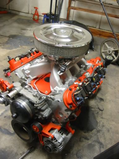

Guest Mike Posted September 13, 2006 Share Posted September 13, 2006 all you need is a alternator bracket and a tensioner from a f-body. Our cars dont have power steering and I doubt your gonna run A/C. Oil pan will be a must Im pretty sure though. Here is a pic of mine so you get an idea Mike............. the air cleaner wont be on there for long' date=' just keeping crap outta my motor. Anyway both orange pieces on the front is all you need. [/quote'] Wanna sell yours? Quote Link to comment Share on other sites More sharing options...

Pop N Wood Posted September 13, 2006 Share Posted September 13, 2006 all you need is a alternator bracket and a tensioner from a f-body. Our cars dont have power steering and I doubt your gonna run A/C. Oil pan will be a must Im pretty sure though. Here is a pic of mine so you get an idea Mike............. the air cleaner wont be on there for long' date=' just keeping crap outta my motor. Anyway both orange pieces on the front is all you need. [img']http://i13.photobucket.com/albums/a267/Lason/240Z%20Conversion/126-2640_IMG.jpg[/img] I know the F body belt is 3/4 of an inch farther from the block than the vette stuff because I had to solve that problem when I tried to put an F body alternator bracket on my LS2. But in researching alternator placement I read that the truck belt runs even farther out than the F body belt. Is that a truck WP and crank pulley on that engine? Just want to know. Also the carb is one way around the tall truck FI intake. I thought someone once posted the truck intake will not clear a Z hood. BTW, Lason, what carb and jets are you running? I would love to ball park my carb set up before I try to start my engine. Quote Link to comment Share on other sites More sharing options...
Lason Posted September 13, 2006 Share Posted September 13, 2006 I know the F body belt is 3/4 of an inch farther from the block than the vette stuff because I had to solve that problem when I tried to put an F body alternator bracket on my LS2. But in researching alternator placement I read that the truck belt runs even farther out than the F body belt. Is that a truck WP and crank pulley on that engine? Just want to know. Also the carb is one way around the tall truck FI intake. I thought someone once posted the truck intake will not clear a Z hood. BTW' date=' Lason, what carb and jets are you running? I would love to ball park my carb set up before I try to start my engine.[/quote'] you know what, your right. I didnt even think about the crank and waterpump pulley. There MIGHT be a problem there too Mike. No my motor is straight out of a F-body. The car intake cleared with plenty to spare but my current setup will require a cowl hood. I havent had it in the car with the carb'd intake yet. As far as jetting I have no idea. I will probably end up with a new carb when Im done. Right now I have a 750 that came off my last hotrod. Its a proform body with holley parts. I was still tuning it when I pulled it off so its not spot on just yet. I had a real dead spot with the proform body that Im blaming on a bad piece. The bores dont line perectly up with the holley baseplate. A problem others have had as well. I may try to use it with a billet baseplate and metering blocks and new bowls but I doubt it. Ill probably throw a HP series double pumper on it when I get there. Quote Link to comment Share on other sites More sharing options...
