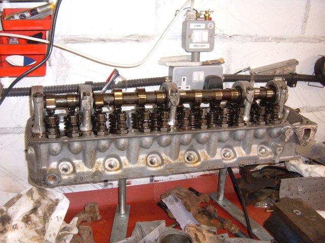

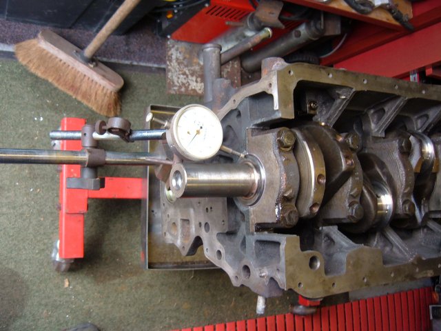

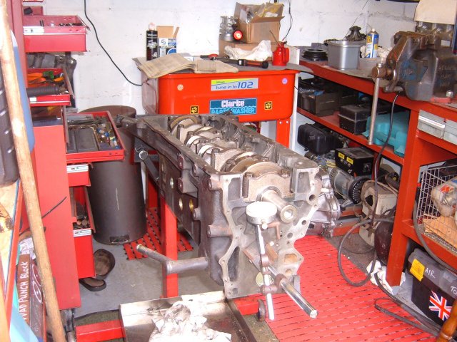

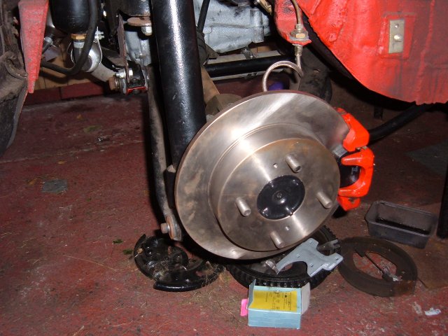

evtech Posted August 2, 2007 Share Posted August 2, 2007 Hi folks Some pictures of the SLOW progress I'm making, only excuse is I've now turned 40, so it's time to slow down (not) Rear disc conversion 50% complete, using 280zx rear calipers and new discs. (full set of brake springs, working wheel cylinders, handbrake levers and powder coated drums now going up for grabs on ebay UK by next weekend. Crank fitted to block and end float checked at 0.003" total, so well withing tolerance. Sneaky little shot of the engine in me 'DEN'. Head built up with cam installed and gapped. Currently ringing the pistons, they will get popped in soon enough, still loads of 'little' jobs to do that take so much time got all the new ECU sensors to fit'find homes for (air, water, map, crank, throttle pot, clutch, speed, intercooler cooling etc); going to change fuel supply line from 5/16 up to 3/8. Just drilled and tapped the exhaust manifold and fitted the lambda sensor, so thats one job done, it's nice working nights when the job's quiet, you really can get your jobs done you just can't do a good firm for enough:) On a negative note I can confirm that a 280ZX power rack WILL NOT fit in a 260, the only thing that my have worked was to use the 280 Xmember, but I shy'd away from upsetting the geometry. Enjoy the piccy's. Nige Link to comment Share on other sites More sharing options...
kcelectronics Posted August 3, 2007 Share Posted August 3, 2007 On a negative note I can confirm that a 280ZX power rack WILL NOT fit in a 260, the only thing that my have worked was to use the 280 Xmember, but I shy'd away from upsetting the geometry. Enjoy the piccy's. Nige Hi I used a Subaru rack in my 2+2? Link to comment Share on other sites More sharing options...
