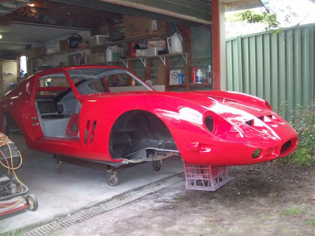

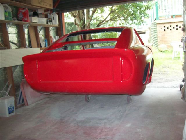

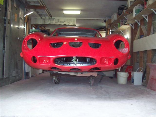

Boy from Oz Posted April 2, 2014 Share Posted April 2, 2014 BTW the company that sells the kit in Australia is Classic Revival http://www.classicrevival.com.au/250gto.html I would also keep your eye on eBay as both incomplete and complete kits show up once in awhile. Ian is retiring and closing up shop at Classic Revival, The moulds have been for sale for some time but no takers. 240Z and 260Z 2-seaters are becoming very rare in this country and fetching high prices for good body shells so a GTO is no longer a cheap build - was it ever? I agree with Speedracer that you are better off first searching for an incomplete or finished kit you can customise to suit yourself. Let me tell you there is plenty of work in just doing that. The trick is to ensure it has minimal rust. Failing that, then consider a scratch build. Rust elimination was the main reason I wanted to built one from scratch but it has been a long, long, long road... Too long. Finally got some paint on it. Quote Link to comment Share on other sites More sharing options...
SpeedRacer Posted April 3, 2014 Share Posted April 3, 2014 The car looks fantastic Peter! The transformation when you painted it is amazing and it is great to see so much progress. Quote Link to comment Share on other sites More sharing options...
