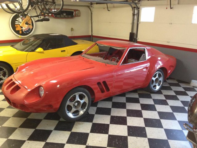

escaladess Posted October 30, 2016 Share Posted October 30, 2016 Wow! There doesn't appear to be much in the way of comments in the past 10 years but I do have an original Alpha GTO molded in 1989 which I have owned since then. It is currently being rewired, re-powered and has new paint. Escaladess Quote Link to comment Share on other sites More sharing options...

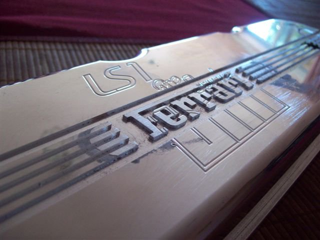

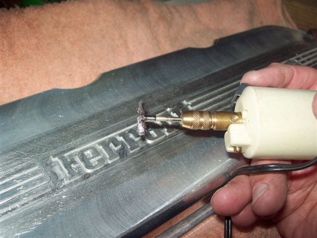

Boy from Oz Posted November 8, 2016 Share Posted November 8, 2016 Give some thought to modifying other alloy covers which are available. I had planned to build up a centre strip by running a series of welds the length of the cover and then engraving the Ferrari name and ribs. I discovered the covers I purchased (for an LS1) were 6mm thick so there was no need to add weld material. Quote Link to comment Share on other sites More sharing options...

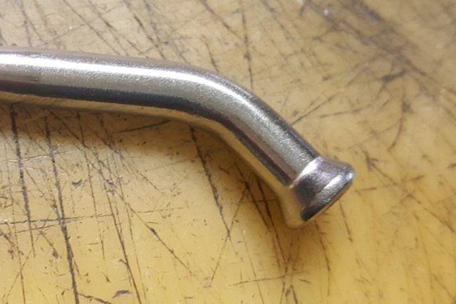

TomoHawk Posted November 8, 2016 Share Posted November 8, 2016 (edited) I am working on the smaller items right now. The current item is the covers for the jack holes, or "sill hole covers" (1st & 2nd photos.) They remind me of the knob on a stove control panel. There are many options you could choose. Some people have chosen to use ordinary covers used on your kitchen sink (3rd & 4th photo) but (3rd photo- my selection, but a solid top.) Maybe someone here might have a mold &mini-foundry to make up sand-cast aluminium slugs that could be finished by ourselves (First photo. You could even use a cheap plastic hole cover Please review the attached photos. Edited November 8, 2016 by TomoHawk Quote Link to comment Share on other sites More sharing options...

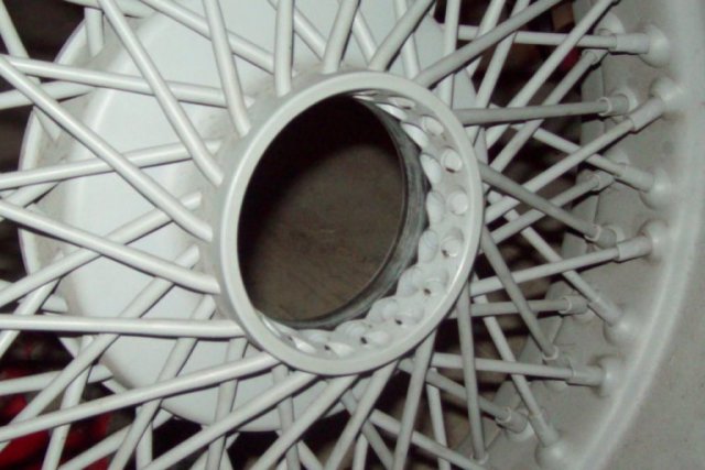

TomoHawk Posted November 8, 2016 Share Posted November 8, 2016 (edited) That's the good thing about the Dayton wheels; you can use them on any vehicle and just change the threaded hubs. BTW- I did some comparing of my 225-65/15 tires, and they are the same size as the what you get on the 250, but some people (original GTO owners) changed to a 16-inch wheel, or a wider wheel (7 inch) or tire. Some people ("experts") are probably going to tell me I "should have used" a wider tire, but I used the spec tire, and I never listen to them anyway- they probably watch too much PC TV or look at muscle cars. Edited November 22, 2016 by TomoHawk Quote Link to comment Share on other sites More sharing options...

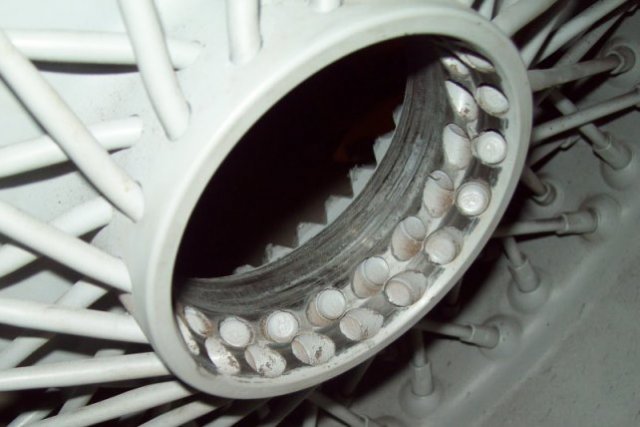

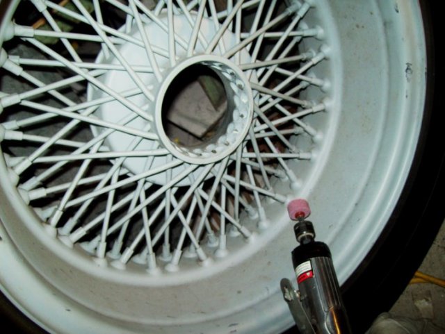

Boy from Oz Posted November 9, 2016 Share Posted November 9, 2016 (edited) The bad thing about Dayton Wheels is that they have (had?) appalling quality control. I purchased my Daytons some years ago as I believe wheels are critical to getting the right 'look'. I built the fender shapes and the suspension around the wheels. When I finally got to run the car I had a bad knocking sound in the rear which I eventually traced to the Willwoods - but that's another story. In the process of researching the knock I discovered the spoke heads which attached to the Dayton centre hub were too big, or the centre was not drilled deep enough for the spoke heads. Either way the heads protruded above the taper seating surface. As a result the caps only engaged on a small area of the spoke head rather than the broader taper surface, further, this resulted in a deep groove being gouged in the caps when the caps were tightened. I had to use a die grinder to trim down the excess material. Compare the 1st and last photos to see different seating. When I raised this with Dayton they simply said the wheels were out of warranty, although they were hardy used. Edited November 9, 2016 by Boy from Oz Quote Link to comment Share on other sites More sharing options...

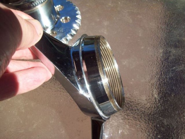

TomoHawk Posted November 21, 2016 Share Posted November 21, 2016 (edited) Speaking of the Dayton wheels, the wheel nut/spinner is plain without any engraving; like a Boranni logo & removal-arrow. Has anyone managed to do any engraving (I think they were stamped before being chrome-plated) or anything else? Instead of grinding the chrome off, then engraving, and re-chroming the nut, I was thinking of other means to duplicate the effect. One idea was to have some medallions or "coins" made with the graphic (two different graphics are needed because the arrow is reversed on one side) and then glue the things to the nut. Perhaps a trophy shop could do that? I know the Dayton nut/spinner has a removal arrow on it already, so you'll at least need the Boranni logo (the open hand with rays of light.) I still need to get the graphic right, because the curved arrow with a fancy tail is not standard to most graphic design softwares. I think what I would do is to have the design put on an aluminium "coin" or disc and glue the disc to the wheel nut/spinner. It's just too much trouble to de-chrome, engrave, and re-chrome the thing. What do you think of this design? I put together a few shapes using MS PowerPoint: New wheels! Edited November 23, 2016 by TomoHawk Quote Link to comment Share on other sites More sharing options...
SpeedRacer Posted November 23, 2016 Share Posted November 23, 2016 TomoHawk, Check around at various trophy shops and see if they can laser engrave. I had a local trophy shop engrave the Cavallino rampante (prancing horse) on mine. Quote Link to comment Share on other sites More sharing options...
