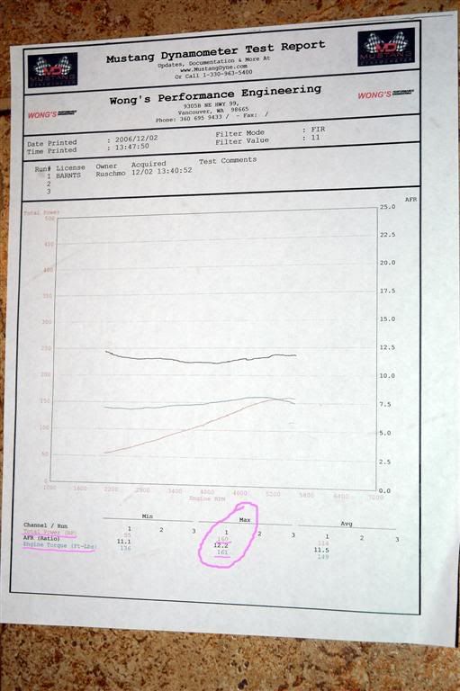

Administrators BRAAP Posted December 5, 2006 Administrators Share Posted December 5, 2006 Ok, I couldn’t resist. 2 days ago, Saturday, we also ran an essentially stock N/A L-28 that we built, on a Mustang dyno in Vancouver WA. First and foremost, this is a show car, not a performance car. An absolutely stunning ’76 2+2 car. We built the bottom end BONE stock, OE Dished pistons, etc. Not even balanced. The head, well it is a bit massaged. The head is one our custom N-42 heads, extensive valve unshrouding, 4 and 5 angle valve seat work, back cut valves, mild street porting in the ports, carved off the front inspection cover and fuel pump boss and welded those in. The owner then had the entire exterior of the head polished. Definitely a one of kind L-series cylinder head. The entire valve train is bone stock with the original ’76 Cam etc. Intake manifold and throttle valve are stock ZX parts with only visual enhancements, the EFI is also all original bone stock ’76 components, just visually altered as it is a show car. The only other performance enhancements other than the chamber/port work is the 6-2-1 header with a single 2 ¼” exhaust system and Electramotive DIS ignition with Magnecor wires. No other power enhancements. With the extensive valve unshrouding, the comp ratio is a paltry 8.1:1. This set up hasn’t even really been dialed in either, (hence the fat AFR), only seat of the pants tuning. This Dyno session was just baseline for future mods, (the car is currently under mine and Rons knife in the shop right now). On the Mustang Dyno, this very low compression N/A L-28 running pretty fat AFR, produced 160 HP, 161 lb/ft of torque. Nothing to write home about, but for a very low compression stock L-28, not too shabby. FWIW, another essentially stock L-28 that we built a P-79 head for using a stock cam, stock intake and EFI, 6-1 header and 2-1/2” exhaust and again, only seat of the pants tuned, produced pert neer identical HP and torque at Torque Freaks, (Dyno jet), last year. Both of these cars mentioned are currently receiving new WOLF 3d engine management, car pictured is getting a new manifold as well…. Aggressive Cam, intake, and some dyno tuning would definitely wake both of these cars up, A LOT!!!! Paul Quote Link to comment Share on other sites More sharing options...
