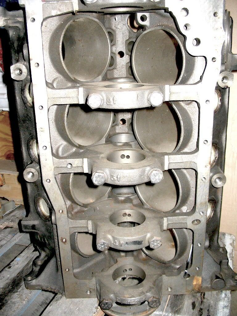

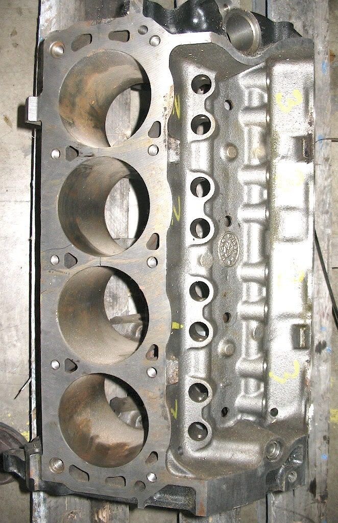

Z24O Posted September 12, 2007 Share Posted September 12, 2007 couple of pics of the mexican Quote Link to comment Share on other sites More sharing options...
LMoore56 Posted September 12, 2007 Share Posted September 12, 2007 Hey Z240, could you post a picture of the front of the block, that shows the the two round spots? That would be for the people here that has never seen a Mexican 302 block. Quote Link to comment Share on other sites More sharing options...
