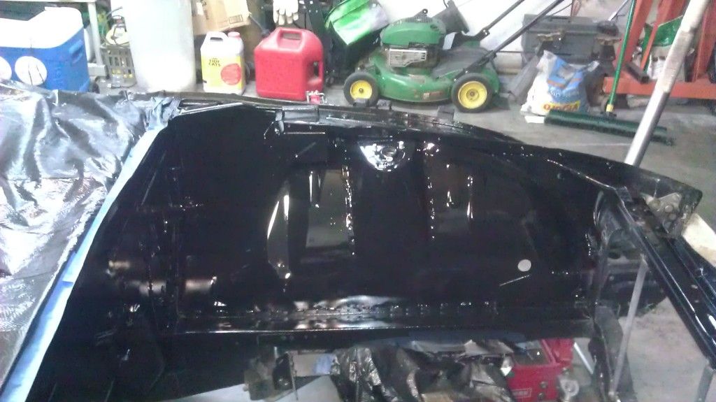

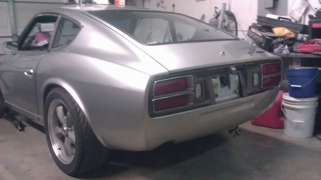

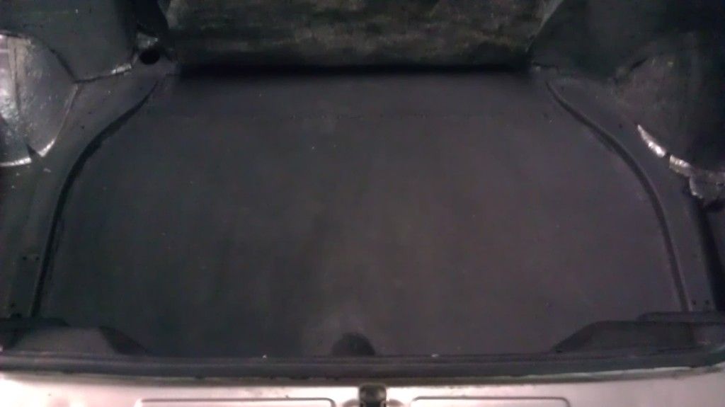

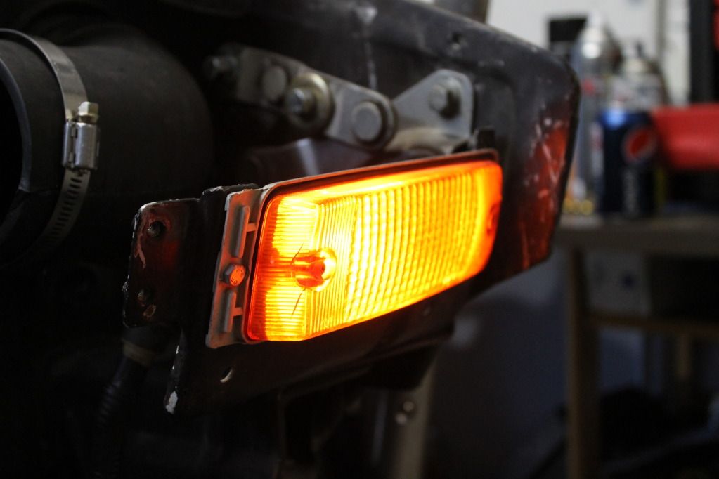

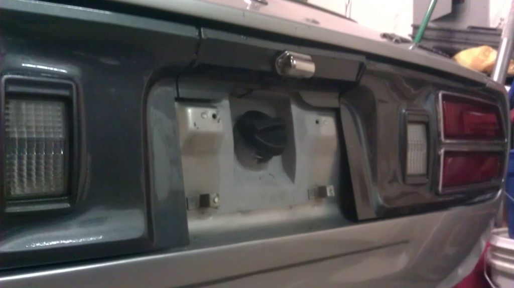

Done with everything to do with fuel system except wiring the fuel pump.
Hatch and taillights put back on as well.

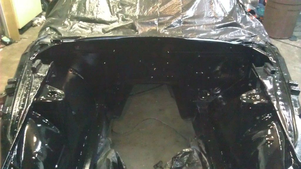

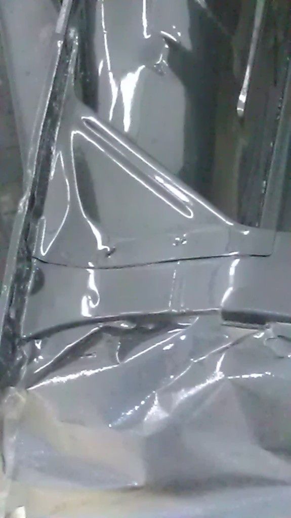

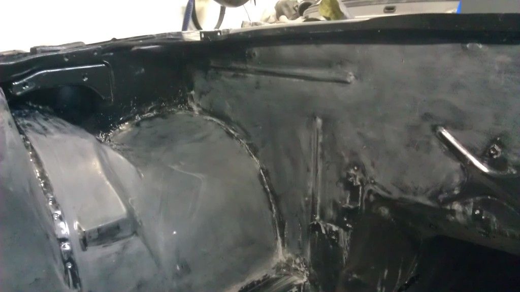

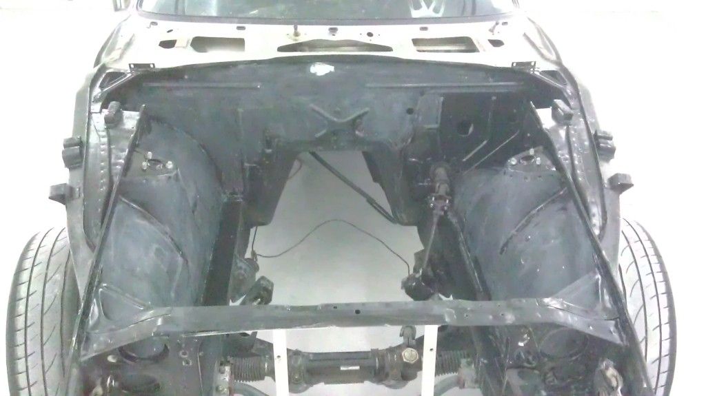

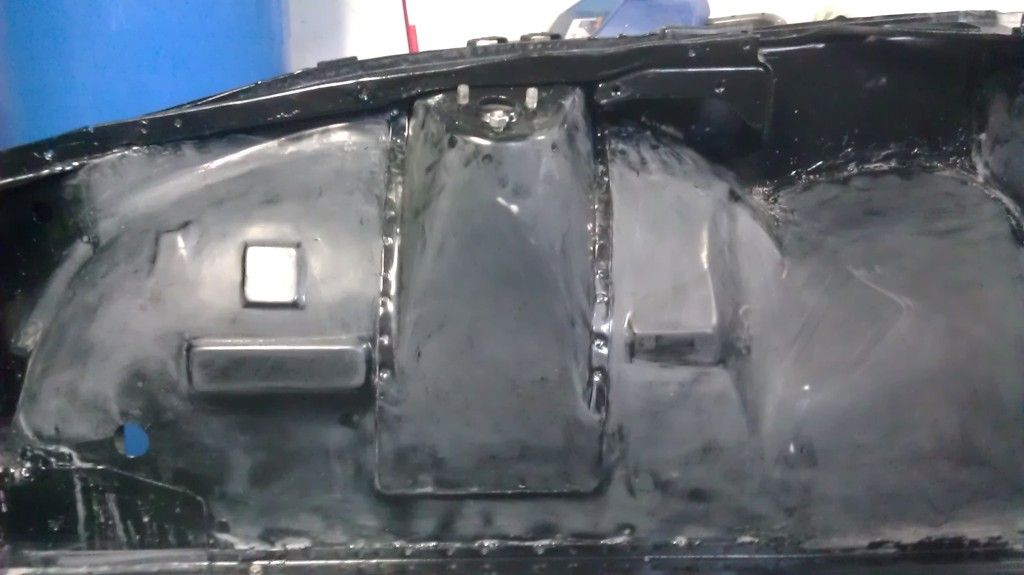

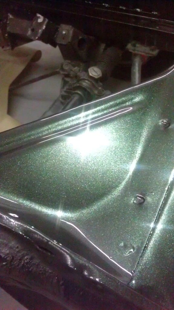

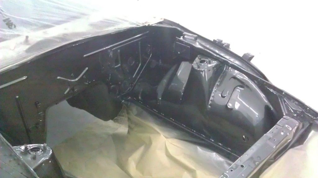

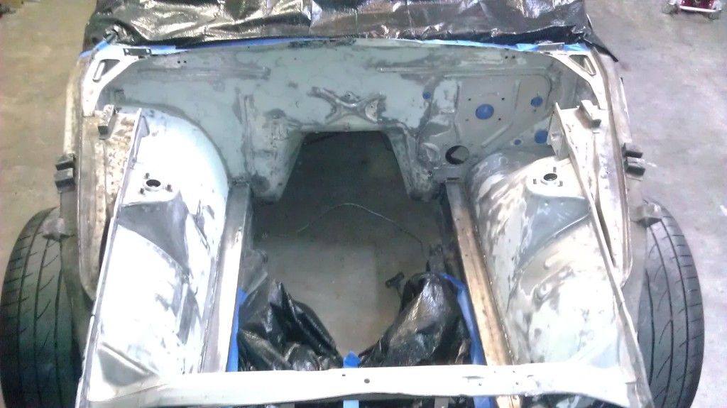

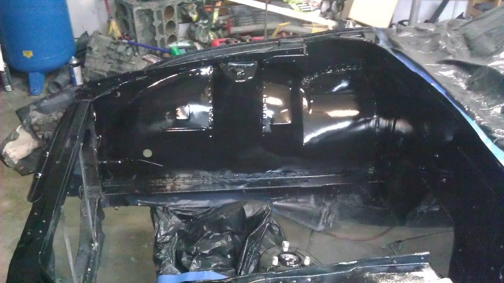

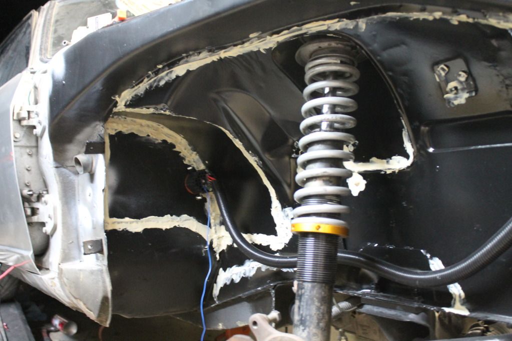

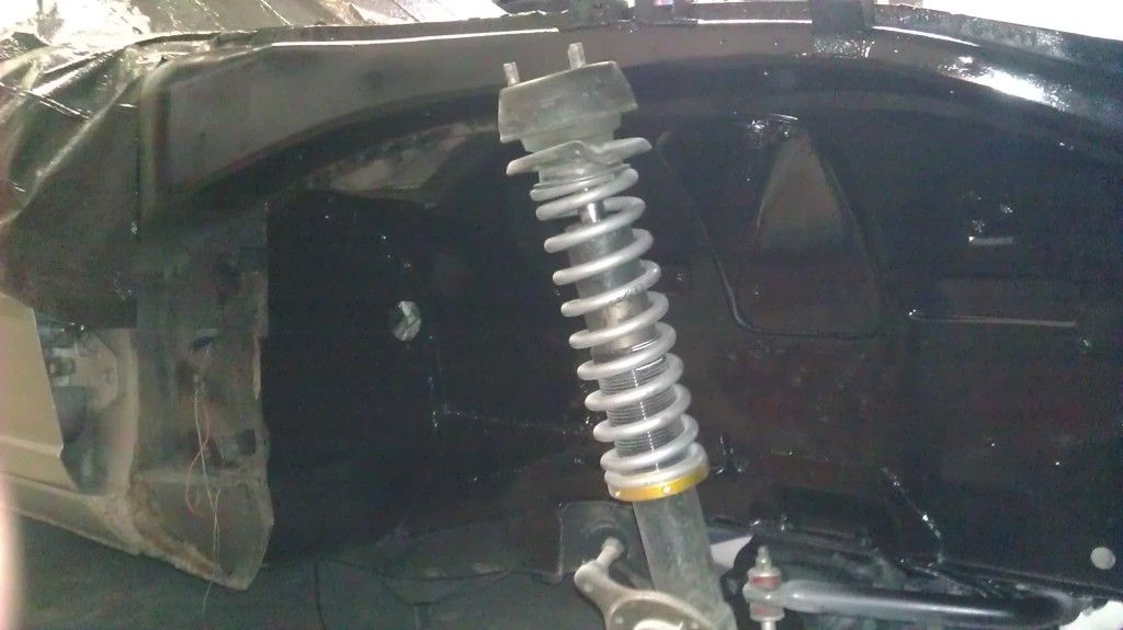

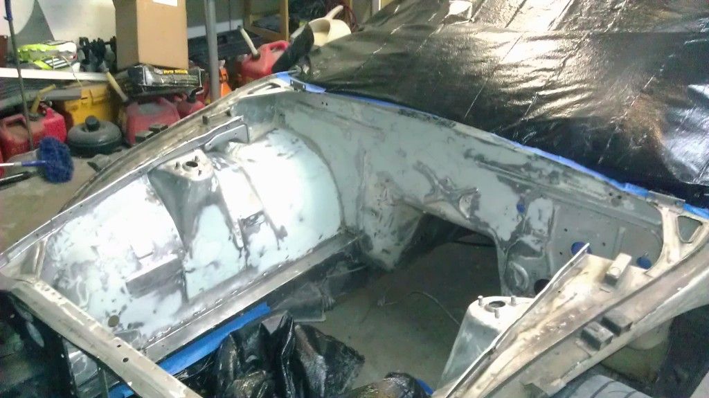

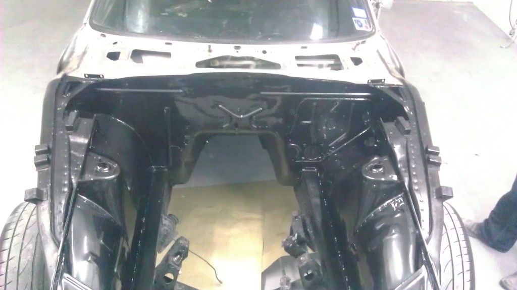

Seam sealed and painted.

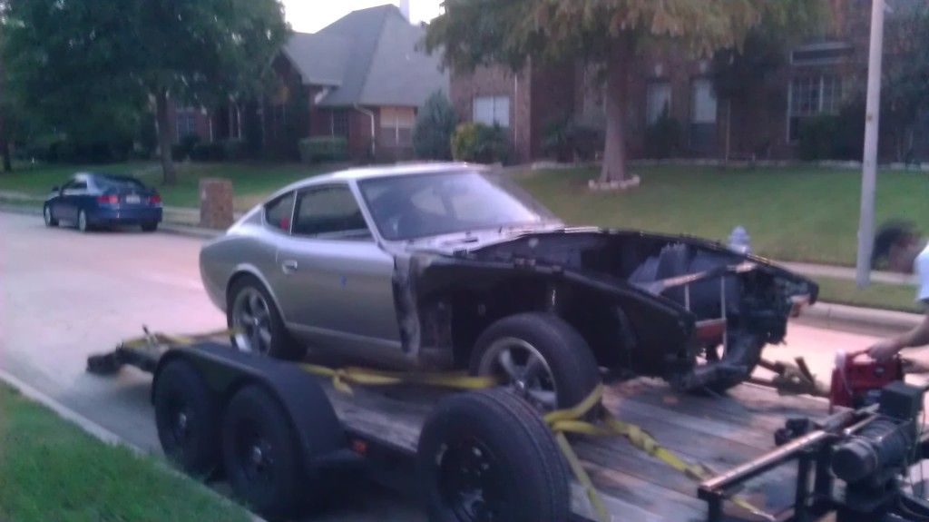

Starting to look like a car again... need to get flip down license plate bracket still

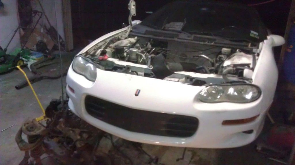

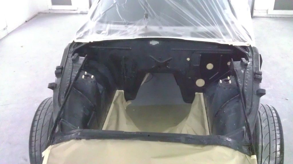

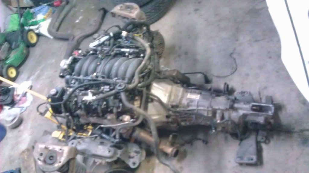

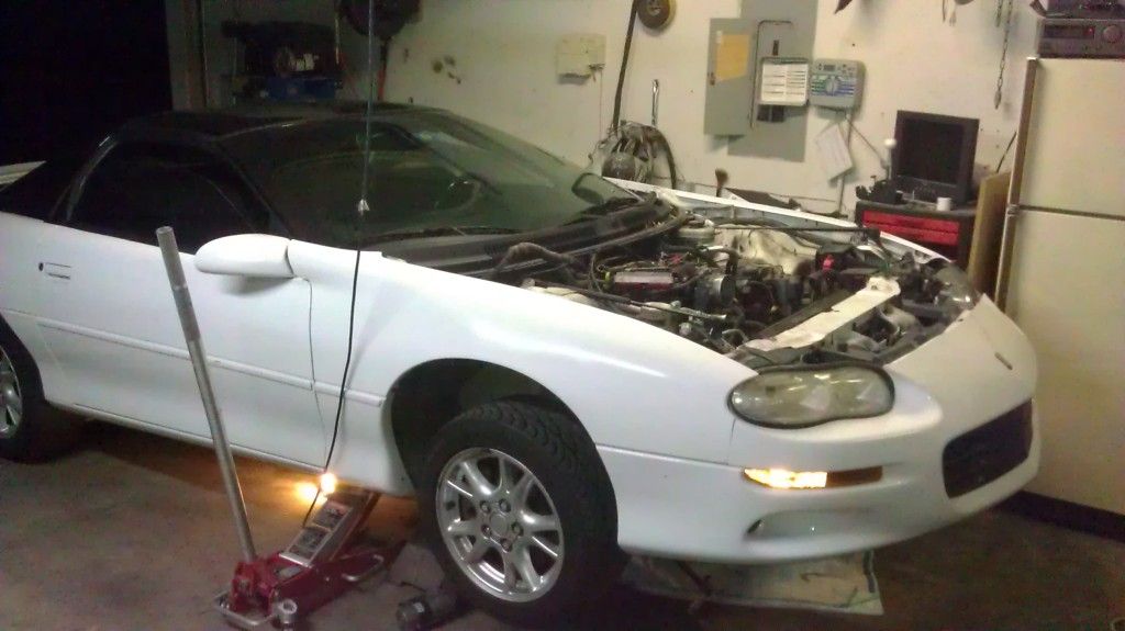

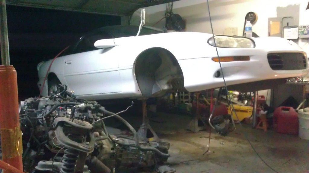

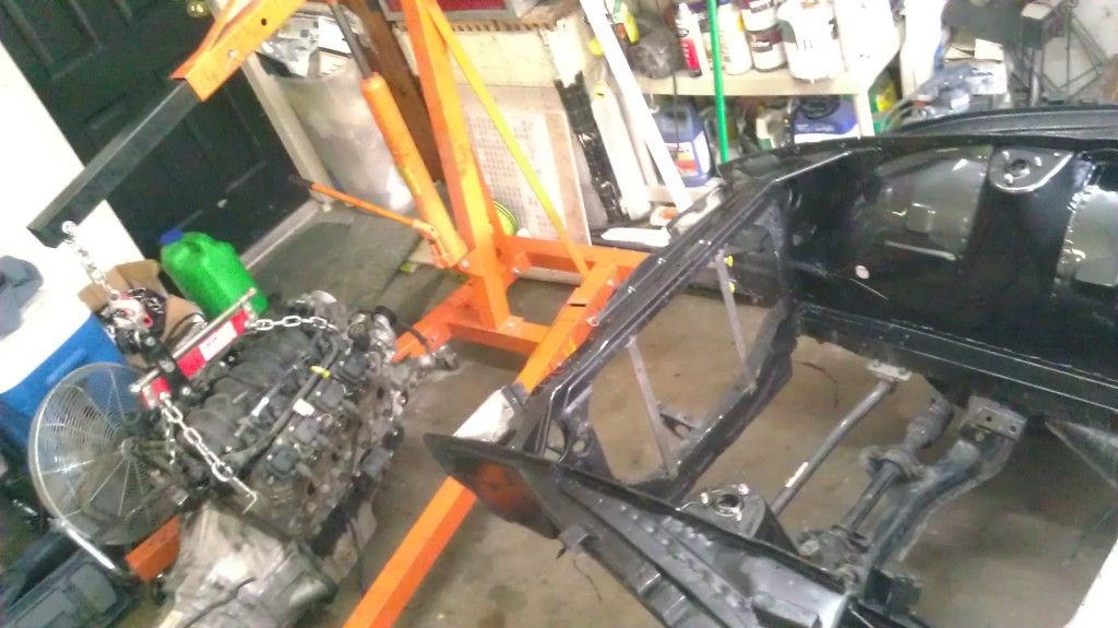

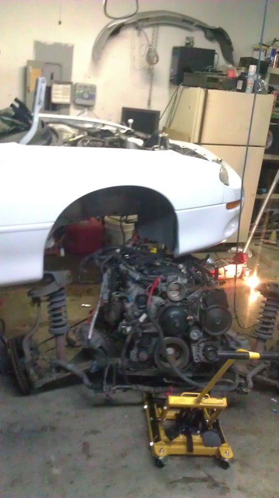

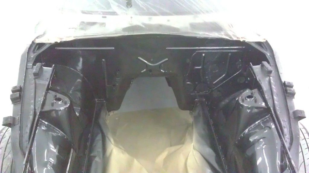

Haven't done much with the engine bay.. going to try and get it mostly finished up this week and then hopefully to my friend to paint it in the next week or two. While its off to paint, I'm going to bring in the donor vehicle and yank the engine and trans out of it.

wet sanding.
found a couple small things that i need to touch u,p but all-in-all it looks pretty decent so far.
Scheduled to get it in my friends booth early next week and while its there I'll bring in the donor and pull the engine/trans.

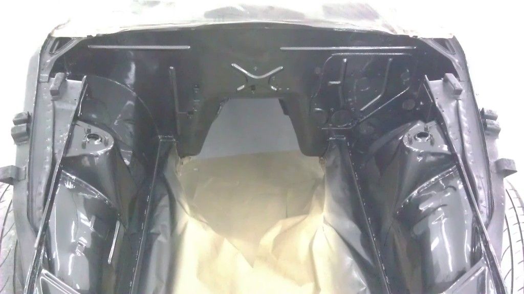

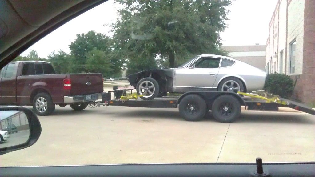

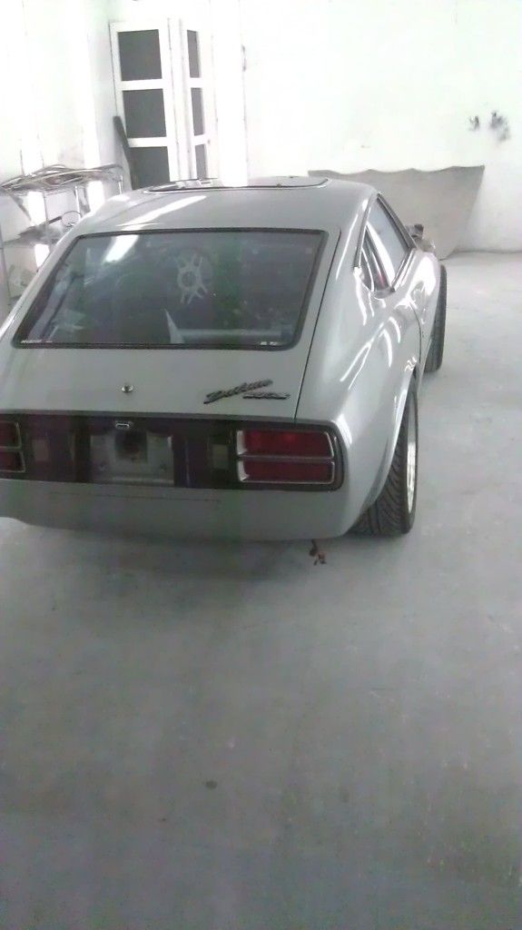

Bringing the Z back from paint.
Pushed it up in to the garage.

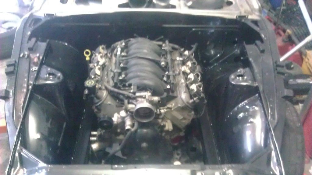

Engine in new home. Working on getting some stuff mocked. Found out i need to slot the holes for the mounts a little more...

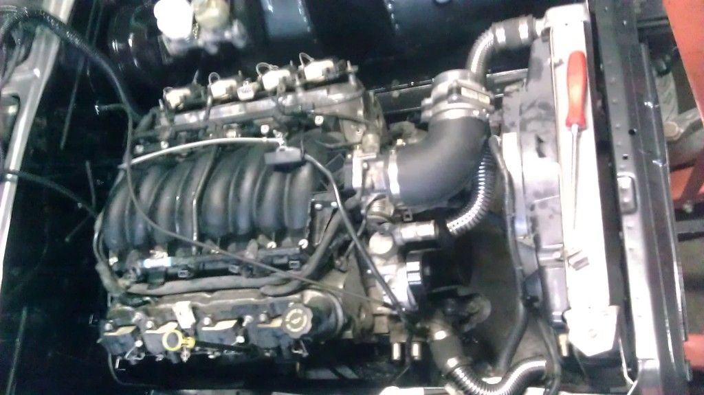

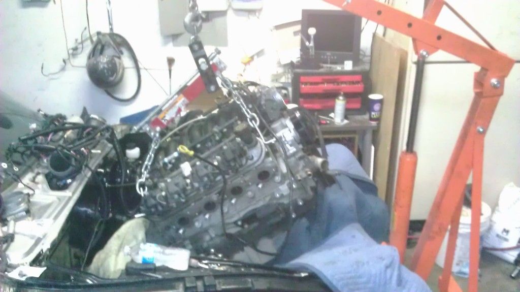

Engine going back in after bolting up transmission
Shifter placement couldn't have been better. This was kind of lucky since i never mocked up the engine with my mounts with a t56.

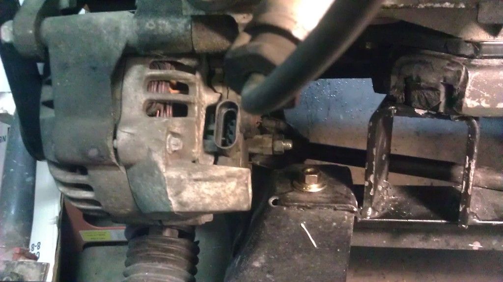

Alternator mounted and clearance looks good.

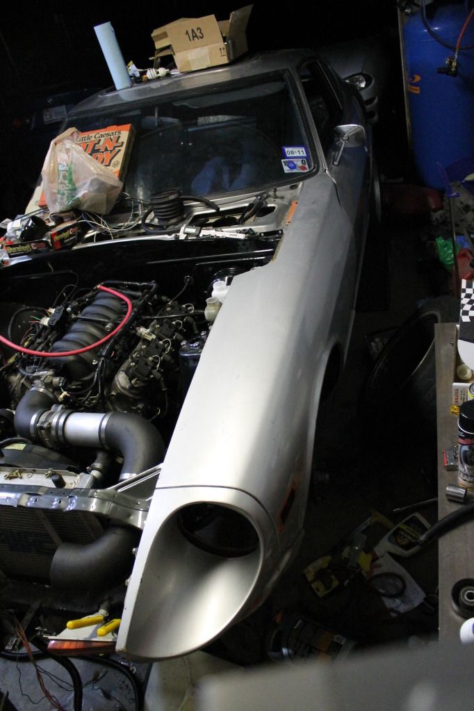

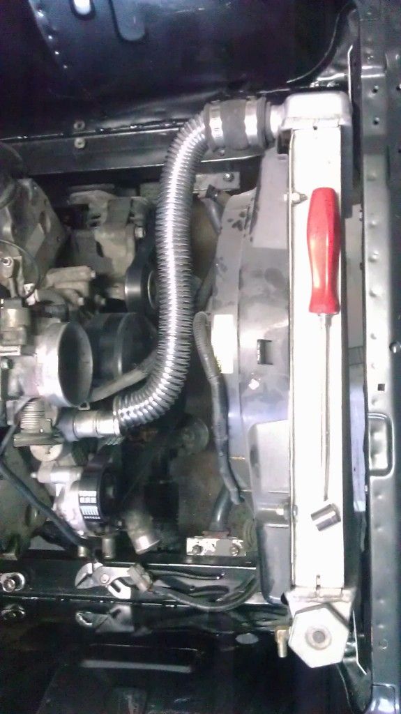

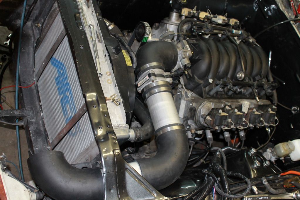

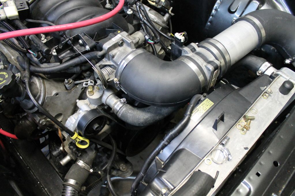

Bolted radiator in. Upper hose is going to be close. Might just try and chop up f-body hose and splice it.
Lower hose fits perfectly
overview

JTR Intake piping done. Just need filter and a couple more clamps.

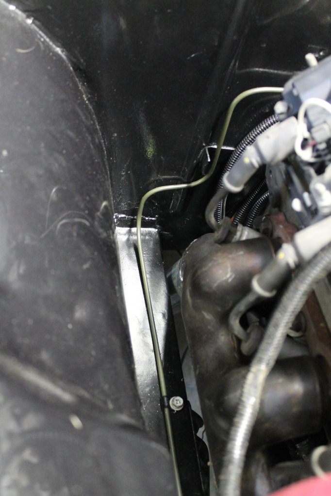

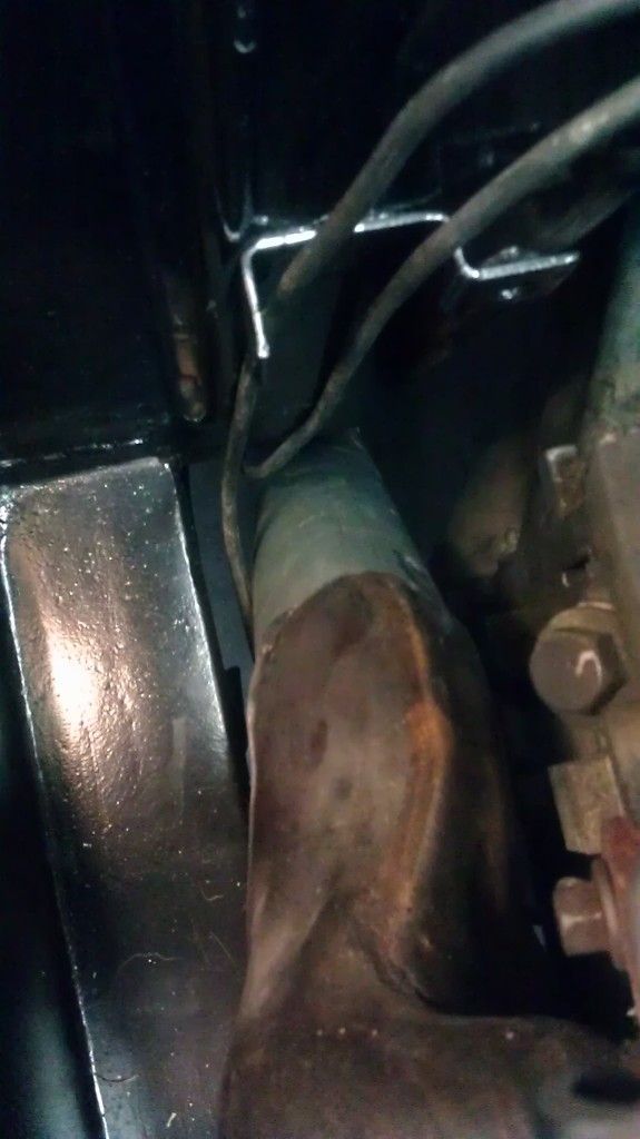

Passenger manifold mocked up. Needs to be full welded still. Bascially just chopped off the flange and welded on an extension. Waiting for drivers manifold to ship in... its going to get some similar cutting done. Already made new passenger front brake line that will go along the top to the frame rail. Rear brake line will just be bent out of the way of the exhaust

New brake line bent

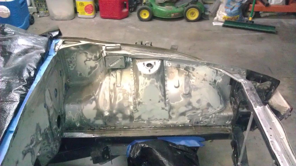

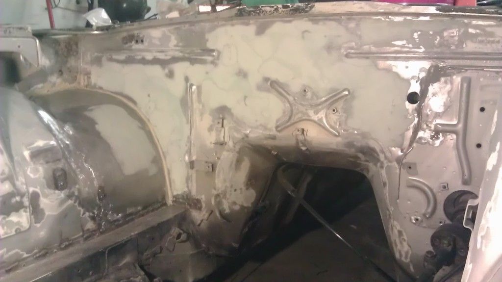

New front fender. It needs a little bit of body work, but virtually no rust.

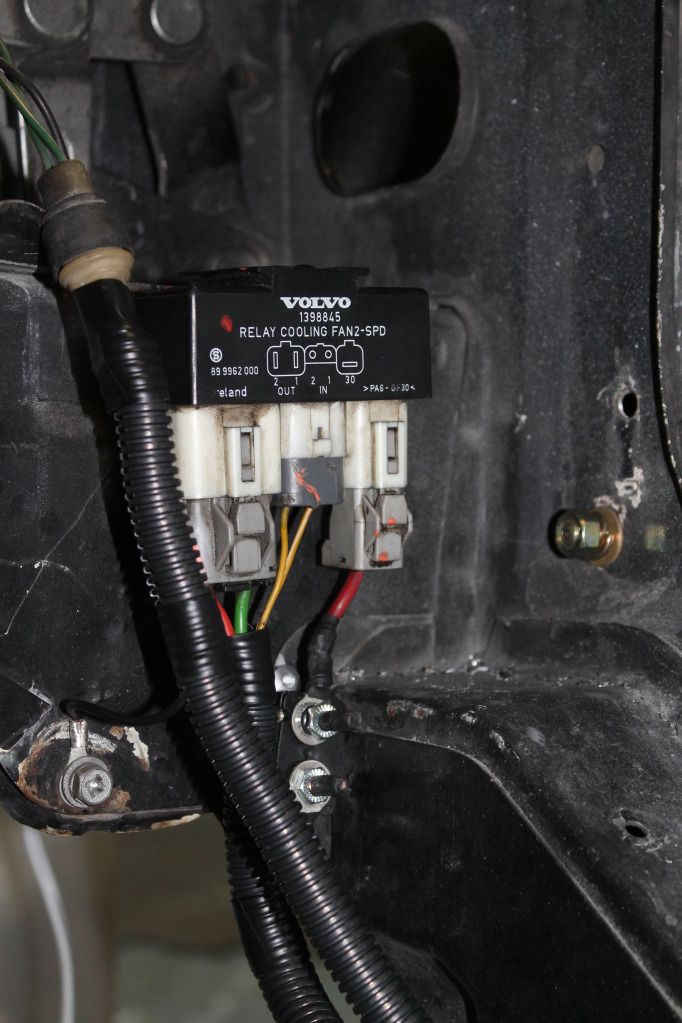

Fan wiring done. ECM will control the Taurus fan with this Volvo

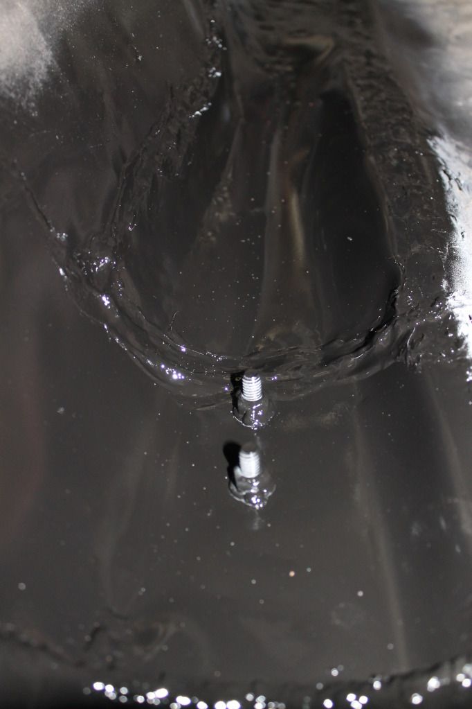

seam sealer

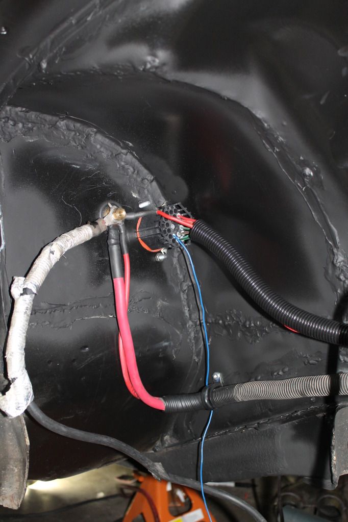

Starter and alternator wiring are done.Still working on where I am going to mount battery. Cable to the left is just for hooking to battery to test things.

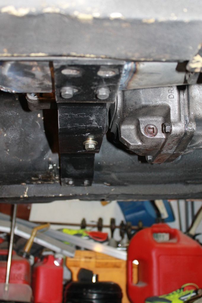

Drive shaft is in.

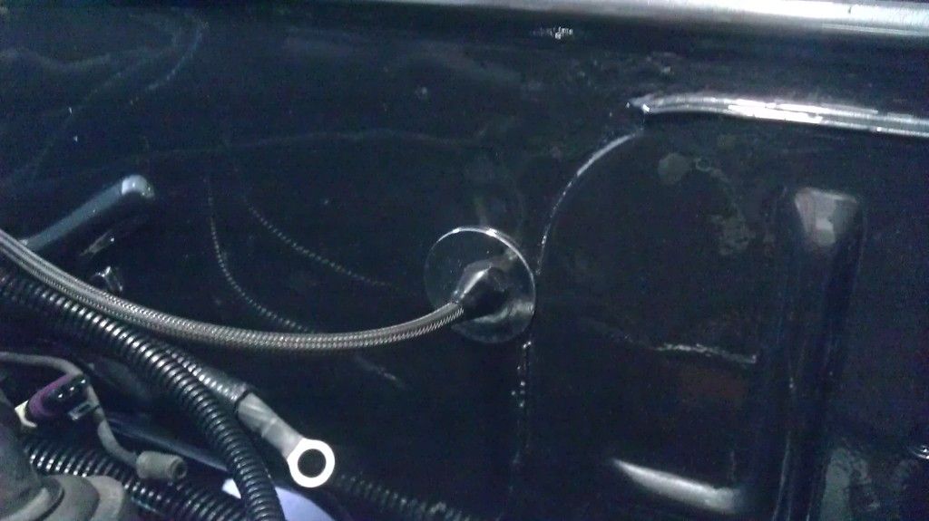

Heater lines blocked off.

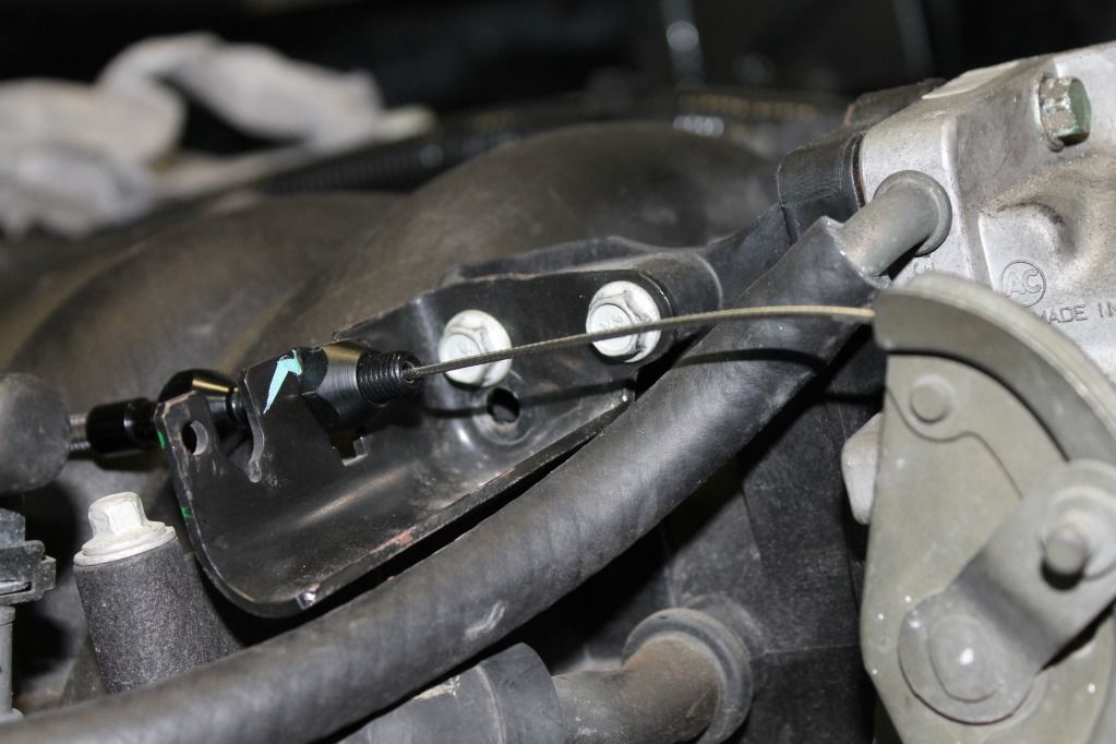

Drilled new hole on throttle bracket so the cable has a straighter shot at the throttle

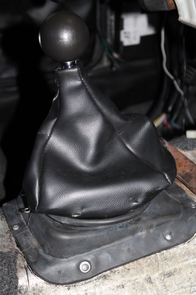

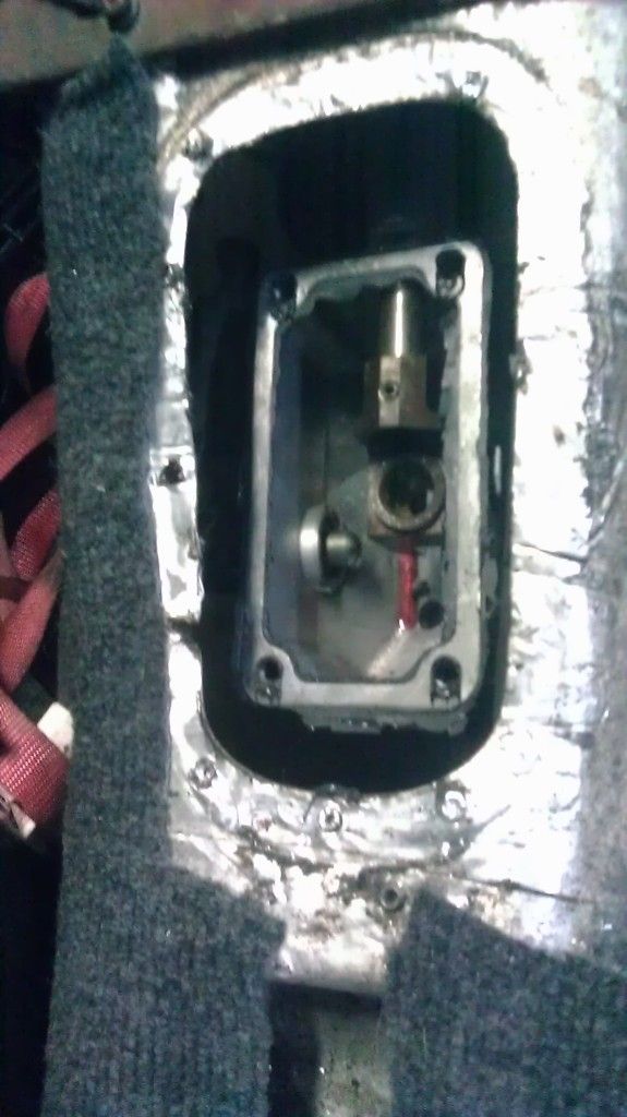

Rubber shift boot installed

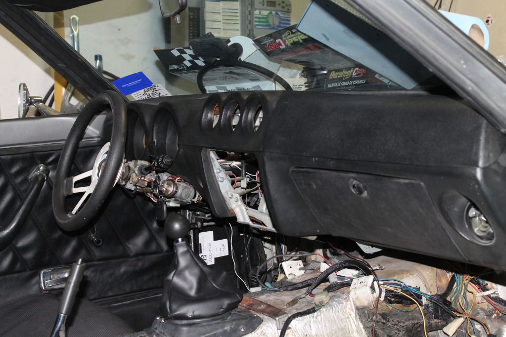

Dash is back in.

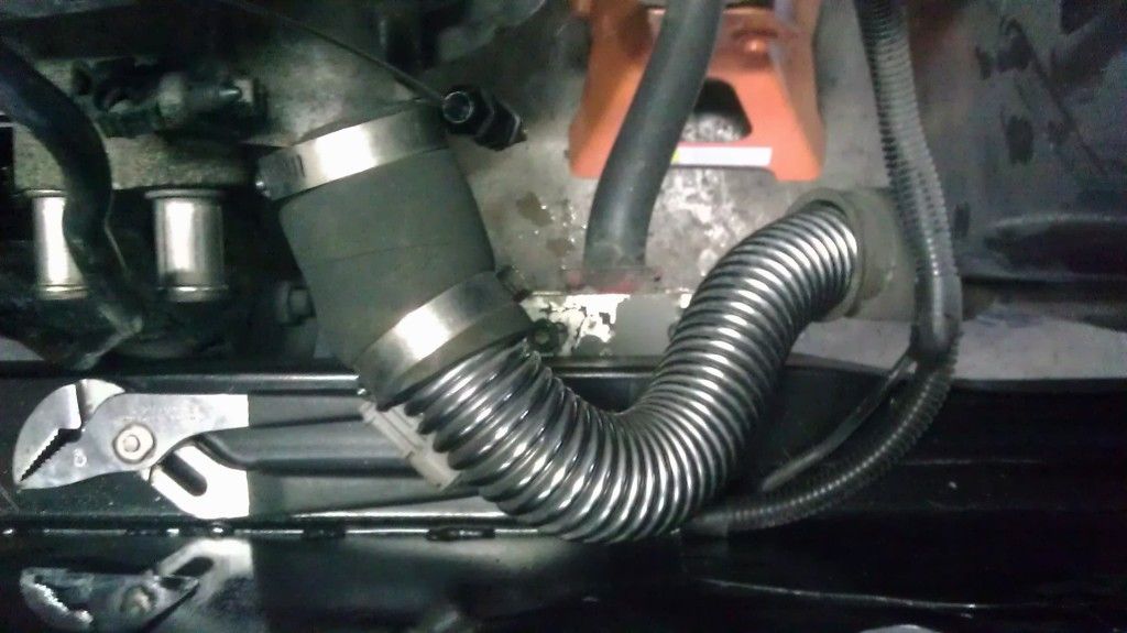

Upper Radiator hose

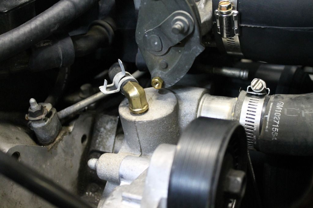

Steam vent routed to water pump

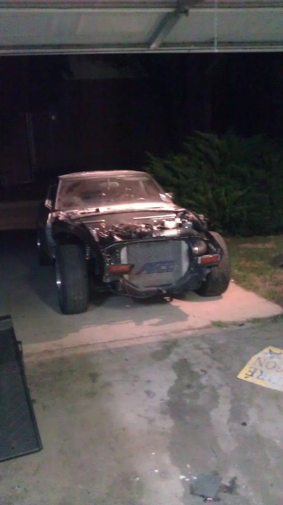

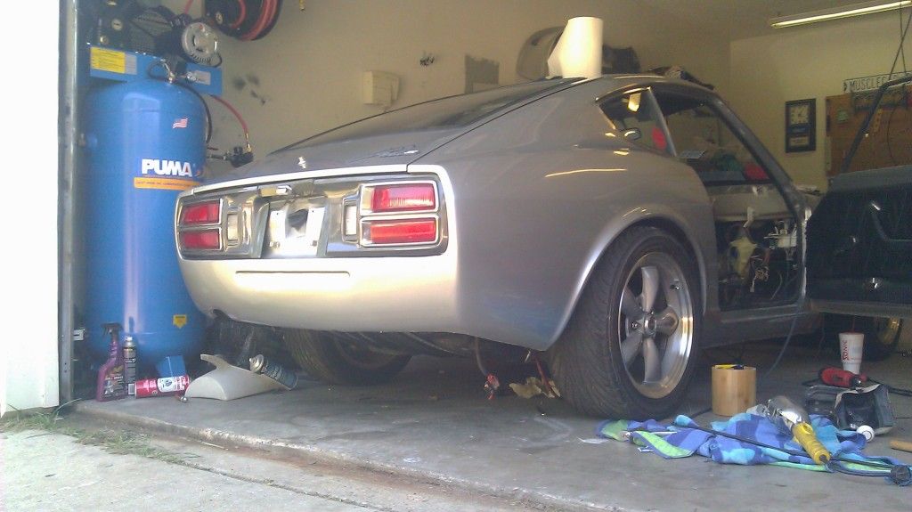

First time in 21 months that the car has moved under its own power.....
washed it and drove it around the block today.
ordered mandrel bends for exhaust the other day. Also ordered MGW shifter because I don't trust the shifter that is in there (saw the current shifter on ebay for $30 shipped... new)

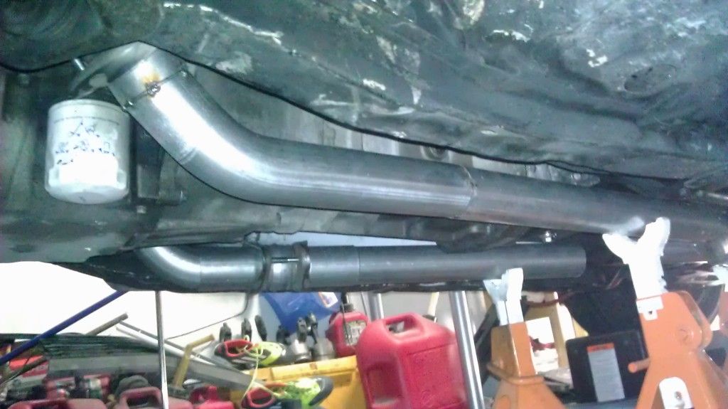

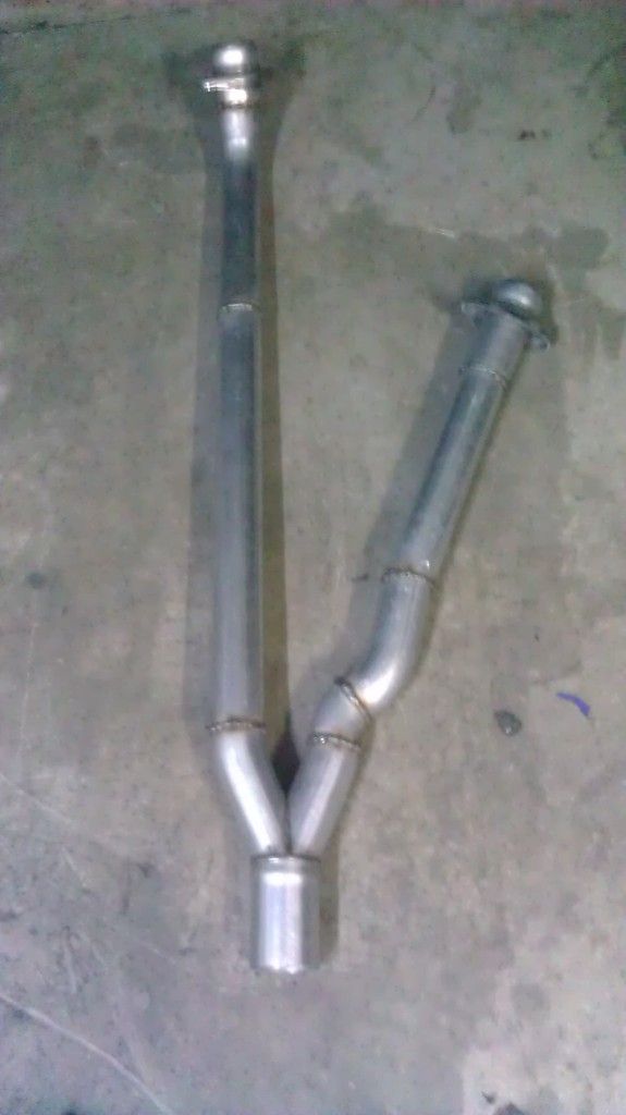

well as you'll see in this post... I decided to tackle the exhaust myself.

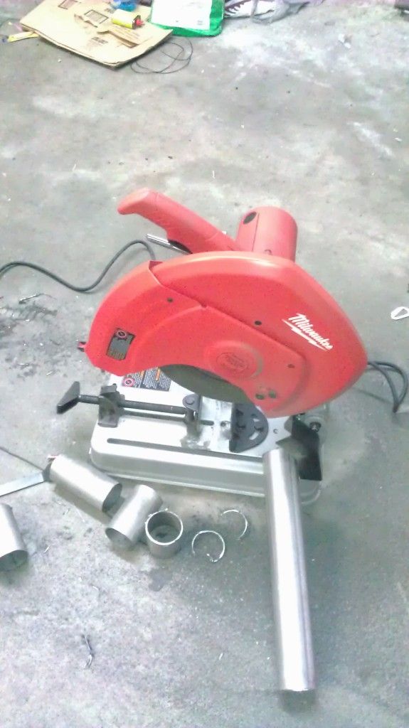

Bought a chop saw around 8 tonight....

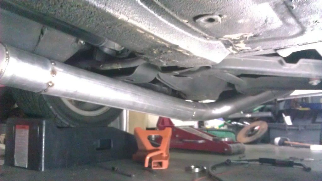

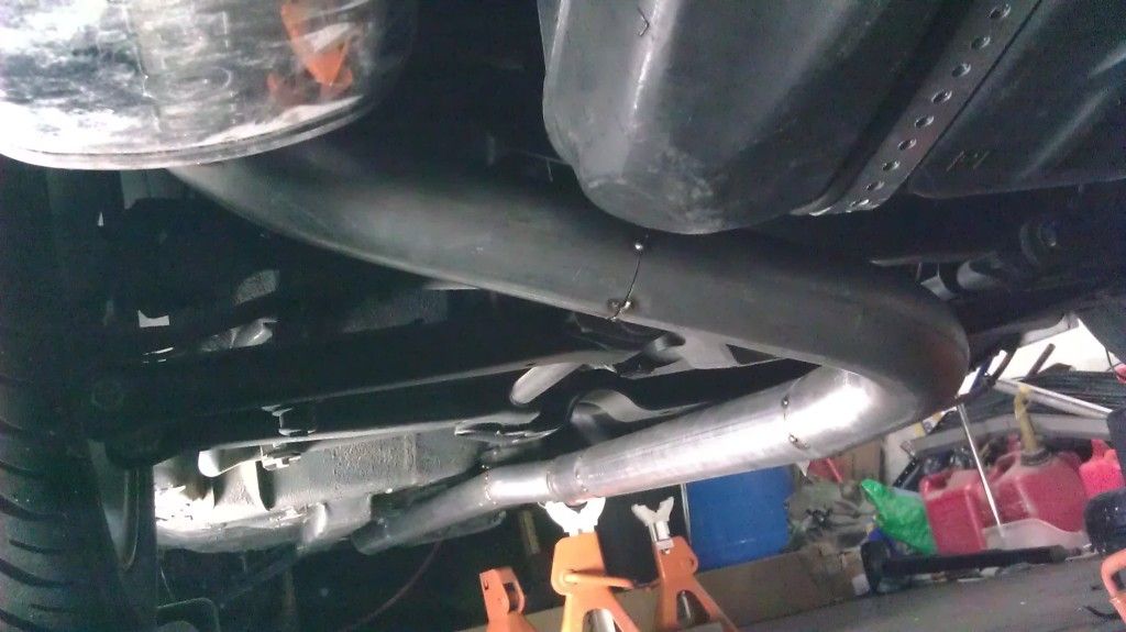

Exhaust bends came in today and got straight to work.

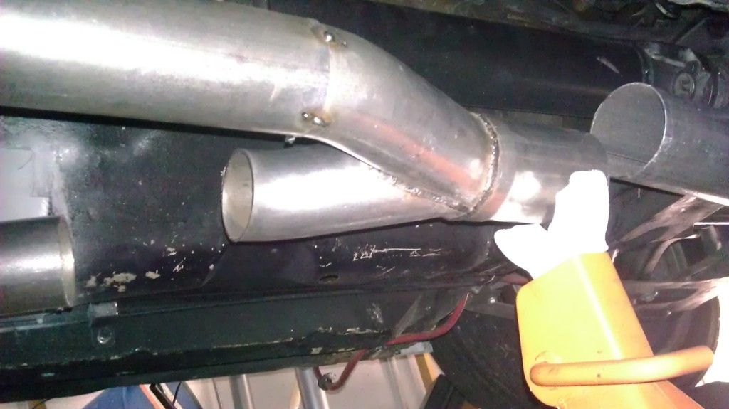

Started on the front section of the exhaust....
at the y-pipe... need to cut the passenger side pipe down a couple inches and then squeeze a bend in there to get it to the y-pipe.
I'll hopefully have everything up to the y-pipe finished tomorrow and then i'll finish out the back half.
Link to comment

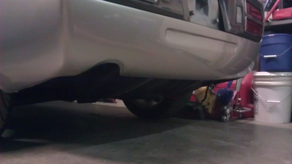

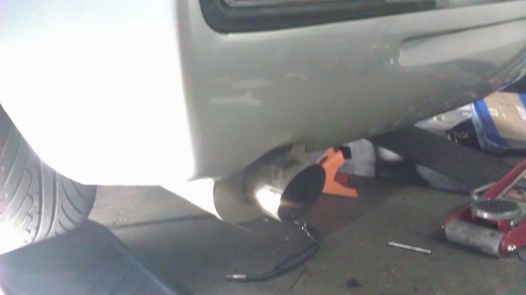

Front section finished.
Just need to pull it back down to finish welding the rear section in place...
The rear section is only tacked in place, so there are definitely leaks but here's a quick vid. Mind you its a bone stock ls1... not that exciting sounding..
