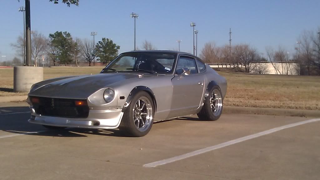

Got the car insured and registered on Friday.
Drove it up to Dallas Cars and Coffee this morning... still need to work out some small things but felt great to finally get this thing on the road.
Drove ~100 miles today and not a single issue other than the realization that I need to section my front struts and order shocks for all 4 corners.... it never ends.

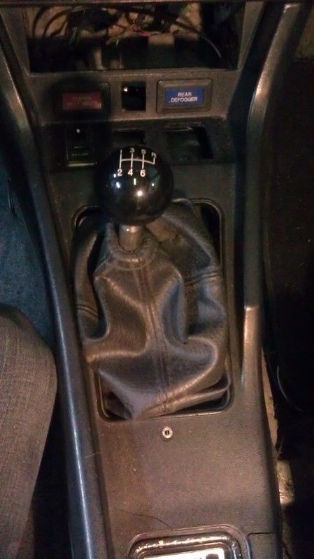

I installed the MGW shifter the other day. It is light years better than the garbage that was on there before.

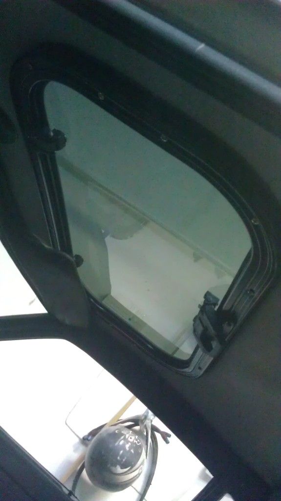

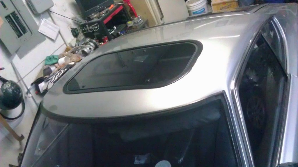

New sunroof installed. Ideally I wouldn't have any sunroof but as least this one doesn't leak.

May I ask, where you bought the sunroof from? I love the one in my car, but one of the forward piviots are broken forcing the sunroof to stay closed.
Thanks
I got the sunroof off amazon. It was a drop in perfect fit for the original dealer installed one. Mine measured 15" by 30"
CR Laurence AP1530B5H Autoport Sunroof
http://www.amazon.co...eywords=sunroof
Edited by 280zcar

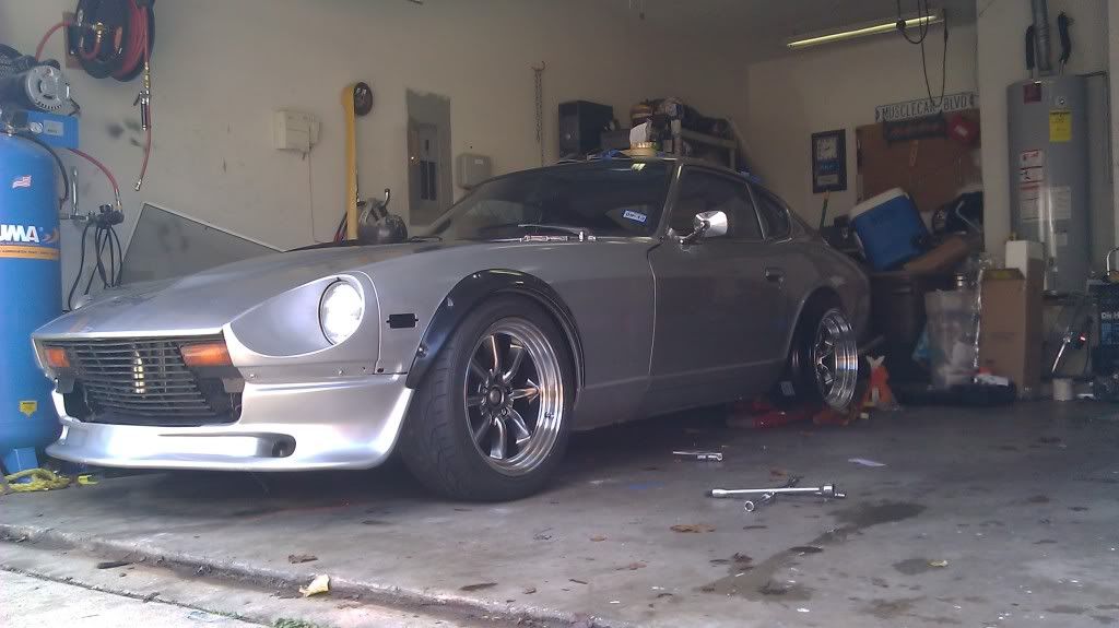

Front struts sectioned and MR2 tokico inserts done.
Current ride height with the 245/45/17 yokohomas moved up front (need replaced). clearance is tight....rubs on corners. going to either raise it up a bit or roll the fender (fender was previously rolled but this is the "new" replacement one)

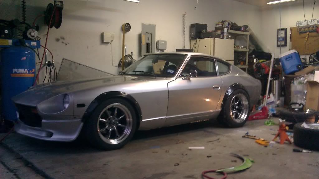

New tires in the rear, 255/40/17 dunlop direzza dz101 with room to spare. I can actually hook in second now.

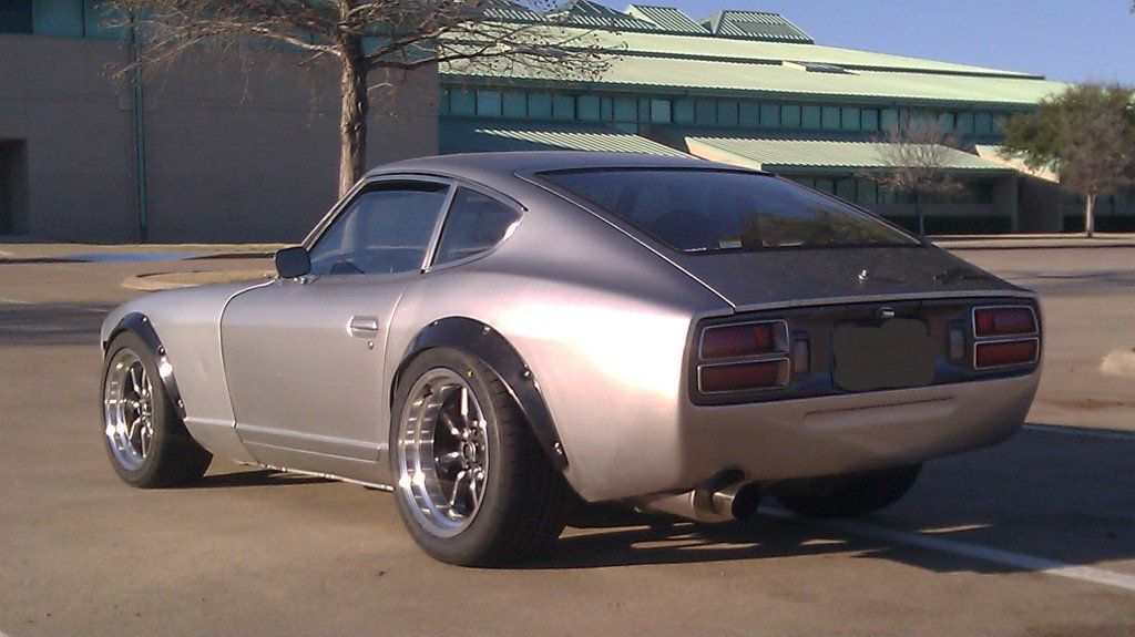

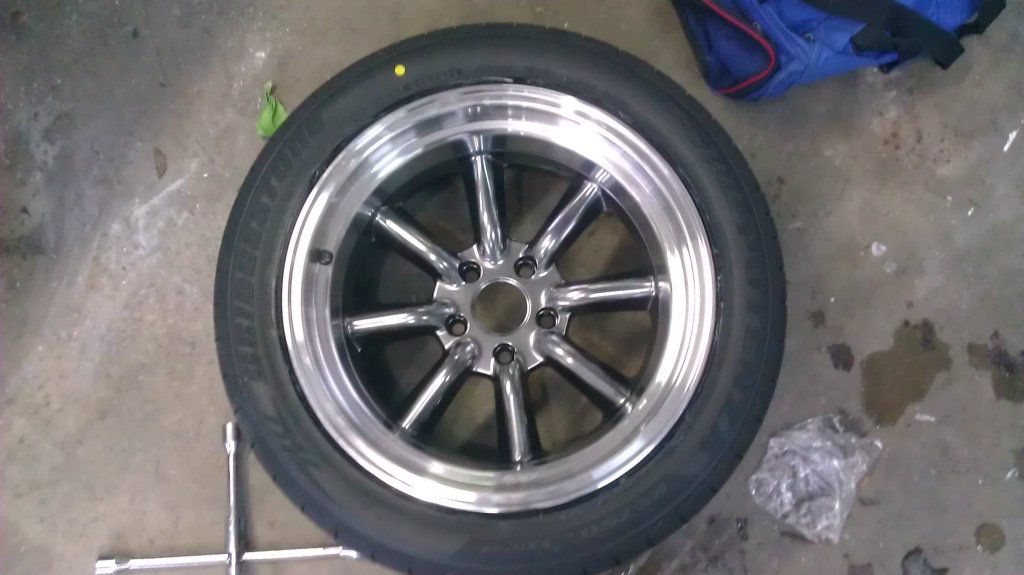

Wheels came in.... tires and fender cutting coming this weekend
Plan is to paint the flares the same color as the engine bay.
Rota RK-R
5 lug
Front- 17x8.5  0 offset
Rear- 17x9.5 -20 offset
Edited by 280zcar

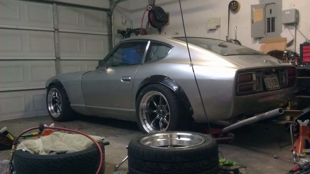

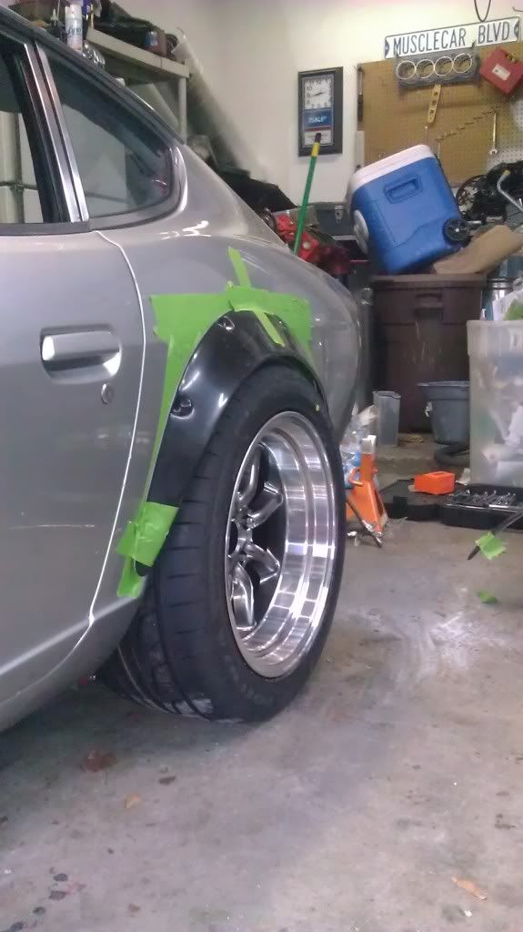

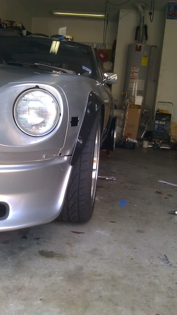

Front Tire mounted for mock up.... time to start cutting. this is the 255/40/17

That's a gorgeous color combo!  Sure looks sweet before cutting the body though...  Have you thought of doing the ZG's body color?
Either / or, it's going to be sharp!!
There is just no way these wheels and the tire widths i want would fit without cutting up the body and doing flares or i'd probably entertain that idea.
I've got paint left over from when I did the engine bay, so that is part of the reason for painting the flares that color. The entire car needs to be repainted, so I might look into matching the silver body color with the flares at that point. That's probably a year away from happening though... having too much fun with the car to put it in paint jail.
