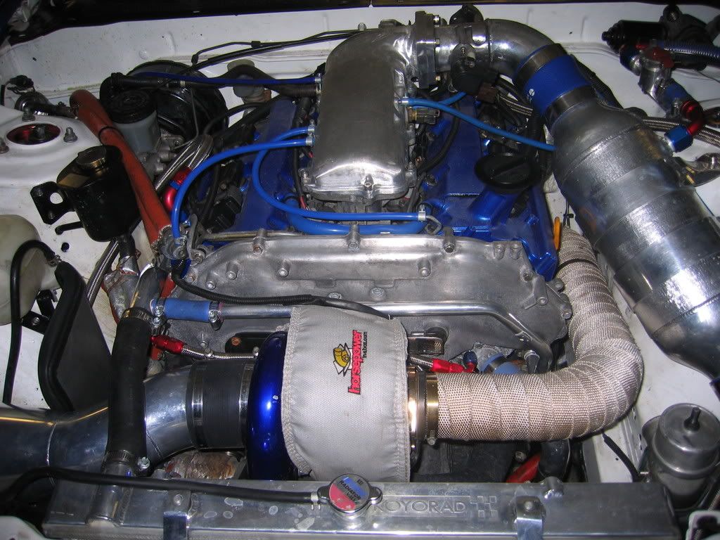

SwapMag1c Posted April 11, 2007 Author Share Posted April 11, 2007 well, i bought it for my S14 project that i was doing but it was WAY too much of a project. i bought this Z for a pretty good price and wanted to drop the VQ in there since it was turbo and the motor is less complicated and less miles.VG motor looks like a dinosoar complared to the VQ. the non turbo VQ30DE motors are known to withstand 500HP+ on stock injternals and that high compression, just thing of a block actually built for boost. also the the thought of a large single turbo (T67 Maybe?) VQ30DET Z sounds really good. Siluty has done a bang up job in his S14..... http://www.engineswaptech.com/forums/thread/1352.aspx how many twin turbo Z's do you see putting 340 rwhp @ 10 psi and 379 @12psi? Quote Link to comment Share on other sites More sharing options...

imported_z32 tt Posted May 17, 2008 Share Posted May 17, 2008 Hey mate i am looking at doing the same thing. In Perth, australia we have 2 drift cars and 1 drag car all pushing massive numbers on unopened engines. I was listning to the drift car below smashing the limiter the whole way around the track!! reliability is there i have seen it with my own eyes (not internet crud). This in a 180sx (240 in your country). www.vq30det.com Quote Link to comment Share on other sites More sharing options...
