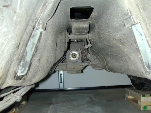

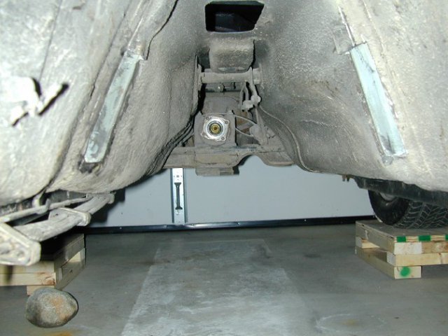

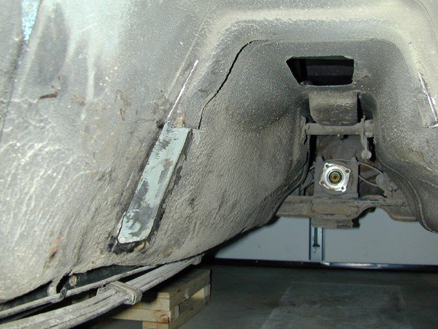

I haven't pulled the LT1/T56 out of the Firebird yet but have been prepping the engine bay on the 76 280Z so I can't do any test fitting yet.
I attached some pictures of what I removed from the tunnel so far and I would like to weld up some sheetmetal plates to where the tunnel ears used to be but I though I better ask first If I removed enough of the ears first? I would like to keep some of the existing bracing if possible for extra strength.

I used a hammer a little to make room for the back up light switch, but I couldn't tell exacly where it was going to be, so when we were putting the tranny in, I used a big pry bar with a rag wrapped around the sharp end to "dent" the tunnel. It bent quite easily and I got the dent just where it needed to be.

Thanks guys for the responses, I will go ahead and weld some sheetmetal to close the brace where it is open and fill in the ear openings or just seam fill the edges of the ear openings. M1Noel, thanks for the suggestion with a crow bar on clearincing the reverse light. I had my tunnel shaping stone shown in the 4th pic ready to bang away but I like your idea much better.:cool::icon14:
