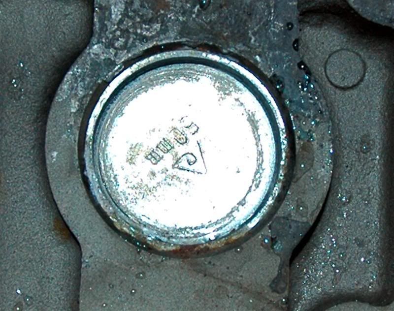

Administrators BRAAP Posted April 17, 2007 Administrators Share Posted April 17, 2007 I am pretty sure that info is correct, though not 100% sure. My literature says 35mm, 40mm and 50mm are used on the blocks and I just checked an L-24 and a F-54 L-28 block in the shop and they both have 35mm plugs in the sides, a 40mm in the front and a 50mm in the back. Nissan may have used a 47mm at some point in the blocks, but none of my literature nor the blocks I have on hand have a 47mm plug in them. Hope that helps. Here is the 50mm plug in the back of the block under the bell housing… Quote Link to comment Share on other sites More sharing options...
