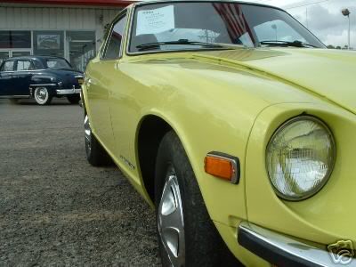

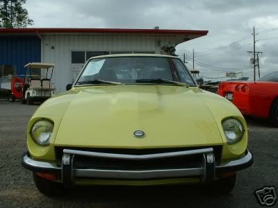

Flexicoker Posted May 2, 2007 Author Share Posted May 2, 2007 I only have these pics from the ebay ad when I bought it... It looks like its just scooted forwards a few inches the bumper guard guys are a little closer together. Those are coming off soon anyways. Switching to the earlier bumpers is Plan B, but I'd really like it to be as easy as switching out the brackets. Quote Link to comment Share on other sites More sharing options...
