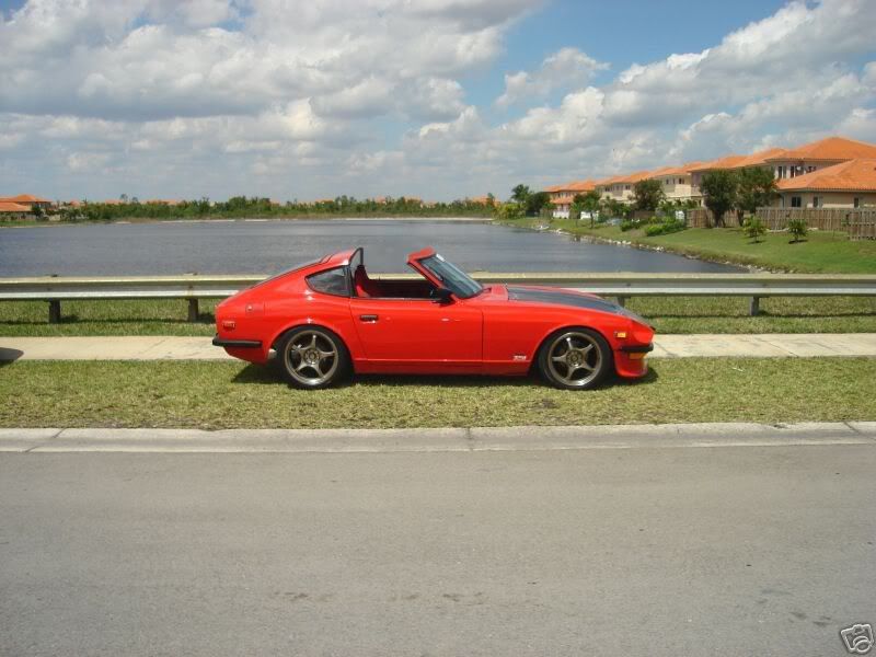

jknc90 Posted July 11, 2007 Share Posted July 11, 2007 Here's some photochops I just made. The first one is a little off in spots, but pretty close. Quote Link to comment Share on other sites More sharing options...
nitsuj Posted July 11, 2007 Author Share Posted July 11, 2007 I like that. A lot. If it could be done for a reasonable price, and I could sturdy up the chassis enough, I'd do it. If nothing else, I'll just send you pictures of my car and you can chop it off for me and I can pretend. Quote Link to comment Share on other sites More sharing options...
Cody 82 ZXT Posted July 12, 2007 Share Posted July 12, 2007 I really like the photoshop of the s30. Make me think about getting a s130 and doing that to it. Quote Link to comment Share on other sites More sharing options...
Challenger Posted July 12, 2007 Share Posted July 12, 2007 That second picture looks really good! I probably wouldnt weld the doors shut but you could put a bar from the middle of the door to the front of the rear part of the roof, for strength. Im not sure how much youd need to beef it up but if you look at the weight differences from a convertible and its hardtop sibling (same car) the weight difference is quite a bit. (alot of strengthening) Quote Link to comment Share on other sites More sharing options...
e_racer1999 Posted July 12, 2007 Share Posted July 12, 2007 second one reminds me too much of a porsche Quote Link to comment Share on other sites More sharing options...
V8_DatZun Posted July 12, 2007 Share Posted July 12, 2007 lol.. let me see a zx like that..... cuz who knows... that may be an option i go with..look at the concept picture in my sig... would look wicked if it was made kinda like the 2nd picture of the red car. Quote Link to comment Share on other sites More sharing options...
Kevin.pk Posted July 12, 2007 Share Posted July 12, 2007 Crappy ms paint chop but..... i thought it needed a chopped roof/windshield too... for a slow slung look i don't know how practical it would be for anyone over 6 foot though since you'd be looking out above the windshield probably Kevin Quote Link to comment Share on other sites More sharing options...
TravRMK Posted July 12, 2007 Share Posted July 12, 2007 That photoshop pic looks sweet! You could put a roll bar around the edge which ties into a rocker bar, and that should help the stiffness a good deal. Not sure if it would be enough though. Quote Link to comment Share on other sites More sharing options...
