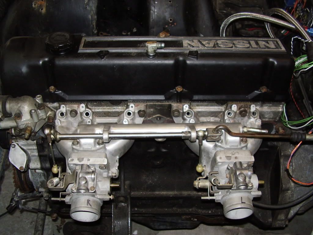

The twin TBs are really just for a different look on a twin turbo setup. This is what I am leaning towards. I'm going to start mocking things up. The biggest challenge will be the exhaust manifold.

Yes, I am using the balance tube. Once so that the TB don't need to be precisely calibrated, and it also provides a place to mount the throttle shaft stantions.
I have completed port matching the manifold to the head. I have also smoothed the inside of the manifold where the EFI manifold was grafted to the SU manifold. There were some bumps that needed to be smoothed out where the two manifolds were welded together.
The plan as of today is to use this manifold setup on a 3.1L NA sleeper. I will be retrofitting a stock 240Z air filter to attach to the TBs. It should make people do a double take. The car it is going into is a 71 which will be setup as a nice street modified Z. It will look mildly modified, but it have all the goodies underneath.

There will be a balance tube, and only one TB will have a TPS. So except for getting the two TBs butterflys set close, it should work like a single TB intake manifold.

The linkage is all stock Nissan, so there is very little play from TB to TB. Worst case would be 2 times the max play from a one TB stock Nissan setup. Slapping a TPS onto the side of one of the TB is a lot easier than rigging it up on the pedal (I just love getting under the dash in an S30). A 240SX TPS will bolt to the 280ZXT TB without any modifications.
I actually was looking closely at using a set of SUs to use just as TBs, but there is no place to easily mount a TPS. I'm wondering if on MSII you can use manifold vacuum change for throttle enrichment (I know other ECUs can do this). Or, I could mount the TPS under the dash. Mmmmm, thinkin' stealth mode again.... I'm liking this idea!
