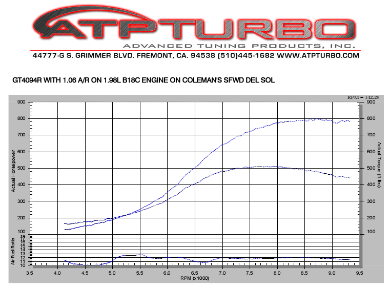

JustinOlson Posted August 24, 2007 Share Posted August 24, 2007 Here's that gt4094r dyno: http://www.atpturbo.com/root/releases/images/release100306/gt4094rdyno1.gif Quote Link to comment Share on other sites More sharing options...
