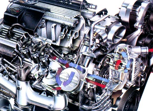

the LT1 uses REVERSE coolant flow, if you look closely youll notice the intake and heads on an LT1 DON,T have provisions for a t-stat and radiator hose connection, on an LT1 those are located on the water pump
while the heads swap either way, the engine can,t be made to run without extensive and fairly expensive mods.
aftermarket performance heads that fit an LT1/LT4 don,t generally give any real advantage and cost a good deal more than those aftermarket performance heads for the standard gen 1 block
youll also notice the distributor on the standard engine is missing, replaced by an opti-crap ignition driven by the timing cover/cam assembly on the LT1
theres nothing wrong with an LT1 that prevents you from getting good hp, but the sellection of parts is limited and sticking with MPFI in the LT1/LT4 vs swaping to a carb is USUALLY the best route, with the least problems
the only advantage I see is the basic engine config is lower in over all height (more hood clearance)and can be seated back slightly further in the frame/firewall clearance, and with LT4 heads and intake its got good hp potential compared to most STOCK 350s with STOCK heads, and its a factory roller cam equiped engine

the LT1 intake and heads are better than average stock sbc heads and intake BUT the LT4 components are noticable better still (compare)
http://www.malcams.com/legacy/misc/headflow.htm
the heads, intake and compression ratio on the LT4 are differant as well as other changes
