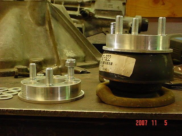

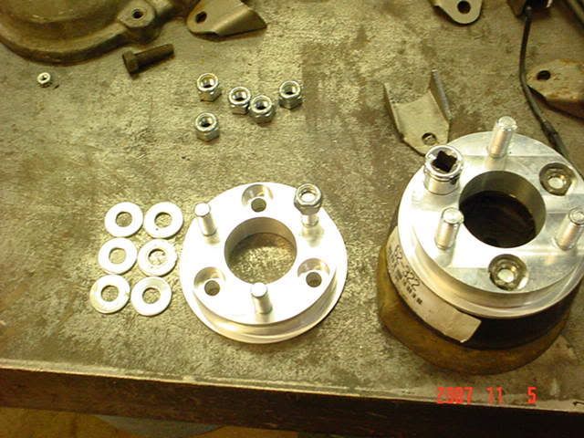

sweetride2go Posted November 13, 2007 Author Share Posted November 13, 2007 finaly went and got a photobucket accnt. here is the finished strut spacers... i needed to counterbore the isolator holes a bit deeper, you'll notice that only about 2/3 of the isolator nuts are holding the isolator in... it was a bit of a hindsight deal, but at the shop im working at i needed it back onthe ground that day, so some locktite and thats the way they went in... least till i ever get bak to the rear suspension cheers ryan~ Quote Link to comment Share on other sites More sharing options...
Pennyman Posted November 16, 2007 Share Posted November 16, 2007 Those are amazing. Looks like good craftsmanship. I don't think the isolators experience anything but compression when the cars on the ground and a little tension when it's on jackstands, so your units should work as long as they fit well. These look like the prefect solution to adding some ride hight to those cars which have maxed out the coilover sleeve and still want to go a little higher, or whose lowering springs make it difficult on around-town journeys. Quote Link to comment Share on other sites More sharing options...
sweetride2go Posted November 16, 2007 Author Share Posted November 16, 2007 ya, they came out better than i would hav hoped, to bad u cant see them after they hav been installed, lol... it was easier designing them than machining, luckly i hav a couple of friends in the buisness so i gave them my bluprints.. i was a lil concerned w/the OD of the spacer, but after trial fitting it, i had room to spare... the only catch to mabe others is that the minimum thickness would 3/4" due to the length of the isolator studs... of course, one could always shorten the isolator studs, but then there would be a marginal gain... these were done at 1", i figure i need at least that much to keep mytires from rubbing the flare... cheers Quote Link to comment Share on other sites More sharing options...

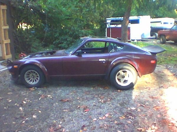

sweetride2go Posted December 2, 2007 Author Share Posted December 2, 2007 heres my Z w/ 295's on it, i had a lot of rubbin goin on... also an old pic, and obviously no strutspacers... heres a look of the gain w/ the strutspacer installed, of course this pic was of the new SS fuelline... tire size is now 265, and there is no rear end, no gas tank... and im running the red springs from Arizona Z Car that fit in the factory spring perches... Quote Link to comment Share on other sites More sharing options...
Strokin77 Posted December 15, 2007 Share Posted December 15, 2007 how is this going to affect your camber? Quote Link to comment Share on other sites More sharing options...
sweetride2go Posted February 27, 2008 Author Share Posted February 27, 2008 it seems to be marginal at best... that and the 280z isolater would be the same height as mine w/ the spacer ive been told.... Quote Link to comment Share on other sites More sharing options...
