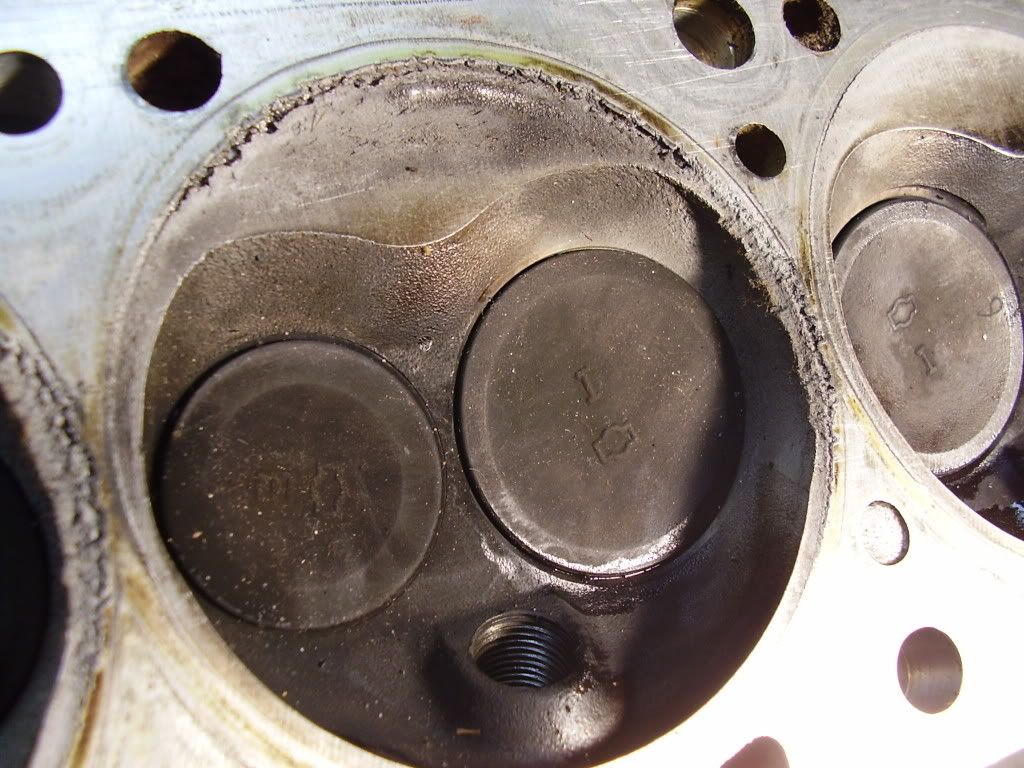

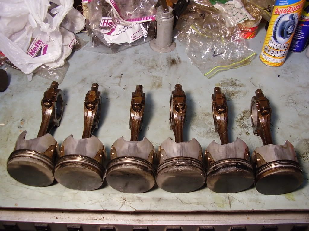

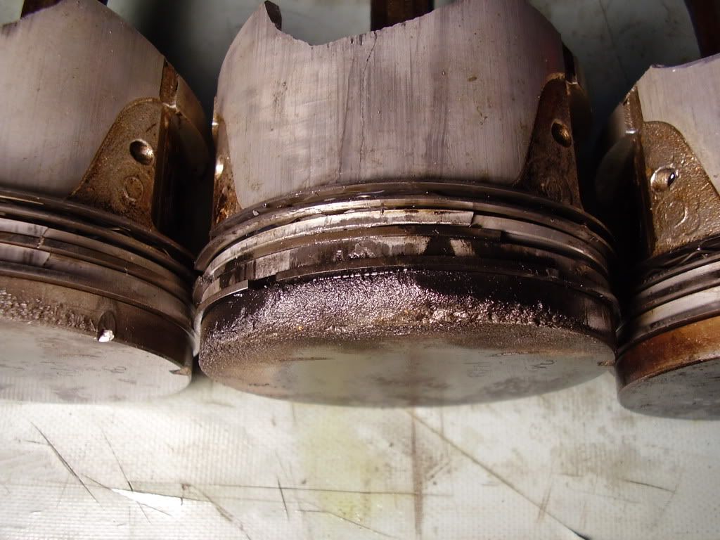

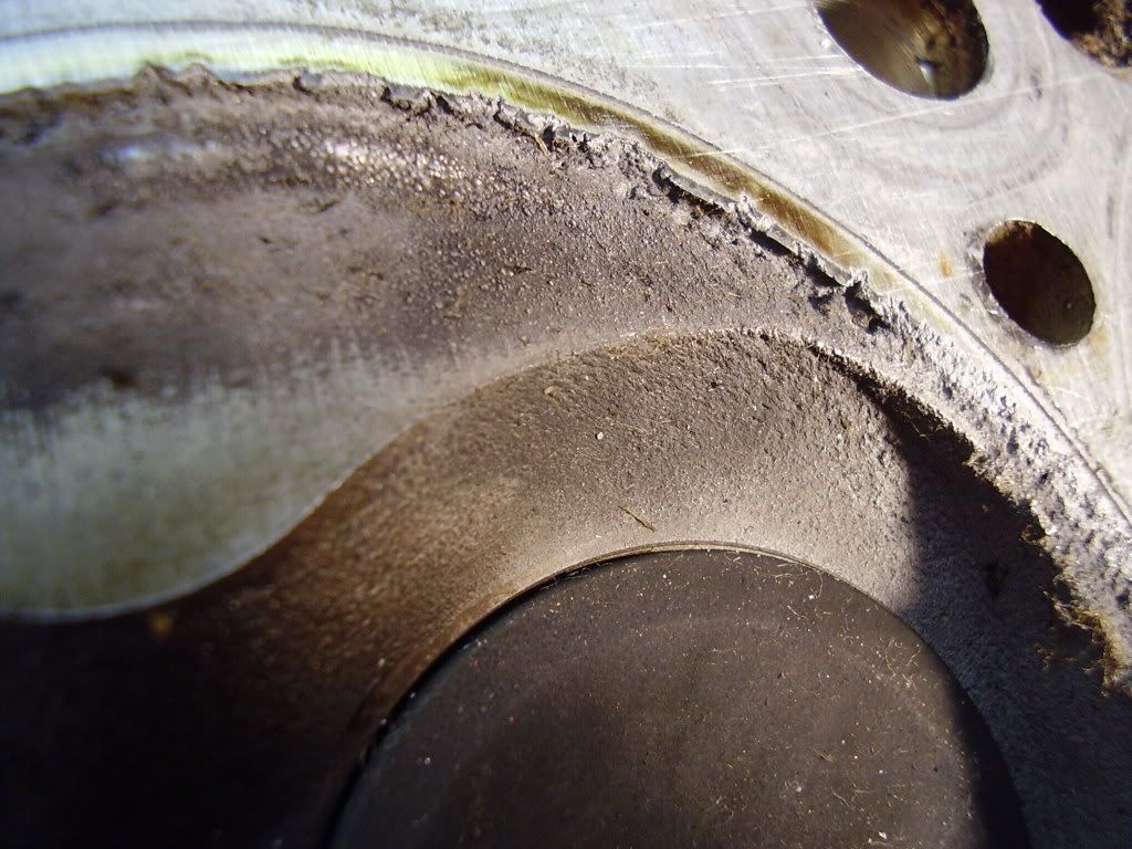

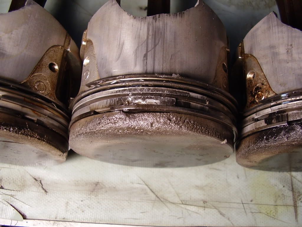

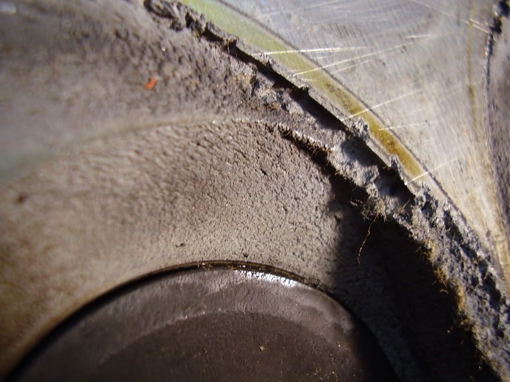

z-ya Posted December 2, 2007 Share Posted December 2, 2007 Finally had a chance to pull apart the SC motor that lost compression on 3 cylinders. Specs: - L28, std bore, stock P79 pistons - 2mm metal gasket - 8.1 CR - Camden supercharger 8psi boost - Dyno tuned to 11.5 to 12:1 AFR - Advance at 8psi ~20deg - 255 RWHP - Intake temps reached 280F on a regular basis during track sessions It held together for almost two time trial seasons. It failed on the way back to the pits after a session. Still was running, but on only three cylinders. The crank looks to be fine. So hear are the results: Piston 4: Piston 5: Pistons in order 1,2,3,4,5,6, Note all skirts broken on one side: Quote Link to comment Share on other sites More sharing options...
1 fast z Posted December 2, 2007 Share Posted December 2, 2007 Yea all on the pressure side of the piston is where the broke. HEAT is the only thing that would cause that much expansion. Heat from intake temps, detonation, pre-ignition, etc. I would DEFINITLY add an after cooler. Water injection would also help. Quote Link to comment Share on other sites More sharing options...
1 fast z Posted December 2, 2007 Share Posted December 2, 2007 After looking, if you had the pistons in corectly, they all broke on the NON pressure side of the piston. Quote Link to comment Share on other sites More sharing options...
z-ya Posted December 2, 2007 Author Share Posted December 2, 2007 Yes, the pistons we installed correctly. The damage is on the hot side (driver). Heat, detonation was the cause. Quote Link to comment Share on other sites More sharing options...

z-ya Posted December 2, 2007 Author Share Posted December 2, 2007 Holy smokes, that doesnt seem right. 8 psi and damage like that? it seems like the detonation would have sounded so bad you would have immediatly pulled into the pits. Have you ever hear a Camden SC at 6500+RPM? You can't hear much else. All you can hear is the SC coming up through the TB. We dyno tuned it conservatively. My guess is that on the dyno the intake air temps never came close to what they did on the track. So it was detonating, and we couldn't hear it over the SC. Those old Camden superchargers are great at making heat. Plus I was running it dry. Having a couple of injectors upstream of the impellers would have cooled it a bit. Not a good setup for a track car, especially if run dry. Quote Link to comment Share on other sites More sharing options...
