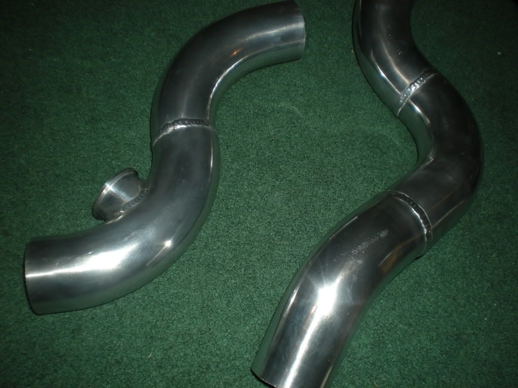

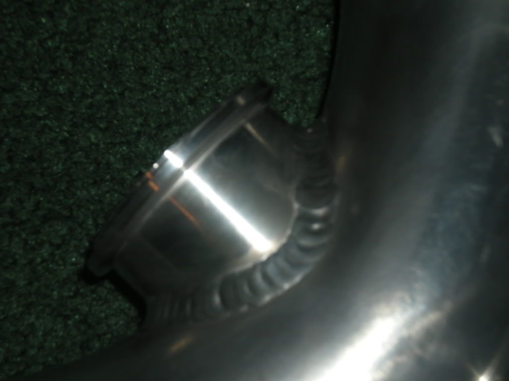

timbo1jz Posted March 6, 2009 Author Share Posted March 6, 2009 well guys, the rain this past month has killed me on progress. Anytime I get a day off, it rains . Anyways, I'm back on the project more than ever and I am ready to get this thing running very soon. I made my aluminum intercooler pipes finally and had a friend TIG weld them for me and they came out bitchin'. Damn I wish I could weld aluminum! Anyways, I used 2.75" piping, because I thought that 2.5" would be a bit too small and 3" would be a bit too big, so I found a happy medium. I also had him weld on a tial BOV flange for my tial 50mm BOV. Pipes will be on this weekend along with a custom intake, and I will paint/seal the interior, along with laying down the sound deadening mat. Here are some pics of the pipes- Quote Link to comment Share on other sites More sharing options...

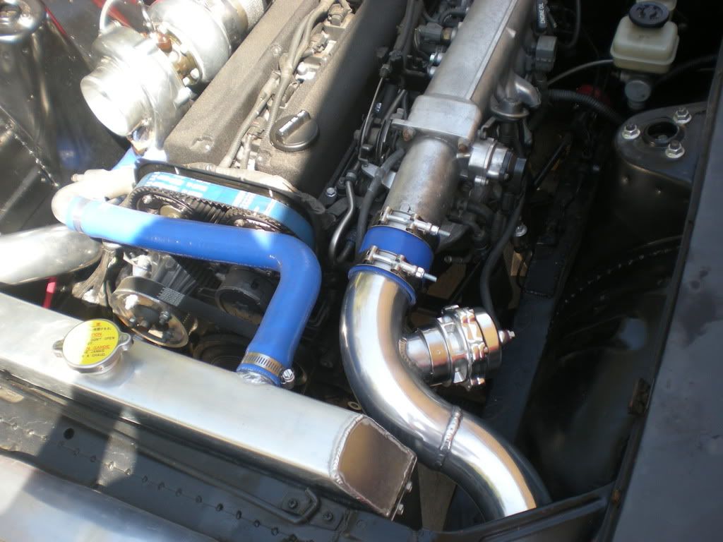

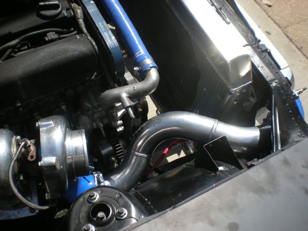

timbo1jz Posted March 8, 2009 Author Share Posted March 8, 2009 alright, pipes are on the car and everything fits perfect. Everything under the hood is officially ready to rock and roll. Here are a few pics- Quote Link to comment Share on other sites More sharing options...
Gritz Posted March 8, 2009 Share Posted March 8, 2009 Cool, i also got my brother to weld up my IC pipes today..Mine are alittle different than yours, my filter isn't as long as yours is, i got the one from advance.....Looks killer, keep up the good work.... Quote Link to comment Share on other sites More sharing options...
timbo1jz Posted March 9, 2009 Author Share Posted March 9, 2009 thanks gritz. The only thing that I am worried about in both of our setups is that running a filter directly on the turbo means that their is no room to have an intake tube with a fitting to suck out the crankcase vapors. We can't run a catch can, but I am thinking that venting the valve cover will be enough to release the pressure. Quote Link to comment Share on other sites More sharing options...
ShaggyZ Posted March 9, 2009 Share Posted March 9, 2009 thanks gritz. The only thing that I am worried about in both of our setups is that running a filter directly on the turbo means that their is no room to have an intake tube with a fitting to suck out the crankcase vapors. We can't run a catch can, but I am thinking that venting the valve cover will be enough to release the pressure. While not a real clean look, it would be easy enough to basically poke a hole in part of the filter and have a nipple sticking out of it. There are fittings out there that can poke out of the filter and have a nut that threads to seal it tight. Just have it poke out on the side of the filter facing the turbo; I'm of course not talking about the filter element (ie cloth/paper) but the plastic or rubber. Quote Link to comment Share on other sites More sharing options...
Gritz Posted March 9, 2009 Share Posted March 9, 2009 thanks gritz. The only thing that I am worried about in both of our setups is that running a filter directly on the turbo means that their is no room to have an intake tube with a fitting to suck out the crankcase vapors. We can't run a catch can, but I am thinking that venting the valve cover will be enough to release the pressure. Yep, your right...Ive seen people run the little auto zone filters...but i would much rather do it the right way...Once i get to a more comfortable spot with my build then I'll figure something out...unless you come up with something first.. Quote Link to comment Share on other sites More sharing options...
