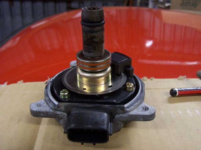

well after many headaches with the stock trigger wheel with my haltech e6k i'm replacing it with a z31 wheel. I saw on one web page which cas to look for and i had one from a z32 tt on my rb25. The z32 cas does work on the rb engines, the plug is different but all i did was break off the plug part on the sensor. The blades are wider on the z32 cas and it makes the plug stay on, i drove it with it this way for over 2k miles. Anyway i dug into it today and here is what i did for those interested in changing the wheel. I took the three screws out of the housing, in the z32 cas it has tamper proof screws. I used a flat blade screw driver and pushed down really hard to get them out, all came out no prob. After that the drive needs to be taken out it's pretty simple just use a punch and knock it out. The drive will slide off and give access to the bearing beneith. I broke off the half moon keyway on the end since i dont have to have it with the haltech and it would be next to impossible to get the bearing off with it on. I looked around for something to pull the bearing off since trying to use a vise is very harsh ;) . I found a beam clamp (used for hanging plumbing and conduit from metal I beams) and cut the bottom center out to go around the shaft and under the bearing. here is a pic
and one of it after pullin the bearing
to get the rest apart you have to take and drill the plastic plug in the opposite side of the cas like this( i used a 1/2 inch drill but a smaller one would look a little nicer)
then use a punch and knock out the shaft here is a pic of it disassembled

yea they are a lil blurred my cam doesn't take good close ups, i can get some more. I did end up getting the rb25 cas apart too that one sucks but it is possible to do it and swap the wheel. I'll get pics of that too and you know i have had a few ppl call me mcguyver lol. i am plannin on gettin the wheel prolly tomorrow or maybe even tonight, more pics to come
got more pics, and the modified cas works great!!! i got it to actually tune right and run like a dream, dispite the broken piston ;) Took it for a ride today and man does that thing haul butt. I had to modify the mounting tabs on the "stator" as i am calling it to move it farther from the stock location to accomodate the z31 wheel. The z31 wheel is bigger than both the z32 and rb trigger wheels so i had to make everything "fit" :) i had to use the main shaft from the z32 cas and the stator and housing from the rb. Kinda a frankenstein'd it but man it makes a huge difference.
