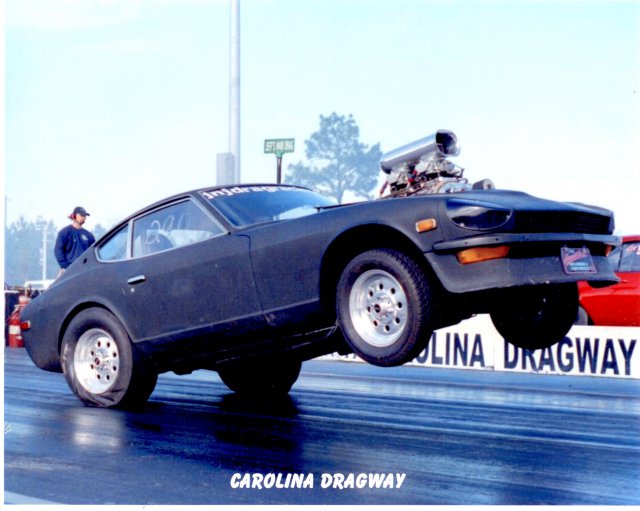

JustinOlson Posted January 25, 2008 Share Posted January 25, 2008 Did you open the fender well with a BFH? Justin Quote Link to comment Share on other sites More sharing options...
jnjdragracing Posted January 26, 2008 Author Share Posted January 26, 2008 Did you open the fender well with a BFH? Justin No, a zip wheel.we cut a pie shape out of the wheelwell and pushed the fender lip forward and migged it back in place. It took about 15 minutes to do.Jerry Quote Link to comment Share on other sites More sharing options...
HICKL Posted January 26, 2008 Share Posted January 26, 2008 We can keep the front end on the ground by tightening the limiters on the front end. The car is very consistent. On a normal pass the car picks the frontwheels up about 6" to 12" and is very consistent.Thanks Jerry For us ingorant folks, please explain the "tightening the limiters" statement. Thanks Jeff Quote Link to comment Share on other sites More sharing options...
jnjdragracing Posted January 26, 2008 Author Share Posted January 26, 2008 For us ingorant folks, please explain the "tightening the limiters" statement. Thanks Jeff Jeff, we use limiters on the front end to limit the travel of the upward motion. The travel was set at 3" that day,when we ran at PINKS ALL OUT we cut the travel in half to 1.5" this keeps the front end down and only picks the tires up 6" to 8" or less . Jerry Quote Link to comment Share on other sites More sharing options...
