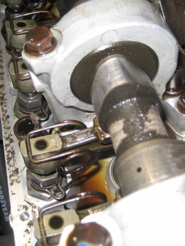

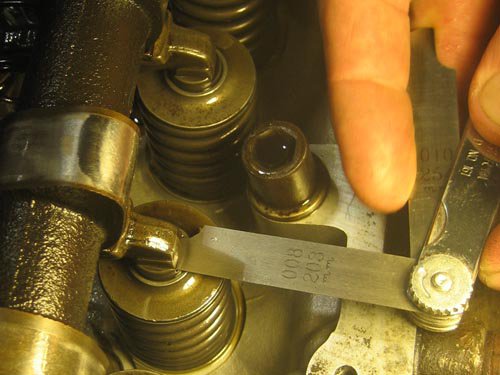

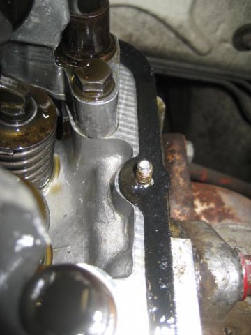

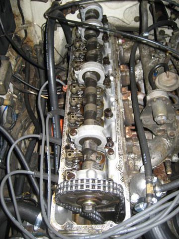

TrumpetRhapsody Posted March 31, 2008 Author Share Posted March 31, 2008 Well I didn't get around any bodywork this weekend, but I did get to drive it on the blacktop. I got all the valves adjusted like they're supposed to be (I think?). One of the cam lobes is pretty worn pretty for some reason... not sure what that's all about. I'm about 60% sure I got my coolant leak around the thermocouple stopped. And then there's the drive. Probably was a mistake after all this rain, I got mud EVERYWHERE. It sucked with no fenders, mud just everywhere. Oh well, it was fun and I got a video. A couple of problems though: I need to check my tranny and diff fluid. I felt alot of vibration though the shifter, and when decelerating there was this friction noise, didn't sound normal. Further investigation is necessary... Also I'm getting some misfiring when the engine is under a load. Heavy accelleration, especially around 3500rpm (never was able to get much higher), caused the car to buck and misfire. I think these carbs are going to need a rebuild if I expect to use them on the road. Quote Link to comment Share on other sites More sharing options...

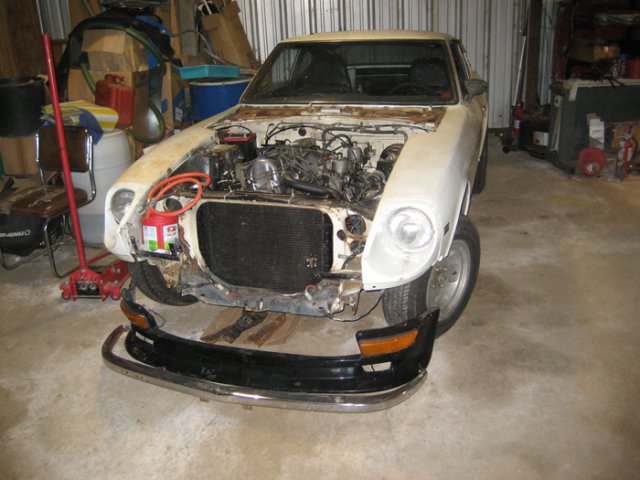

TrumpetRhapsody Posted April 15, 2008 Author Share Posted April 15, 2008 Another weekend of work concluded. I didn't get as much done as I wanted, nowhere close, but I did get some important stuff done. Some ups and downs though... Like I mentioned before, I adjusted the back carb's float and cleaned up the needle valve. Now it no longer spews fuel out the overflows. The carbs still drip fuel out the throats after you turn the car off and there's pressure in the lines, but all I have to do is turn the pump off before the car and let it relieve the pressure. Good enough for now. Instead of starting body work I tore into the electronics, and figured out that I have a short in some of the wiring. Finding it will be difficult, fixing it is probably going to be nearly impossible, I'm not looking forward to it. Today we also got my exhaust welded up. The 2.5" pipe was cut for a turbo manifold, so I had to cut it shorter for the headers and weld up the flange. It took my dad and me about 5 hours to finally get it right. Unfortunately, in the process of bolting the headers back on I broke a stud and stripped out a bolt. Joy, more work for later. I didn't get to hear it run b/c of that. I still need to get the 3" adapter for the muffler and get them welded on too. Quote Link to comment Share on other sites More sharing options...
