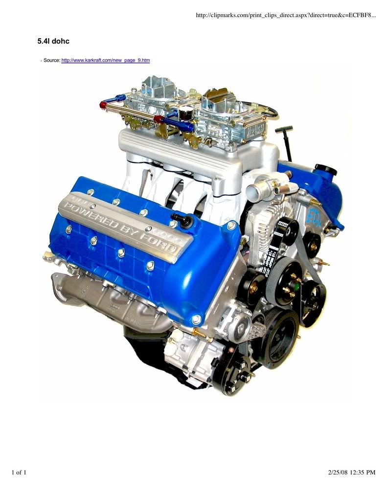

IdfMF Posted February 25, 2008 Share Posted February 25, 2008 For the cost of developing the cam drive and all the machine work, you could go this route: It can be yours for $6395.95 turnkey from Kar Kraft: http://www.karkraft.com/new_page_9.htm Quote Link to comment Share on other sites More sharing options...
rudypoochris Posted February 25, 2008 Author Share Posted February 25, 2008 Yes, I could. I don't want to though. Thanks for the suggestion, that is a nice engine. Quote Link to comment Share on other sites More sharing options...
