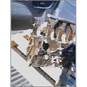

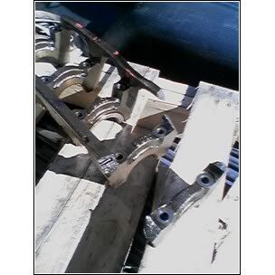

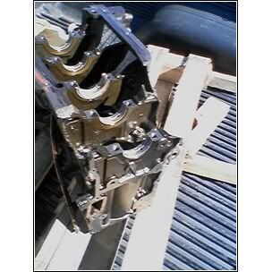

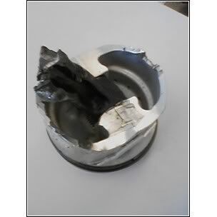

mannyvig Posted February 12, 2008 Share Posted February 12, 2008 A guy from work here has a 98 240sx with a KA-T and Unreal suspension. It is a time attack car. He built it with CP pistons, Cometic hg, ARP everything, custom top mount manifold, GT30r and the full AEM EMS system. At 18-20lbs of boost it put down about 430 but was kept at 14lbs dyno tuned at 356hp at the wheels on a mustang dyno. I have driven this car and can attest to the fact that it is stupid fast even on the low boost. However, after much abuse the rods apparantly weakend. He was giving me a ride to an appointment I had and cruising at about 2800 rpm it died nothing loud though. We tore it apart and found the no.1 rod snapped and ripped through the girdle and block. This weekend we put the new motor together with the new Carillo rods and new CP pistons. This time it has a ported head though . It should be wicked fast for another 8 months before it breaks again. were gonna finish it up this weekend and have fun all next week. Quote Link to comment Share on other sites More sharing options...

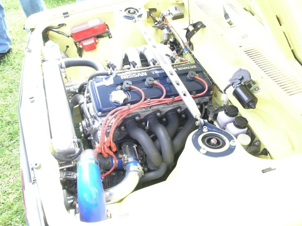

Administrators RTz Posted February 14, 2008 Administrators Share Posted February 14, 2008 I've often thought a KA-t would be just about the ideal powerplant for a 510. There's a local chap that's done just that... and then some. Its one of the most impressive 510's I've witnessed... . . . . 4-link rear suspension... Quote Link to comment Share on other sites More sharing options...
mannyvig Posted February 15, 2008 Share Posted February 15, 2008 That exhaust manifold is impressive:eek2: Quote Link to comment Share on other sites More sharing options...
Administrators BRAAP Posted February 15, 2008 Administrators Share Posted February 15, 2008 That ENTIRE car is impressive, including the exhaust manifold... Quote Link to comment Share on other sites More sharing options...
G.I.jonas Posted February 15, 2008 Share Posted February 15, 2008 However, after much abuse the rods apparantly weakend. He was giving me a ride to an appointment I had and cruising at about 2800 rpm it died nothing loud though. We tore it apart and found the no.1 rod snapped and ripped through the girdle and block. The rod snapped and blew a hole in the block after shattering the girdle,but it wasnt loud...impressive! Is the engine made of lead? Quote Link to comment Share on other sites More sharing options...
mannyvig Posted February 15, 2008 Share Posted February 15, 2008 I kid you not. The exhaust is extremely loud but it didn't sound too abnormal. Quote Link to comment Share on other sites More sharing options...
