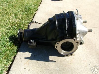

I recently purchased a 72 240Z V8 transplant, and am trying to identify the rear end. I was looking over the diff list above; but I'm not seeing identifying traits. Can you tell me what came stock ? (through VIN # or visual inspection) Thanks guys!

Maybe I can clarify a bit. I bought my Z car from a guy who bought it from a guy; who bought it from a guy ........... The end result is that I don't have any of the "transplant" info. I dunno if he (the transformer) upgraded the diff when he injected 370 HP in the car. (I would sure think so) But; is there a way to tell by visualization if I'm gonna need to be purchasing a beefed up r200; or if it already has one ? I'm planning on reading as much of the tech articles as is posted; but for now; I'd just like to b e able to plan my budget. Now before you tell me to go out and do a burnout to see if it has limited slip; I should tell you that it's surrounded in a car tent by 2 feet of snow on all sides. Might be a little squirrely
Maybe you can tell us what it is not? Short nose, long nose, heat sink in back, pics...... There is a ton of info on the rear ends in these cars in that search button. Not only will you find yours, you will probly have more of an idea on what you want.

Here's a few pics. The car is sitting on gravel; and I couldn't get a jack under it; so all I could do is stick my camera under the car with my arm outstretched. :wink:

The only thing I can tell from those pics are that its a R180 diff....
Thanks man! Thats exactly what I needed to know. Now I'll start searching for an R200 out of a Q45.
