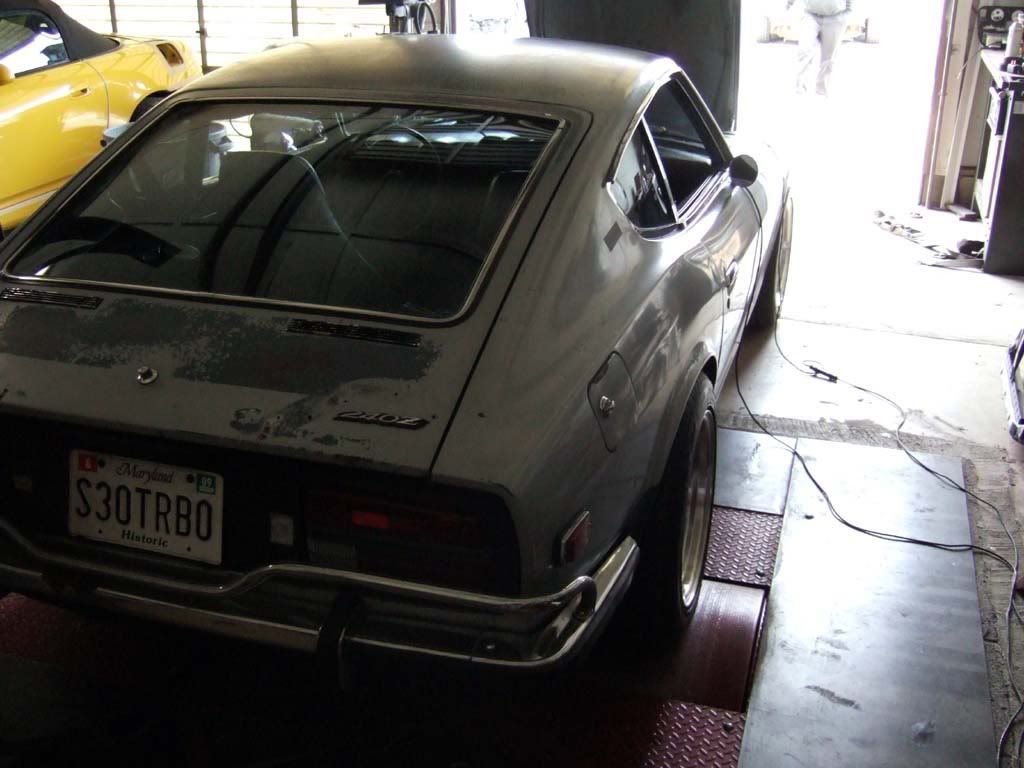

S30TRBO Posted April 3, 2008 Share Posted April 3, 2008 (edited) Well before taking the SU off after the break in I decided to dyno the Z in a progression stage. Next my ITB are going on, plumbed for EFI and will dyno again. Finally after my traveling for work is done this spring/summer the plenum intake is going on with the turbo. I pulled 4 times here is the break down. • 1st run 3rd gear, stock timing, yielded 140.68rwhp 164.69 ft.lb torque. • 2nd run 4th gear, timing advanced half way, yielded 158.41rwhp 168.81 ft.lb torque. • 3rd run 4th gear, timing advanced all the way (per the plate), yielded 161.59rwhp 174.50 ft.lb torque. • 4th run 4th gear, timing advanced all the way (per the plate), stock air box cover and filter removed yielded 166.78rwhp 166.95 ft.lb torque. How are my numbers? Motor Specs: • L28ET F54/P90 Bored .60 over • Ross Pistons • Pauter Rods • HKS 2mm head gasket. • Entire rotating assembly balanced • Isky Cam: Lift 490 intake, Lift 480 exhaust 290 intake duration, 280 exhaust duration, 1/14 lobe center. Isky Springs, retainers and lash pads. • Ferrera Stainless steel Valves • Nissan Rockers • MSA 6-2 Header • 2.5” Exhaust with Magnaflow muffler • 260 Intake Manifold • Z Therapy SU w/ SM Needles • Early ZX single ear 5-speed transmission rebuilt • OS Giken Twin Plate Clutch • R30 Skyline R200 3.9 Comments other than it falling on its face on the top end? It did it on the first 2 runs and I told Joe not to go over 6500rpm and when it stumbled he did let off. I know I could have taken the distributor plate off and gotten more timing out of it but there was no timing light there to make sure. I didn’t feel comfortable yet in pushing the envelope. Thanks to Joe and the guys at Tempest Racing with the Dynojet 248!! Edited June 21, 2009 by BRAAP Quote Link to comment Share on other sites More sharing options...
