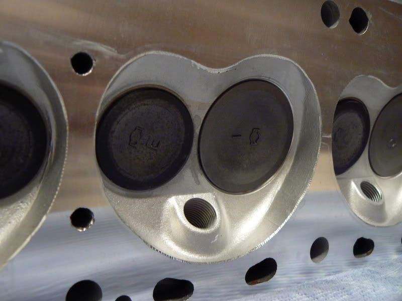

Zmanco Posted August 17, 2008 Share Posted August 17, 2008 Six_Shooter said: I'll have to look for some pictures to see the differences, I'm not visualizing this lemon shapped combustion chamber. From a P90 head (same chamber as P79)... Quote Link to comment Share on other sites More sharing options...
Six_Shooter Posted August 17, 2008 Share Posted August 17, 2008 Zmanco said: From a P90 head (same chamber as P79)... I call that a "heartshaped" combustion chamber, it's the Chevy guy in me. That shape has been found to work well, for efficiancy, power and resisting detonation, more specifically pre-ignition.. With the swirl created by the shape it is found that the air/fuel mixture stays in suspension longer than a cylinder that has less swirl. Quote Link to comment Share on other sites More sharing options...

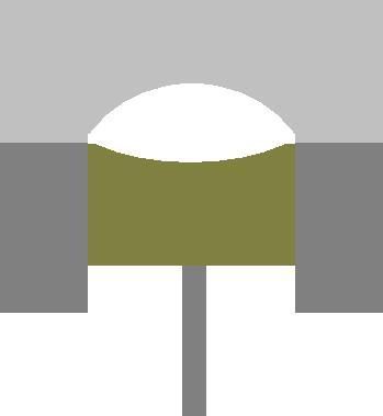

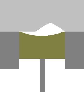

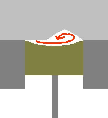

X64v Posted August 18, 2008 Author Share Posted August 18, 2008 I meant looking at it from the side, like so: E88 with P90 pistons: Kinda looks like a lemon. P79 with P90 pistons: No longer as open, but there is definitely no quench there. That ring you talk about running around the outside of the piston that's at full height isn't enough to do much, and plus with a stock head gasket (.049" thick) it's out of quench range anyway (from what I read, it must be <.040"). Quote Link to comment Share on other sites More sharing options...
Six_Shooter Posted August 18, 2008 Share Posted August 18, 2008 Quench does have a lot to do with the raised area at the outside of the piston, that's why it's there. That's where you will measure that "0.040" quench" with a dished piston, heck even with a flat top, since the combustion chambers in the heads are almost always a dome shape or some variation of, like your two paint pictures there. Even dome pistons wouldn't come that close to the head nearer the center of the piston, or more specifically in the area of the valves, since most engine builders with cut the pistons to have at least 0.100" clearance between the valves and piston through it's cycle, both as the piston comes up to TDC and as it moves away from TDC. Quote Link to comment Share on other sites More sharing options...
X64v Posted August 18, 2008 Author Share Posted August 18, 2008 Six_Shooter said: Quench does have a lot to do with the raised area at the outside of the piston, that's why it's there. That's where you will measure that "0.040" quench" with a dished piston Yes, that is where I'm measuring. It's .049" (the edge of the piston comes even with the block, .000" deck height, and then the gasket is .049" thick). Plus, even if it were within quench range, that amount of quench is inconsequential compared to a piston actually set up for quench (a flat top with the dish cut out exactly under the combustion chamber to achieve the desired SCR). There is absolutely zero quench with the P79 head/P90 pistons, unless you use a thinner gasket, in which case the quench is still very minimal. Quote Link to comment Share on other sites More sharing options...
Six_Shooter Posted August 18, 2008 Share Posted August 18, 2008 X64v said: Yes, that is where I'm measuring. It's .049" (the edge of the piston comes even with the block, .000" deck height, and then the gasket is .049" thick). Plus, even if it were within quench range, that amount of quench is inconsequential compared to a piston actually set up for quench (a flat top with the dish cut out exactly under the combustion chamber to achieve the desired SCR). There is absolutely zero quench with the P79 head/P90 pistons. Listen I'm not going to argue with you about this, I have been building engines for many years, quench is a term that describes how close the piston comes to the head, being it 0.020" or 0.090" or any measurement of proximity of piston to head at TDC, in your case you have 0.049" quench, if indeed your gasket is 0.049" compressed thickness, and your piston come to zero deck and not proud. Quote Link to comment Share on other sites More sharing options...
X64v Posted August 18, 2008 Author Share Posted August 18, 2008 Alright, if that's your definition of quench, then what I mean is the quench area is negligible. Quote Link to comment Share on other sites More sharing options...

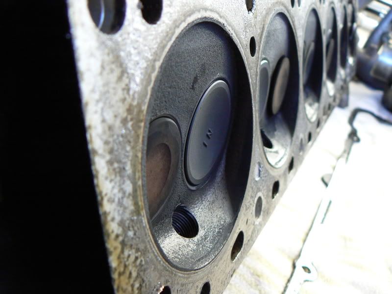

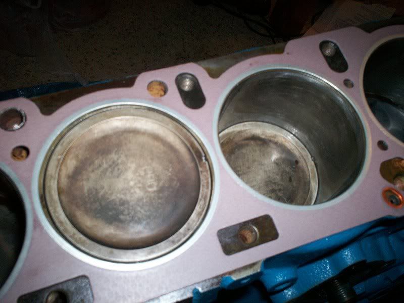

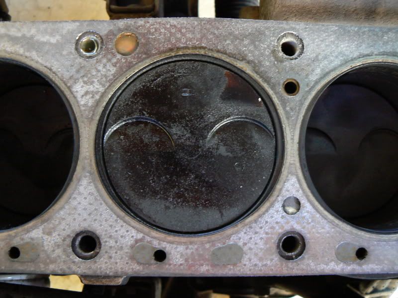

Daeron Posted August 18, 2008 Share Posted August 18, 2008 All important semantic points, and a GREAT anecdotal thread.... For posterity's sake, is there any chance you could snap a photo of the combustion chamber on the E88 head you were using, and also possibly get a photo of the old piston vs new piston up here? This thread is VERY close to an ideal tool demonstrating something that can happen when parts get mis-matched, in a marginal case. In other words, it is a good illustration of an "outside chance." The "common wisdom" here is pretty much that the combination you put together may work, or may not.. so regardless of all that, the more photo examples of what was being used here, the more useful this thread is in the future. I am certainly bookmarking this to refer back to later. Quote Link to comment Share on other sites More sharing options...
X64v Posted August 19, 2008 Author Share Posted August 19, 2008 Daeron, that is a good idea indeed, and I happen to already have all the pictures necessary. To recap: I used a 1973 E88 (One year only, the 'submodel' is N33, it's got 240z valves but a large 47.8cc chamber) with unknown 83mm flat-top pistons (small valve reliefs no where close to where they should be) that popped out of the deck .030" to give a static compression ratio of 8.9:1 on my L24. I ran this set up for a few months at 7psi and 24* of ignition timing with no detonation. I feel that that was a reasonable amount of timing, and so in my opinion this head/bore/piston combo 'worked'. This was unintercooled, with bp6es plugs, a 160* thermostat, and 110*+ ambient temps. The E88: The unknown 83mm flat-top pistons: I then rebuilt a stock l28et bottom end. Standard rod and crank journal sizes, stock 86mm bore, stock P90 turbo pistons. I re-used the E88 pictured above, giving me an SCR of 7.9:1. This is the set-up I had problems with, which is why this thread was created in the first place. After all my fiddling, I was able to run no more than 23* of timing at 7psi, and even then it was pinging residually. I feel that I should have been able to run much more ignition timing, so in my opinion this head/bore/piston combo did not work. This was unintercooled, with bpr7es plugs, a 160* thermostat, and 80* ambient temps. Same head, but these 86mm stock turbo P90 dished pistons: As a last ditch effort (and as a bit of an upgrade), I made some small modifications to a P79 (which can be seen in my "members' projects" thread), then had it rebuilt at a machine shop. Using this on the dished pistons shown above, I have an SCR of 7.35:1 (stock l28et ratio), and am able to run 29* of timing at 7psi. I'm currently running at 12psi with 24* of timing with no detectable detonation whatsoever (had the head off for an unrelated reason, and the fire rings were perfectly round). I feel that this is plenty of timing, and so in my opinion this head/bore/piston combo works (as did Nissan). This is unintercooled, with bpr7es plugs, a 160* thermostat, and 100* ambient temps. The P79 chamber: I guess the point here is that the E88 liked the flattop pistons, but would not work with the dished pistons for reasons unbeknownst to me. The P79, with negligible quench area gain (IMHO), likes the dished pistons just fine. Anything I missed? Quote Link to comment Share on other sites More sharing options...
Daeron Posted August 19, 2008 Share Posted August 19, 2008 Quite the contrary, that is EXACTLY what I had in mind, most excellent!! I especially love the photo of the "late E88" head, and the juxtaposition of the two combustion chambers is perfect to compare the two. I would suggest posting the E88 photo to the L6 heads and descriptions page; I have been halfway thinking about going through that thread, and my own collection of head photos, and assembling one single "master" post that has descriptions, sources, and photos of every head yet posted. "One of these days" at the very least, I want to do that as much for my own abundance of knowledge as for the value of it for the forum. I think it is worth pointing out a few things.. you mentioned that the quench area seemed somewhat negligible, but from my understanding alot of the function of the quench area is to essentially squish a certain space to push the mixture in towards the flame kernel as it expands. The thinking is to provide a pad where a flat top piston pushes nearly everything out of one section, and that movement inside the dynamically combusting chamber assists proper ignition and helps prevent detonation. Poor explanation, but what I am grasping at is that "quench" is a very subtle thing, caused by nearly totally squeezing a section of the piston face dry against the firing deck of the head. In actuality, the stock turbo pistons, with their dish, pretty much by definition kill the quench effect of this head (almost?) entirely. TRUE utilization of quench pads only occurs with well matched flat top pistons that nearly impact the head at TDC, and if a relief is needed for compression then the piston relief mirrors the CC in the head as much as possible. So, overall, what I am saying is that a small quench pad is still a quench pad... IF you are using flat tops, which a stock 280ZXT engine does not. I cannot say why this combination works as well as it does, but I am speaking about "quench theory" if you will. Quote Link to comment Share on other sites More sharing options...
