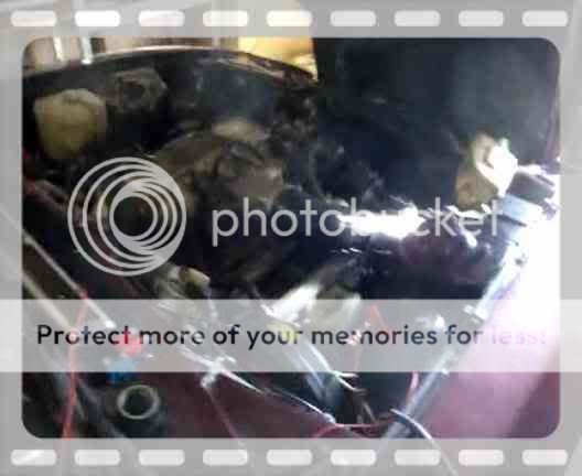

Marc280 Posted May 25, 2010 Author Share Posted May 25, 2010 Ok so I'd promised I'd take a video of the car on start up and here it is. You can hear that is is running pretty rough as it first gets going and this is because the injectors were blocked for a while. When I first tried cranking it, it didn't want to fire into life. I had spark at the spark plugs and fuel pressure at the rail, so I thought it must have been my wiring changes that I had made causing the problem. After a couple of nights going over the wiring and finding nothing wrong, I found the injectors were not clicking. A couple of other guy on Lextreme had problems with their injectors sticking closed after the engine sat for a while. Sure enough this was my problem too... So after sitting there tapping the injector to ground for about 10mins in each injector they eventually freed themselves. I should probably take them out and have them cleaned properly, but I'm going to concentrate on other things first. Right now I am building the rest of the exhaust which is a little tricky as I've gotta fit the two cats in there and I don't want them hanging down under the chassis rails... I've also found an AP racing master cylinder that looks like it has solved my clutch issues. So I just need to get these sorted and a tailshaft and then it should actually be able to move under it's own power! Anyway for now enjoy the video! Quote Link to comment Share on other sites More sharing options...
