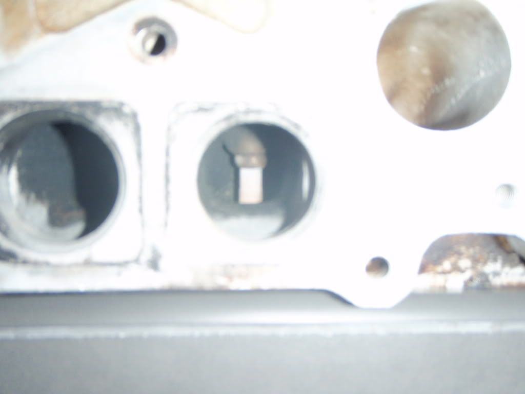

To day I picked up a n42 head with a rebuild tag on it . This head clearly reads n42 but has round exhust ports and the port walls are square .Has any one ever come across one of these heads? what is it from ? I took some pics but I am having trouble down loading them , so pics will have to wait till my wife comes home.

Never seen a round exhaust port N42. I'm a little suspicious that someone has reworked them for some reason and attempted to make them round but it's hard to really tell. Post some better pictures please so we can all have a better look.

By the way, there's no way these came from the factory like this. The only time the L series exhaust ports were round were for the liners, and neither of these have liners. It just looks like someone welded them up and cut them circularly.
That head = dead meat.
Anyway Veritech-Z had an N42 that had the same treatment to the exhaust ports.

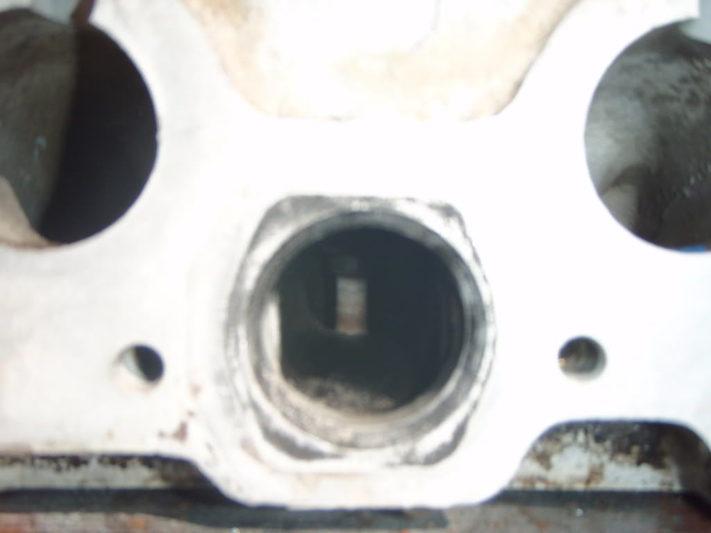

I know this head is crap but i had to have it to find out what it was or what has been done to it and why? Here are some more pics as clear as I can get with my point and shoot . In the last pic you can see a hanger that has been welded on .
