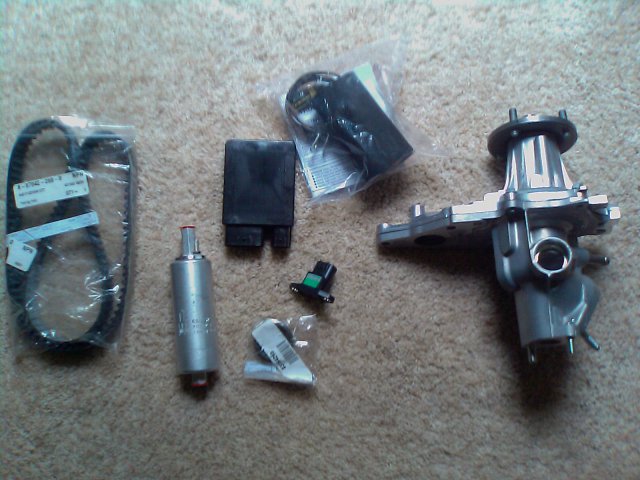

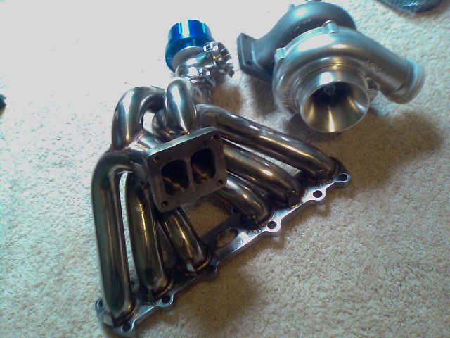

Gritz Posted September 28, 2008 Author Share Posted September 28, 2008 So far I'm done prepping the engine bay to receive the engine, the custom cross member is welded in and the engine bay is ready...I know, i know slow progress..my brother does all the welding for me and i rarely have two days off in a row, so it hard to get things done..money is a factor also.. Anyway i hope to set the engine in for good next week, i had to order a clutch from auto zone($40). next year or so I'll do a full stage 3 clutch system, for now i just want to get it running...I just ordered my intercooler off ebay 31X12X3 along with 2.5in IC piping...should be plenty for 400-500whp for now here are some pics of some goodies...more later!! Quote Link to comment Share on other sites More sharing options...
RayG1988 Posted September 28, 2008 Share Posted September 28, 2008 Looks good man, can't wait to see the final product. Quote Link to comment Share on other sites More sharing options...
