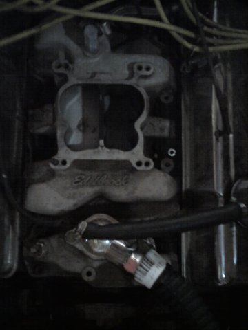

All right, since I'm really not sure what I've got (and haven't looked up the stamps yet... I'll get to that tonight) I'm just going to throw up some pictures, and maybe you knowledgeable folks can help me out a bit. Please bear with my inexperience, I'm doing my best to pick up all the info you guys are throwing out, and think I'm doing a decent job at it but I just wanted to see what else I can get out of you for advice.
Here's the intake manifold. I'm not sure how to differentiate the RPM from the standard Performer (or whatever other models there were). It definitely says Edelbrock Performer on it, though.
