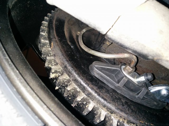

w3wilkes Posted November 3, 2017 Share Posted November 3, 2017 I know I'm almost 10 years late to this party, but just FYI... I used the later wheel cylinders for the 73 - 76 z on my 71 240. http://www.thezstore.com/page/TZS/PROD/classic21a09/24-5102A The MSA price on the old early Z style cylinders was almost $200 ea., the 73 to 76 style was less than $40 ea. Just had to change the bend from the old angle to the new 90 degree in the brake line on the baking plate which wasn't a big deal; Quote Link to comment Share on other sites More sharing options...
